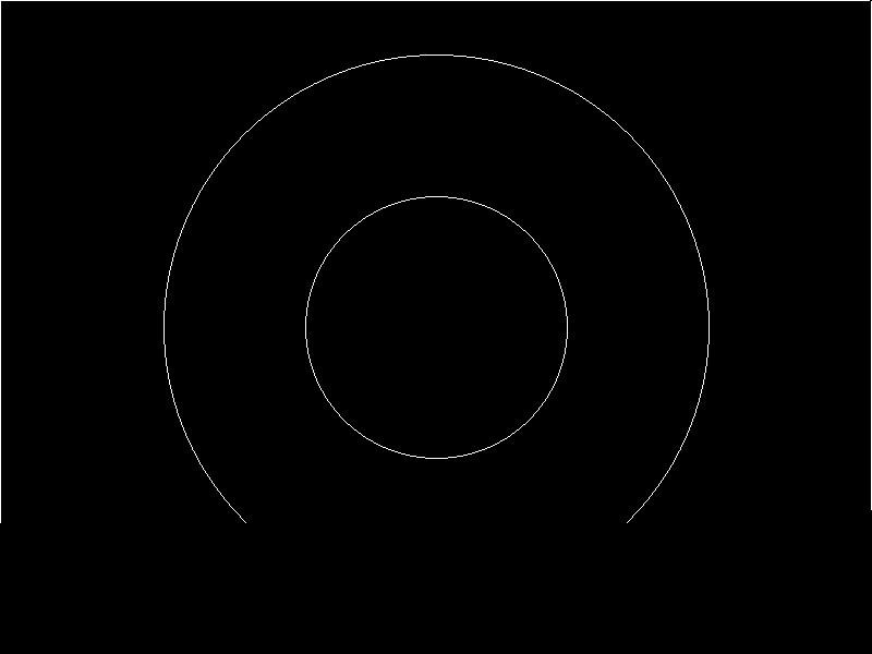

Posts: 3417
Posted: 11:21am 15 Mar 2025
VGA 2350 800x600 anyone else missing the bottom of the screen?
> cpu restart
> BOX 0,0,MM.HRES,MM.VRES
> circle MM.HRES/2, MM.VRES/2, 120
> circle MM.HRES/2, MM.VRES/2, 250
> option list
PicoMiteVGA MMBasic RP2350A Edition V6.00.02RC3
OPTION SYSTEM I2C GP14,GP15
OPTION FLASH SIZE 4194304
OPTION COLOURCODE ON
OPTION KEYBOARD US
OPTION CPUSPEED (KHz) 360000
OPTION RESOLUTION 800x600
OPTION DISPLAY 55, 128
OPTION SDCARD GP13, GP10, GP11, GP12
OPTION RTC AUTO ENABLE
Edit
No problem with OPTION RESOLUTION 848 or OPTION RESOLUTION 640
Edited 2025-03-15 21:32 by phil99
Posts: 12060
Posted: 11:34am 15 Mar 2025
  Quote  VGA 2350 800x600 anyone else missing the bottom of the screen?
Thanks - will fix
Fixed if you re-download. You will need to reset the resolution to 800 for the fix to fully take effect
Edited 2025-03-15 21:59 by matherp
