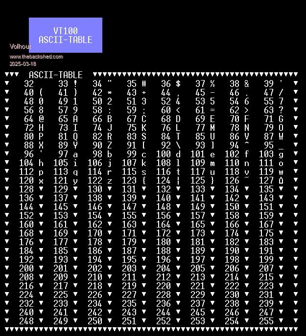

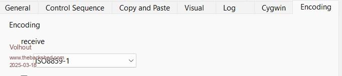

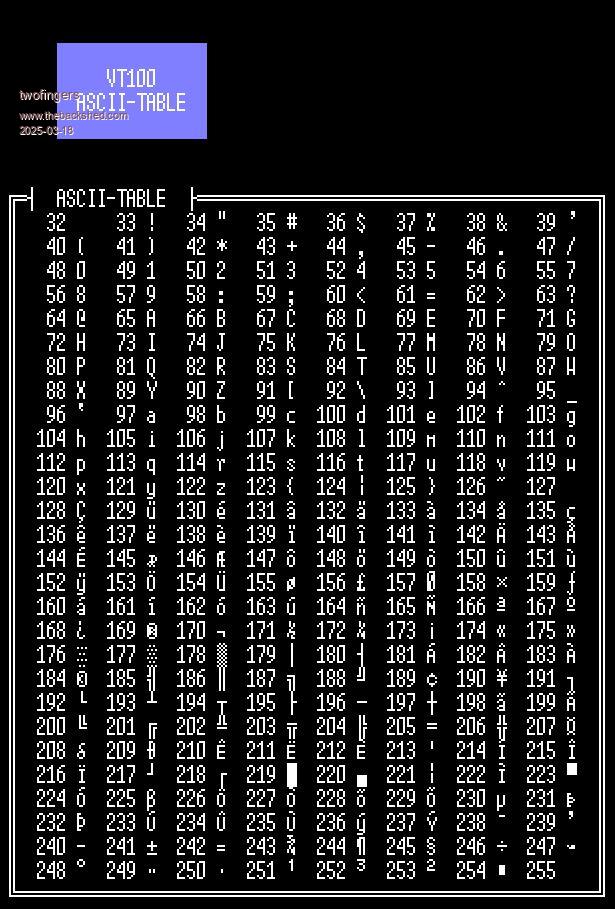

  Volhout said  ... Installed Teraterm 5.4.0, and it does not show correct characters above 127 using Terminal font. CP852 is not selectable. So I will stay with the old one. ...
This is my ASCII table in Teraterm, with Terminal font.
The lone and ...
Posts: 6100
Posted: 12:48pm 18 Mar 2025
Teraterm 5.4.0
Terminal font
ASCII table...
After you change "encoding" from UTF-8 to ISO8859-1 all is dandy....
Edited 2025-03-18 22:51 by Volhout
twofingers
Joined: 02/06/2014
Posts: 1769
Posted: 12:53pm 18 Mar 2025
Thanks Harm, very interesting!
