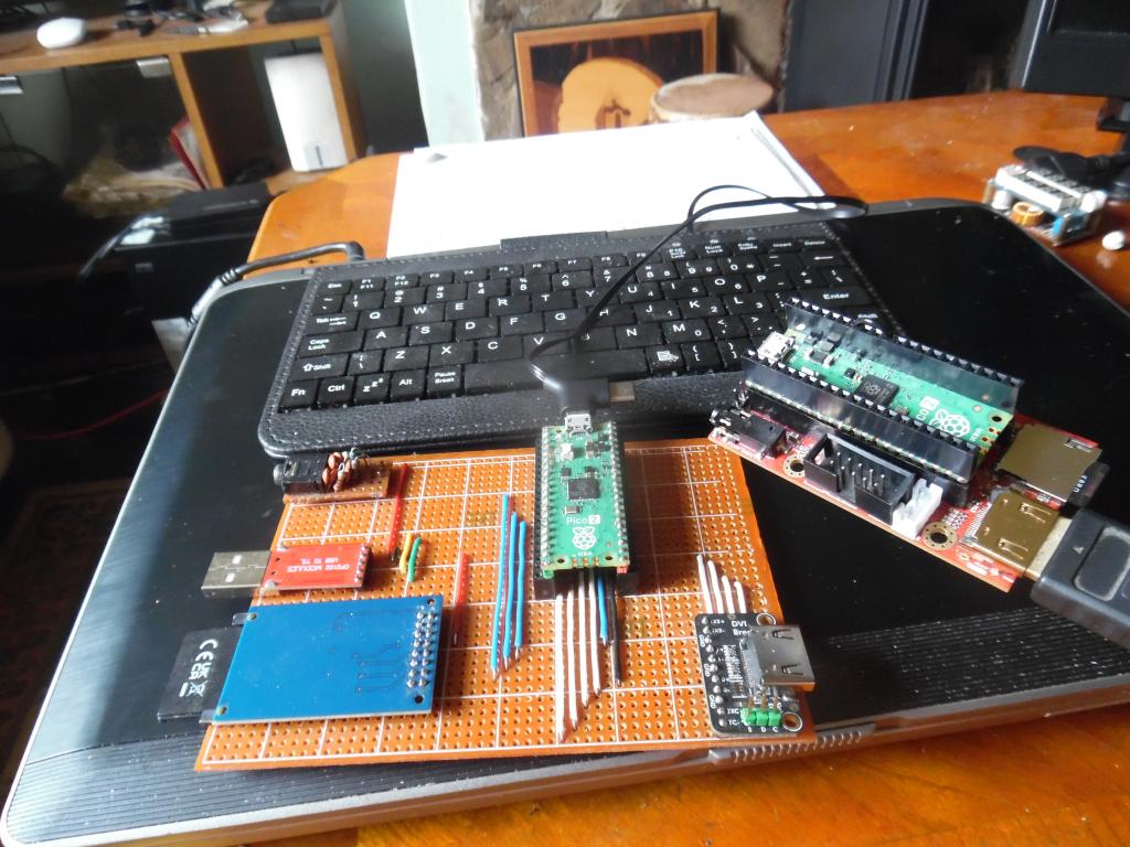

Posts: 2807
Posted: 02:04pm 26 May 2025
I started this post cos I found an olimex with 2350 with some waveshare devices that were the rage at the time on the forum and bought them but never used.,, stick to own vga and hdmi  cos they work with defaults setup in the manual.
Soldering is not easy as you get older, I got a cataract in one eye, surface mount and a hot air gun I haven't tried though youtube makes it look easy
The olimex wasn't made for mmbasic or the 2350 but it can be a quick way of using them just like an arduino uno and great cow basic but that didn't have vga only lcd but easier than soldering a pic board.
I respect the kindness of the folk on the forum willing to share and help make their pcb designs for others.
@dddns... it's up to you... how much you will use rpi pico... and mmbasic
get olimex with problems but does work... or solder a board... or a solderless bread board. my vero board could be smaller if redesigned and smaller sd card reader and usb to ttl converter.
the olimex I used headers with long pins so I can plug in molex wires if I want to add hardware.

Posts: 8965
Posted: 06:25pm 26 May 2025
The following pins are unusable:
GP28
The following pins are connected to unsupported pins on the HDMI socket:
GP10 (I2C1A SDA_33) - goes to DVI I2C1A SDA_5 via level shifter
GP11 (I2C1A SCL_33) - goes to DVI I2C1A SCL_5 via level shifter
GP26 (DVI_CEC) - gets linked to GP28 to get stereo audio
I thought they'd used other pins of the SD card, but they haven't on this board.
Goodness knows why they fitted U3 at all. It appears to do nothing, although that may not have been the intention. They may just have screwed up on something. Might just be the circuit diagram that's wrong.

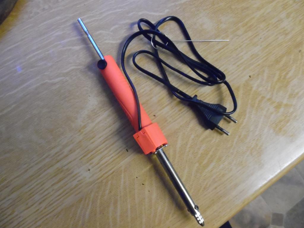

Posts: 2807
Posted: 07:58pm 27 May 2025
I bought a desolder pump which worked but then an email it was faulty. too cheap to bother, rewire to uk wiring?
Posts: 8965
Posted: 09:43pm 27 May 2025
With no earth you don't know what's going on inside. If the mains-metalwork insulation breaks down it could, in some circumstances, kill you. The Chinese don't bother too much about such things. They sometime run an earth wire but don't bother connecting it. Sometimes the earth "wire" is only a piece of plastic with no conductor. I can only suggest that, if you are going to use 2-wire Chinese stuff, that you feed it via a sensitive RCD that will trip if there's an electrical fault. You can get some that plug into your mains socket and have a Test button on them. Fuse the plug at something as low as you can get, probably 3A.
Probably 99 times out of a hundred things will be fine. It's that 100th time that's the problem. It can be a "once in a lifetime" event. :(
This stuff generally doesn't comply with UK regs. Here all exposed metalwork has to be earthed unless the item is classed as "double insulated" and carries the appropriate marking.
