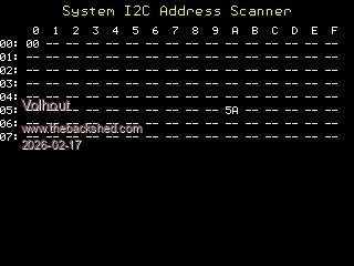

Posts: 6195
Posted: 11:24am 17 Feb 2026
For those of you who want to use the Game*Mite expansion connector to connect to external hardware (extra IO pins, thermal camera, sensors) the I2C bus can be used.
Below is a version of the I2C bus scanner, to detect connected devices, for I2C bus on GP16/GP17.
'GM I2C scanner for port GP16/GP17
' data buffer
dim d%(3)
' Open channel
SetPin gp16,gp17,I2C
I2C open 100,100
' draw GM screen
cls
text 160,10,"System I2C Address Scanner",CM,,,rgb(yellow)
font 7
text 0,24,"     0  1  2  3  4  5  6  7  8  9  A  B  C  D  E  F"
' loop col/row
For y=0 To 7
a$=Hex$(y,2)+": "
For x=0 To 15
 addr = y*16+x               ' calc address
 I2C write addr, 0, 1, &H00  ' write zero to that adress (could corrupt)
 'I2C read addr, 0, 2, d%()  ' read data from address
 If MM.I2C=0 Then            ' check for errors
   a$=a$+Hex$(addr,2)+" "    ' found one!
 Else
  a$=a$+"-- "                ' nothing here..
 EndIf
Next x
text 0,36+y*12,a$
Next y
END
Nothing fancy, just a tool.
Edited 2026-02-17 21:30 by Volhout

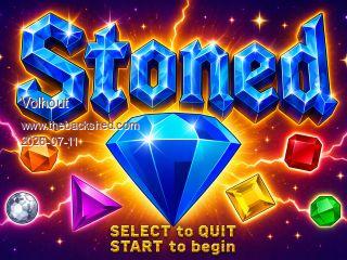

Posts: 6195
Posted: 07:24pm 10 Jul 2026
Stoned
A new game for Game*Mite only. See previous post how to get it.
This is a port of the merge game "bejeweled". You have to bring together 3 or more identical stones in a row or column.
You move around using the D-pad. A selects a stone to move. B provides a hint (there are only 10 allowed).
SELECT brings up the menu, START starts the game.
You have 5 minutes to get the highest score and beat my 2900... Note point per stone are progressive. A row of 5 scores far more than 2 rows of 3.
Happy gaming
P.S. this game has no animations, it put's everything graphics directly on the LCD, so the game could be developed in high color depth. It looks great.
P.P.S. all graphic elements where developed in higher resolution, and scaled down. So it is possible to make a version that uses high colordepth on HDMI, and higher resolution. But for that to happen, I first need an HDMI setup.
Edited 2026-07-11 05:54 by Volhout
