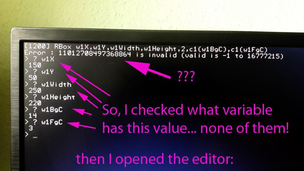

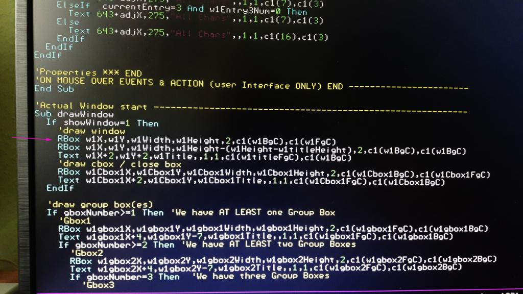

My observations: I am going in the chained program, all fine, I am going back to the main, all fine, there is no re-declaration of the variables and therefore no error, all fine,
BUT then (in the main program) suddenly:
Is this a CHAIN problem? I did all kind of variable checking with debugging PRINT statements. If I comment the whole line out, the problem occurs on the next line.. and so on.
It is always this kind of ERROR but  (if commented out) another huge number.
Have you any suggestions? I attached the exact two files:
gui_editor1.zip

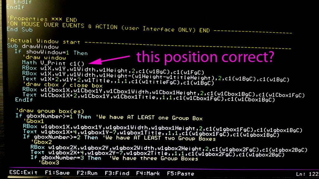

What do you get if you use MATH V_PRINT c1() before the RBOX?
Is c1 float or integer? does it make a difference?
OPTIONS: are you using 848 or 800? If you are please try replicating using 640, 1024, or 1280
Edited 2025-07-11 23:19 by matherp
Amnesie
Joined: 30/06/2020
Posts: 763
Posted: 01:40pm 11 Jul 2025
Hi Peter, thanks for you help!
c1() is integer:
I tested it with Math V_Print @ this postition, is it correct?

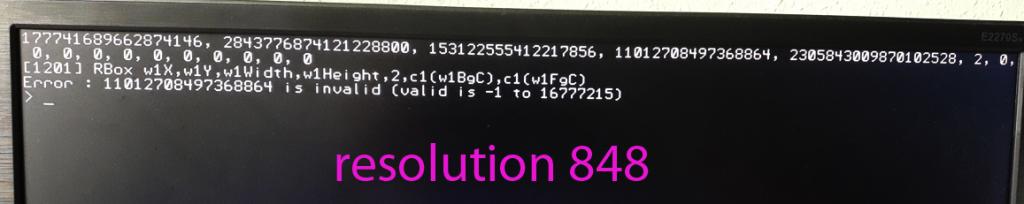

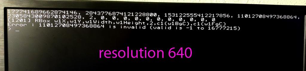

This gives me in resolution 848:
And in resolution 640:
I really hope that you have a clue what the problem could be. As said, in general chaining works, but not with my program, even though I implemented it exactly like your (and my) working test example... Hm. Problem is, I don't have an idea what this Error even means.

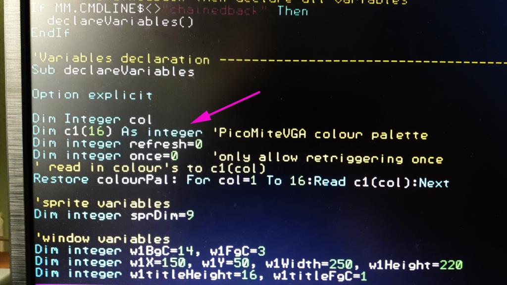

EDIT: By staring at it, I think I have an idea what all this means. You've made me printing the array before the error occurs and this is showing huge numbers. I don't understand why the last of the 16 numbers are "0"... They are representing the colour palette, which is :
' read in colour's to c1(col)
Restore colourPal: For col=1 To 16:Read c1(col):Next
and:
colourPal:
Data RGB(black),RGB(blue),RGB(myrtle),RGB(cobalt)
Data RGB(midgreen),RGB(cerulean),RGB(green),RGB(cyan)
Data RGB(red),RGB(magenta),RGB(rust),RGB(fuchsia)
Data RGB(brown),RGB(lilac),RGB(yellow),RGB(white)
