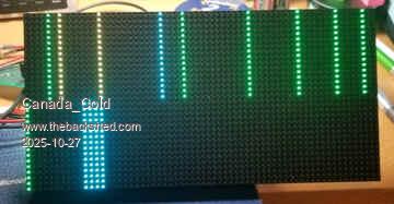

I downloaded the version you posted on Oct 20th (TwoSmMorph.bas).  When I run it all I get is a series of vertical lines.  Please see the following.    I ran the code on a PR2040 and a PR2350 with PicoMite MMBasic RP2040 V6.01.00b14 loaded.  I tested it with a P2.5 and a P4 display and got the same results.
I can see your code should run a demo display with text and several graphics, lines etc. However in my setup it does not get to the demo.
BTW, the clock demo you first posted still runs fine. (MorphClock.bas)
I’ll need to do more testing to see where the code is stopping.   I do apologize for the delay in getting back to you, however I have been on the road traveling.
Don

Hi Don,
thanks for the answer.
The display looks a little bit confused. Some with the clock- and latch-signal.
Did you notice that the connection has changed?
In preparation for expansion to 64 by 64 pixel, I add the "E"-addressline on GPioPin 10(for the PIO, they must be in line with the others).
In preparation for increase the colordepth, I also change the RGB-Pins, sorry.
I have specified this in the header.

Could that be the cause?

Hi Albert,
How stupid of ME not to notice the change in the wiring!!!!   I’ll make the change and give this a test as soon as I can.

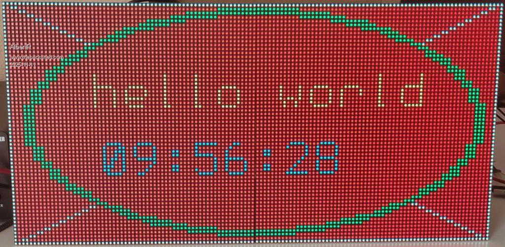

Hi Kevin,
Sure, that's possible. The problem isn't even the speed, but the memory requirements. I was a bit wasteful with it because I was primarily concerned with PIO programming. Each pixel currently occupies one integer (64 bits).
If you use a 2350, that's no problem with 128x64 pixels.
I quickly made a mini demo with two 64x64 pixel modules to show that it works. Only the lines are extended. The 128x64 modules work exactly the same way.

Hi together,
for basic access to the display, here is a minimalist "user display driver"(128x64).
It is not very fast, but it works so far.
It should work for displaying quasi-static information such as time, date, and temperatures. Scrolling text is still a bit jerky.
Now you can use MMBasic commands. Don't forget the DisplayUpdate. If that would be done in the sub, it would be slower.
CLS RGB(red)
DupD()
Color RGB(127,255,127)
Line MM.HRES-1,0,MM.HRES-1,MM.VRES-1
Line 0,MM.VRES-1,MM.HRES-1,MM.VRES-1
Line 0,0,0,MM.VRES-1
Line 0,0,MM.HRES-1,0
Line 0,0,MM.HRES-1,MM.VRES-1
Line 0,MM.VRES-1,MM.HRES-1,0
DupD()'display update
Circle MM.HRES\2,MM.VRES\2,30,2,2,      RGB(0,255,0),RGB(255,0,0)
Text MM.HRES\2-j,MM.VRES\2+8,"hello world",CM,1,1,RGB(255,255,0),RGB(255,0,0)
For i = 0 To 100
 j = Sin(i/15)*15
 Text MM.HRES\2+j,MM.VRES\2-10,Time$,CM,1,1,RGB(0,255,255),RGB(255,0,0)
Next i
End
