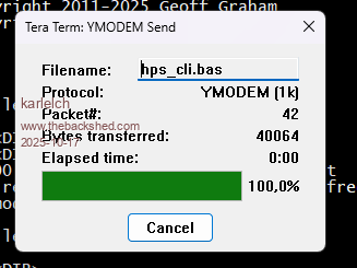

including YMODEM is a great idea!
I tested it today but discovered a bug. I nuked the Pico 2 (2350A) and installed the latest default firmware (RC3, no options set). Then I entered
ymodem receive
and in TeraTerm (v5.2; Windows 11) I started file/transfer/ymodem/send and selected a file on my PC. TeraTerm indicated a transfer but then it stopped at 100% and nothing happens.
After a while, the dialog closes, the Pico remains responsive, but the file is not on the Pico.
The coding in TeraTerm is English/ISO8859-1. I tried UFT-8 but this also did not work (less even, as there was no progress in the file transfer).
ymodem send
is also not working.
> option list
PicoMite MMBasic RP2350A V6.01.00RC3
OPTION FLASH SIZE 4194304
OPTION COLOURCODE ON
OPTION CPUSPEED (KHz) 150000
Any advice?
Best
Thomas

Ymodem tests.
RP2350A VGA mode 3, TeraTerm 5.2 using Pico VCP
Pico prog. mem. to PC - OK
Pico file$ to PC - no transfer
Pico "a:file" to PC - no transfer
Pico "b:file" to PC - no transfer
PC file$ to Pico prog. mem. - OK
PC file$ to Pico "a:file.ext" - OK
PC file$ to Pico with drive a: active, Y modem receive "file.ext" - no transfer
PC file$ to Pico "b:file.ext" - OK
Xmodem test.
Edited 2025-10-17 10:36 by phil99

Posted: 06:09am 18 Oct 2025
  phil99 said  Xmodem test.
Same here.
With YMODEM, nothing works for me.
P.S. "2025-10-11_021652_PicoMiteV6.01.00RC0.zip" was the last version XMODEM worked fine.
