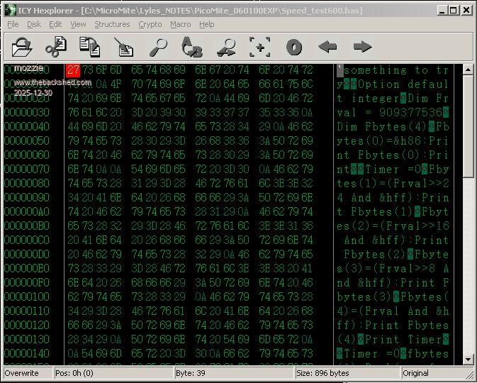

Posted: 05:24pm 29 Dec 2025
G'day,
During testing of V6.01.00 and V6.01.00EXP2 using TeraTerm and Xmodem a problem has come to light, this is with xmodem s and xmodem s "filename.bas"
The internal editor and Xmodem r appear to be working fine.
Tried: (with Clear_Flash before each upload)
PicoMite RP2040 V6.01.00
PicoMite RP2350 V6.01.00
PicoMite RP2040 V6.01.00EXP2
PicoMite RP2040 V6.00.03 - working fine
The line ending characters are being removed from the file during transfer and being replaced by &h0A
Also +++++++++++++ being added to end of file

Can anyone else please confirm?
Lyle.
Update:
Xmodem s - removes &h0D but not &h0A from line endings
Xmodem s "filename" - line endings ok
Both add &h1A as padding characters to end of file.
Edited 2025-12-30 04:01 by mozzie
Posts: 4391
Posted: 06:46pm 29 Dec 2025
Xmodem traditionally padded files to a multiple of 128 bytes using &h1a (0x1a, ctrl-z).
I think due to being on CP/M, with its block size of 128.
Posts: 12059
Posted: 07:32pm 29 Dec 2025
  Quote  Can anyone else please confirm?
No: works perfectly for me. Just the end of the file padded with &H1A which is correct.
Is that your full option list? If so you should always configure touch if the display has it otherwise bad things can happen - floating CS for the touch chip
Posts: 6626
Posted: 07:33pm 29 Dec 2025
XMODEM S without a file name sends a listing of the current file. MMBasic is probably listing with <LF> as the line ending. This is not a problem. MMBasic is happy with either <CR><LF> or <LF>
The padding ctrl-Z is from the CP/M days but zeros are also acceptable.
XMODEM requires a full packet of 128 bytes and may send a complete block of all crtl-Z if the file size happens to be a multiple of 128 bytes.
This has worked well for 40 years...
