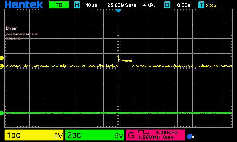

Ok got the big board all setup and no movement on the DM556 yet now I know I probably did the wrong thing but just had to try it   pulled up the DM556 to the 5 volt pin on the board. This is the step pin Channel 1 is connected to
So I think is time to make that 5 volt board using a BC547 and the resistors then having another go

Ok made up the 5 volt board using BC337 trannys as I have plenty of them here and getting closer
Phill I didn't use enable as it is an option and the DM556 can work without using it
Edit: just ran the code with Channel 1 just connected to GP26 which is the step pin and it was a tad cleaner trace but the same as the picture above
Edited 2026-04-21 11:44 by Bryan1

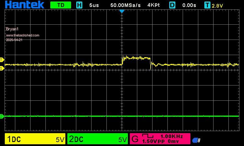

Bryan1
Joined: 22/02/2006
Posts: 2297
Posted: 02:21am 21 Apr 2026

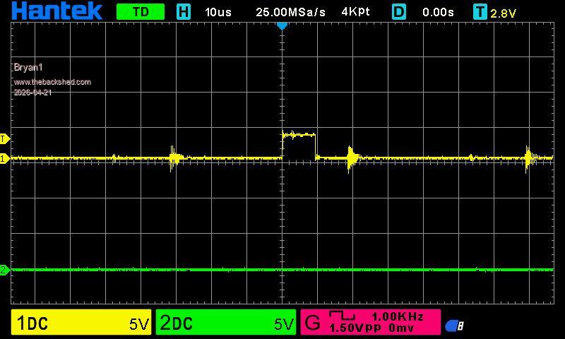

YAY got finally got the DM556 working       thought I would try putting the wires to ground as in the grey moments had them pulled up and saw the dial indicator move
So now off to Ebay to buy 3 new DM556's for the surface grinder and man we have lift off........
Edit: just noticed I had the 5 volt pull up in the hole beside the 4.7K resistor and while doing a run the scope did confirm it is running on 3V3
Here is a scope pic of it running
Edited 2026-04-21 13:19 by Bryan1

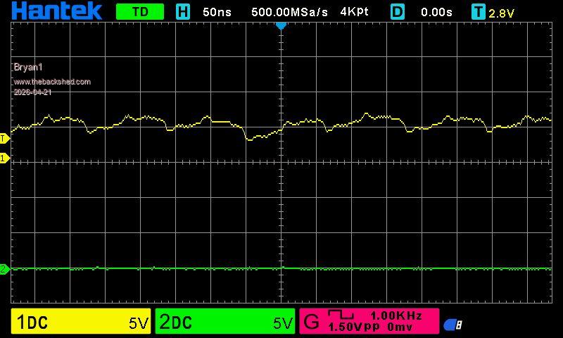

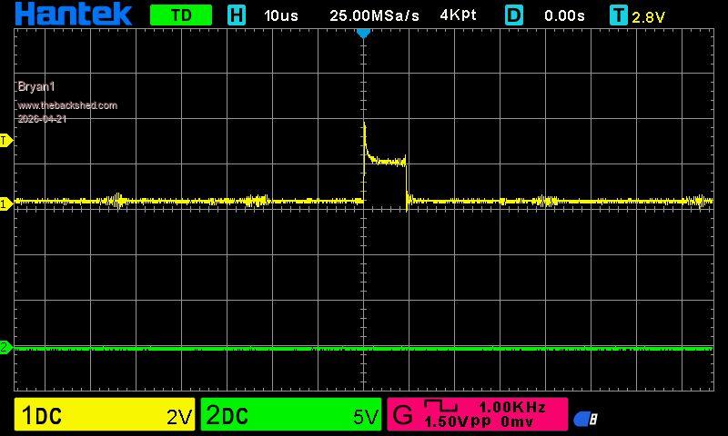

Now having a bit of play with this and one thing I found where I have set in Mach3 282 step/min which is accurate to a thou   going 1100 steps with the code only goes 0.95mm, now as there is a nice spike when it goes high I set the scope to 2 volts to capture it
Now I have used the 5 volts on the cnc board for the pullup on the collectors and the probe for Channel 1 is on the collector for the step pin yet it clearly shows a lower voltage for the step trace.
On reading the Stepper PDF I enable the Scurve thinking it smooth that spike and no matter what I set the Stepper Jerk value I get the error it is too low even when I set to the step/mil figure so a bit to learn with this command.

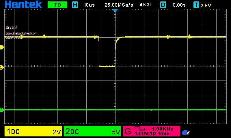

Posts: 3416
Posted: 04:33am 21 Apr 2026
See the circuit diagram in Lyle's post at the top of this page. It shows the 3 input (+) terminals connected to Vcc.
Make sure they are connected to 5V, not 3.3V.
Edit.
Downloaded the DM556 manual. Here are the relevant bits.
Logic signal current 7min 10typ 16max mA
PIN                   Details
PUL+, PUL-            Pulse Connection: Required.
(1) 5V / 24V, optically isolated, differential.
(2) Maximum 200 KHz input frequency.
(3) Pulse width of 2.5μs or longer.
(4) In single pulse (step & direction) control mode, this input signal represents a pulse which is active at the rising or falling voltage edge (set by DIP switch SW13); in double pulse (CW/CCW) control mode, this input signal represents clockwise (CW) pulse which is active at both high voltage level and low voltage level.
So it looks like the transistors should be wired to invert the signals.
10kΩ from Pico pin to base, emitter to ground and collector to input (-).
All input (+) to 5V. Pullup resistors not needed.
With the scope connected between input(-) and Gnd. you should see inverted pulses going from about 4.5V to 0V
Edited 2026-04-21 14:58 by phil99
Bryan1
Joined: 22/02/2006
Posts: 2297
Posted: 05:33am 21 Apr 2026
Ok just did the change Phil and looks like for once I got it right
Regards Bryan
