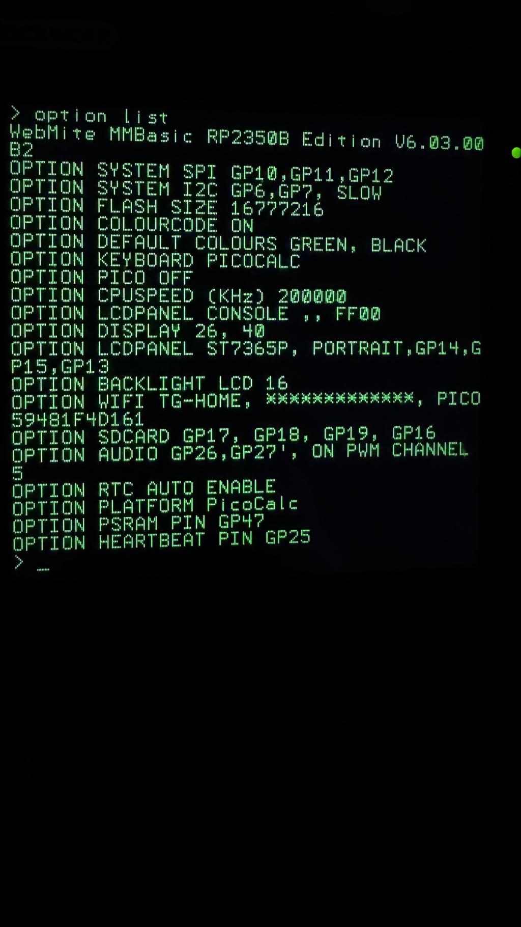

The manual example worked for me on a RP2350B Pimoroni Plus W as did Geoff's watering controller (much bigger program)
What options have you got set? Try lowering the cpuspeed if above 200MHz. The RP2350B Pimoroni Plus W doesn't seem to like overclocking, or at least mine doesn't.
terekgabor
Joined: 02/01/2026
Location: Hungary
Posts: 155
Posted: 05:50pm 26 Apr 2026
I lowered the CPU speed to 200MHz, same problem.
Options attached.
If I put End before json$ the program stops normally.
And from command prompt I can print json$, but in the program causes restart.

Posts: 12055
Posted: 06:07pm 26 Apr 2026
Have you got a standard pico2-W you can test with?

Posted: 06:13pm 26 Apr 2026
Yes I have, and first I have to step back to B1 for a try. Then nuke again and B2 again.
I tried print json$(…) and also xy$=json$(…) in the program , restart immediately.
I also try to relocate this section of the program without success.

Posts: 12055
Posted: 06:38pm 26 Apr 2026
List your version of the program - leave the code out I've got my own

Posted: 06:45pm 26 Apr 2026
Peter!
first test: I did step back to B1, no problem with it.
Then upgrade again to B2, problem came.
second test: I cut this part from my "big" program to a new one - only some lines I attached. Not working wiht B2, when reaches last line json$, restarting.
Same options,same Picocalc, same Pimoroni Pico Plus 2 W
test2.zip
If I will have time today I will change to normal Pico 2 W, if not I think next day is Thursday - I will leave for a business trip.

Posted: 07:21pm 26 Apr 2026
Peter!
Third test: I put ‘end’ in the test2.bas program before the last line (which is containing json$).
Program ran without error. Then try Print json$(wthr(),”timezone_offset”) or also tzo$= json$(wthr(),”timezone_offset”) from command prompt. System restarted in both case. I think something with json function can cause this.

Posts: 12055
Posted: 07:13am 27 Apr 2026
G@bor
Please try this version which has the cache functionality disabled and should be pretty much identical to B1
PicoMite.zip
The issue is almost certainly the build running out of C heap but I don't know why.
