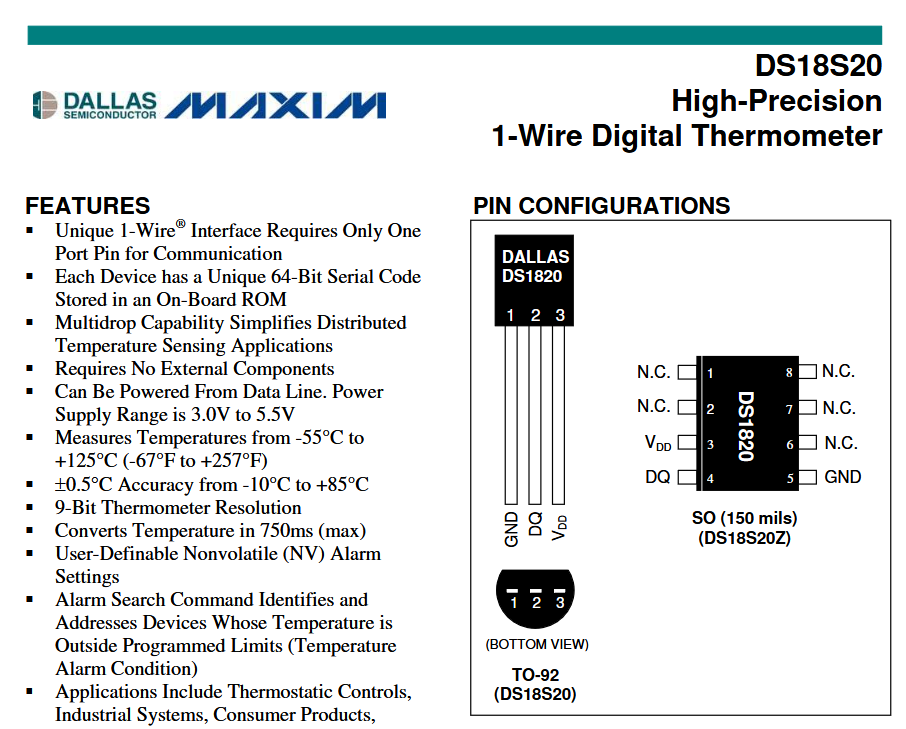

Posted: 10:55pm 29 May 2026
Thanks for the extra testing. It filled all the gaps in the T3 data which I now see goes from 16 to 1 with increasing temperature.
And that makes quite a difference. The equation in the datasheet does not appear to be correct.
The data you have given me should be enough to simulate a DS18S20 properly and find the correct equation. More to follow.
Edit.
This gives the most sensible results:-
DS18S20t = Str2bin(int16,Chr$(T1)+Chr$(T2))\2 + (16 - T3)/16 -0.9375
'or
Value = Str2bin(int16,Chr$(T1)+Chr$(T2))\2 + (16-T3)/16 -0.9375
And also appears to work below zero.
Edited 2026-05-30 12:26 by phil99

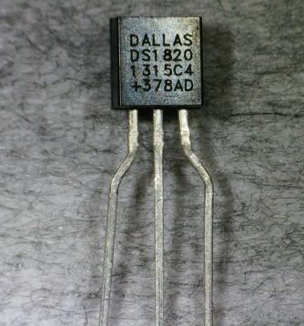

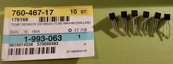

Peter63
Joined: 28/07/2017
Location: Sweden
Posts: 217
Posted: 01:44am 30 May 2026
photo of the DS18S20 marking used during test
/Peter63

The COUNT PER °C scratchpad is supposed be always 16 with the DS18S20 but Peter has a DS1820 according to the photo.
Are you sure that COUNT PER °C is always 16 with the DS1820?
I don't have either chip to test with.

Jim, you are right, as you were writing that I was reading the Dallas DS1820 datasheet and COUNT PER °C varies according to an internal calibration table.
I will incorporate that and ask Peter63 to test again.
The saga continues...

Posted: 03:38am 30 May 2026
I thought I had a DS18S20, according to my saved label, but now it doesn't seem to be so.
Happy to test further...
Edited 2026-05-30 14:01 by Peter63

Could it be DS18S20 that I have, but maybe they are mislabeled?

Posts: 6626
Posted: 05:08am 30 May 2026
Thanks to Googles AI,I found another datasheet that suggests that the DS18S20 uses the same die as the DS1820 so has the same markings "DS1820"
That's bloody helpful!
I never trust the BS that Googles AI spits out but it might be right this time.
Peter63
Joined: 28/07/2017
Location: Sweden
Posts: 217
Posted: 05:19am 30 May 2026
Feels like it would be so Dallas Maxim, the variant is also TO-92 which I have.
/Peter63
