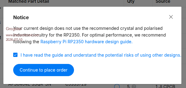

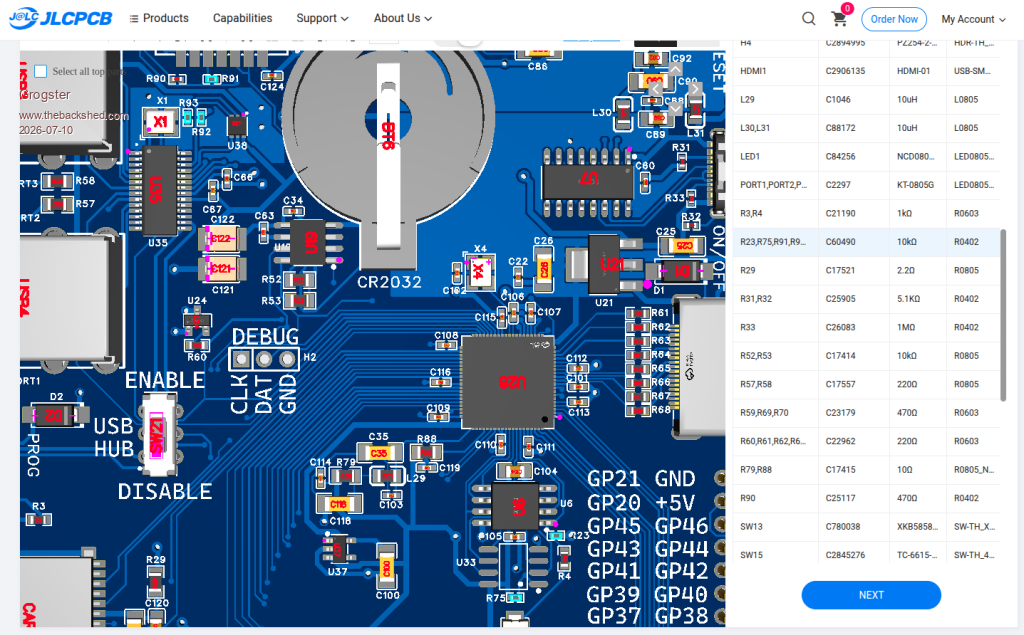

Posts: 10076
Posted: 04:41am 10 Jul 2026
I also had to change the 10k 0402 resistors - JLC said they had no stock.
I just followed my nose, and used their parts selector, to choose another 10k 0402 resistor that they DID have plenty of.
JLC also moaned VERY SPECIFICALLY about the design NOT using the approved 2350 oscillator design - Peter: care to comment?
I just ordered anyway, as I expect your design is fine in that area, but obviously some custom designs that DON'T use the RP recommended oscillator design have caused problems for some people, or JLC would not throw up that pop-up.

I know it sounds silly but where are GP8 and 9? I'd like to connect a serial device to COM2 but I can't find the pins.
dddns
Joined: 20/09/2024
Posts: 924
Posted: 10:00am 14 Jul 2026
GP8 and GP9 go to a CH340 and this is connected to a USB-C socket. See schematic in first post
