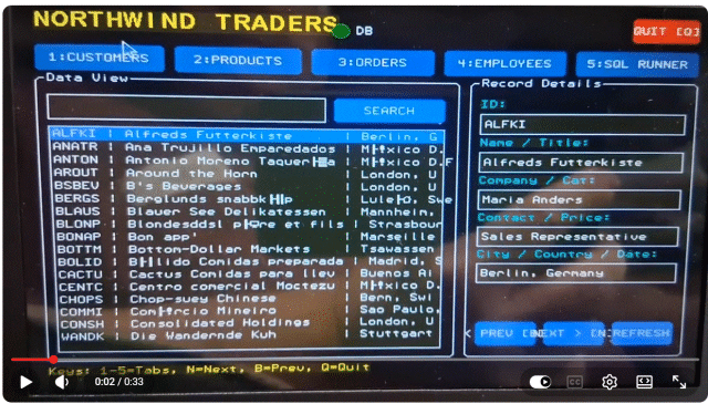

Both Claude Code and Gemini report "out of memory" on every usqlite attempt, including opening. I'm reverting to 0.10.
Everything Gemini tried on v0.10 worked.

  Quote  Both Claude Code and Gemini report "out of memory"
Have you got PSRAM? Try running it yourself rather than using AI. I guarantee your test program works
What are Claude and Gemini actually testing? Unless you give me actual programs that fail I can't do anything and your reports are pointless

  matherp said  Have you got PSRAM?
I have PSRAM. I flashed v0.11 again and the test program runs and the "Out of memory" errors aren't occurring, so I'd have to guess it was a flashing problem, although by appearance there was no issue.
Meanwhile, it's hard to keep up, but I'm trying to be a fast follower. Gemini  Antigravity CLI 1.1.5 with a Pro monthly subscription running in Windows PowerShell built this in about an hour, talking directly to the PicoCom3 over Com4.
Youtube Northwinds

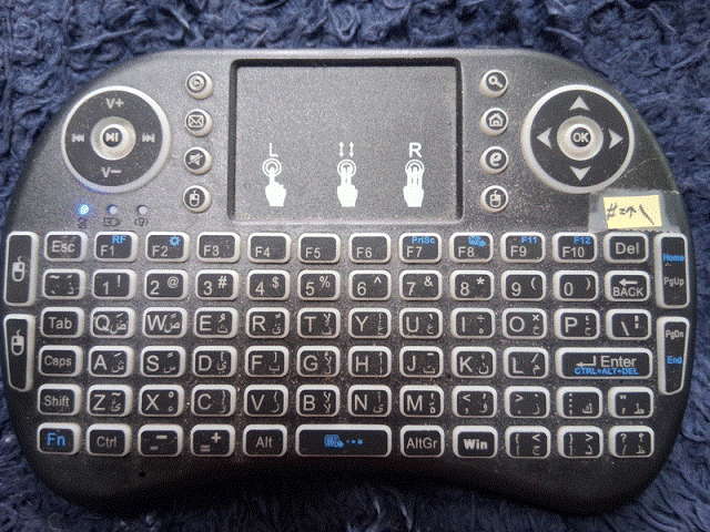

I plugged in the usb RF module from this to get mouse and keyboard:

   SQLite hardened against resets and power loss — a full review of the on-device SQLite engine (import usqlite) fixed three classes of defect. A soft reset (Ctrl-D) with a database open no longer corrupts the engine (previously the next session could hard-lock on its first db.close()); connections and cursors are now fully garbage-collector-safe (a use-after-free on close(), and dropped connections leaking their memory for the rest of the session); INTEGER columns are now true 64-bit in both directions — millisecond timestamps stored from Python no longer overflow on write or silently wrap on read. Filesystem trouble (missing directory, full flash, an SD card pulled mid-query — pulling the card is a supported action) now raises a clean Python error and leaves the engine healthy instead of unwinding through SQLite's internals. And power-fail recovery now actually works: a power cut mid-write leaves a "hot journal" that is detected and rolled back on the next open, where previously a torn database could be served as valid — verified on hardware with physical power pulls during committed batch writes (clean rollback each time). The API is unchanged and existing databases are unaffected. On-device test suite included (tests/sqltest_a..e.py).
   USB mouse: high-resolution mice fixed, and any HID mouse now works — mice reporting 12- or 16-bit movement moved erratically: the firmware left the mouse in USB boot mode (plain 8-bit reports) while decoding the full-resolution format the mouse describes, so the two never matched. The mouse is now switched to report mode at connect (as MMBasic does), and the decoder has been generalised to read each mouse's own HID descriptor — any button count, movement resolution, wheel position or report-ID scheme — instead of recognising three fixed layouts. Combo receivers that share the mouse interface with media keys no longer jitter the cursor when those keys are pressed, and a mouse that refuses the mode switch falls back cleanly to 8-bit decoding.
