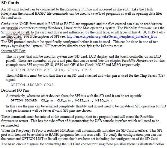

  Quote  it appears that OPTION SYSTEM SPI cannot be set on HDMIUSB builds
I think this has been mentioned in the past and the verdict was OPTION SYSTEM SPI is only available on LCD versions.
  Quote  Display Panels
NOT AVAILABLE ON HDMI OR VGA VERSIONS
System SPI Bus
The system SPI bus is a dedicated SPI channel which is used by many LCD panels, all touch controllers and also to communicate with a SD Card.
However with HDMI + resistive touch screens now in use it could be useful for sharing with the SD card.
Edited 2026-08-10 10:57 by phil99

Posted: 01:30am 10 Aug 2026
G'day,
Phil, you hit the nail on the head    looking back through all the saved option lists for HDMIUSB versions and non are showing OPTION SYSTEM SPI, my head says otherwise but in the light of a new day I am mistaken. Sadly we cannot have SPI touch with HDMI so SYSTEM SPI is not really relevant.
Also thanks for the Ascii table, very easy to use
Peter, my apologies, another red herring
Perhaps a note in a future version of the manual would be useful to avoid confusion.
Regards, Lyle.
