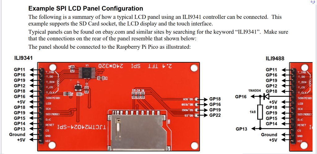

Is it possible to include the ILI9488 modification in the manual, perhaps like this?
The resistor value has been chosen to work with all panels including those with 4k7 pullups on the SD card SPI pins.
Posts: 11888
Posted: 01:21pm 13 Sep 2026
done
