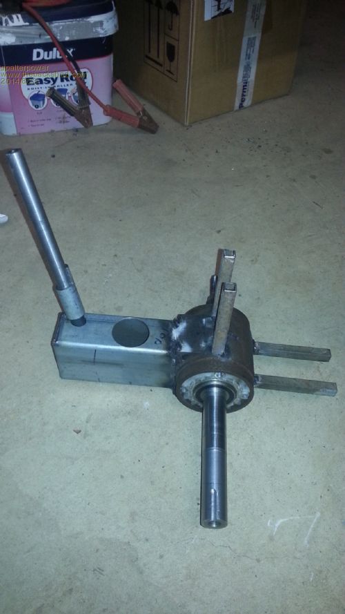

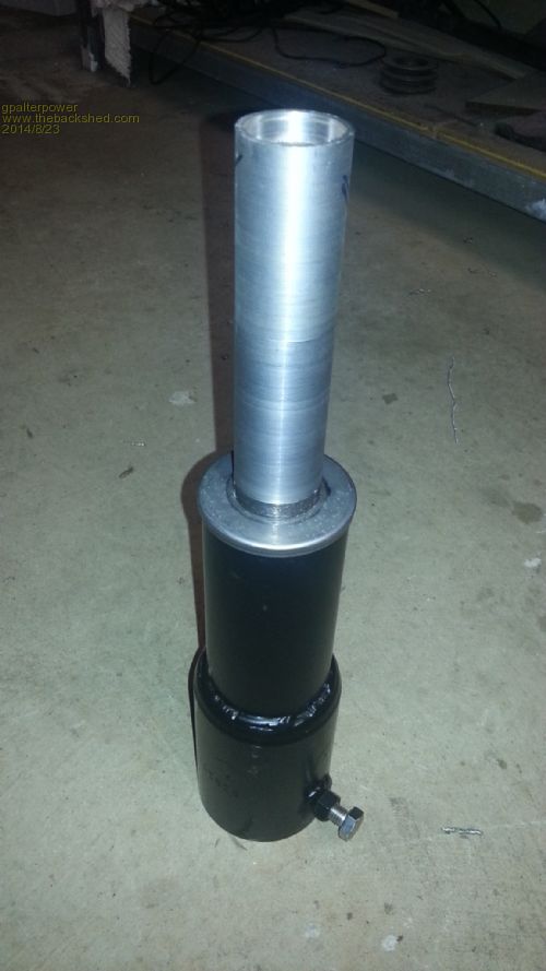

Well Ive been away for a while but now im finally going to finish the dual mill I started years ago. Ive used most of the original parts I manafactured and made a few changes but nothing is set in concrete yet as the whole thing is just tack welded together.The first pic is an attachment that sits ontop of the tower. It houses a 40 mm thick walled hollow shaft suported by 2 6008 bearings. The nacel sits upon this.
It is made up from the following parts

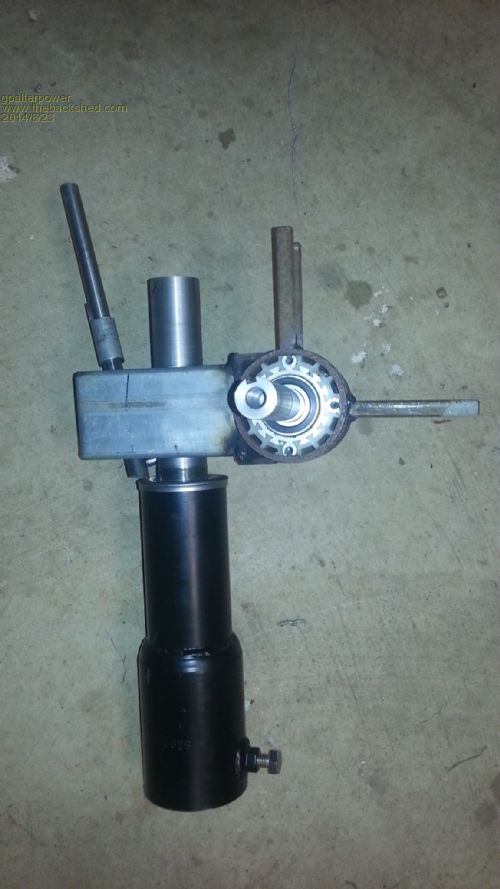

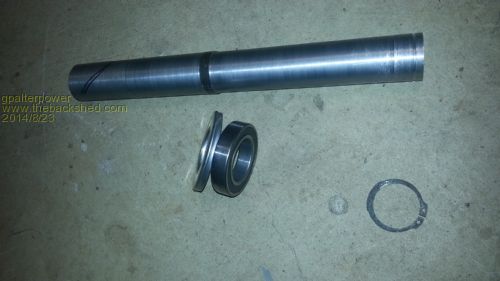

The bearing mounted tube is secured on the base by a circlip which holds everything from falling apart when hoisting the mill in the air.

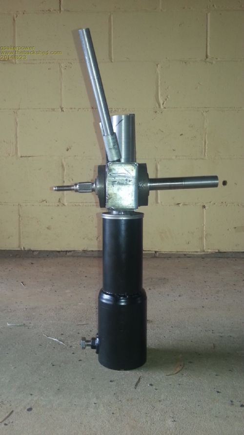

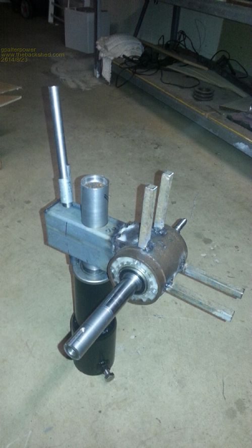

The nacel is the heart when it comes to fuling so I believe its critical in dimentions. I made the distance from the tower shaft and the turbine shaft 100mm which is tilted up at angle of 5 degrees. Not too sure if these are correct or within tolerances, but im going on previous posts and pics. Any input to this would be greatly appreciated

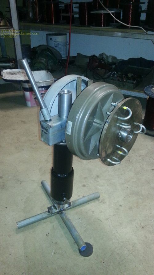

And with it assembled. The 2 sets of 13mm rhs poking out are for a cowling that im going to fit later on to protect all electrical components.

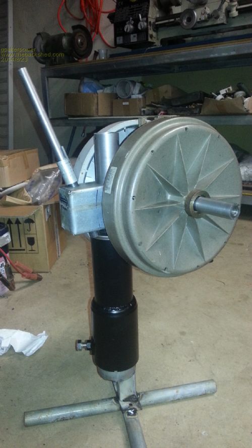

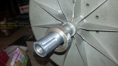

The rear flywheel is attached in the normal manner. The front is a little different. I machined a section away and fabricated a ferrule to slip over and tighten to secure to the shaft. The blade hub also sits hard up against the ferrule.
And with the blade hub attached. A 6mm key and 12mm bolt in the front of the shaft to drive the mill.

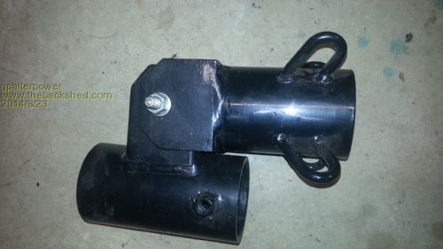

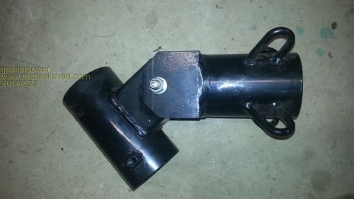

This is the hinge that sits upon the first length of 75mm pipe which is concreted in the ground . the second length slips thru and pivots the mill to about 8.5 metres in the air. The four half chain links are for the guy wires

Hi Marcus. Nice work mate .
You must have gone to the same tech college as Phill,lol.
first ,why are the "U" bolts not in line ?
second, I like the fabrication , cover the rotors, they don't like UV.
Yep, I know you know this,lol.

Bruce,
I think the idea is for the blade shafts to pass the generator axis which transfers the the blade torque and clamping load across the whole plate instead of just the edges.I have incorporated this on some of my designs as yet unfinished.I think I've been out of action for a similar period unfortunately.I agree he has made an excellent nacelle assembly.

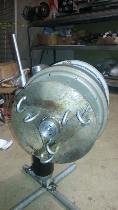

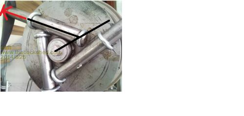

Morning all and thanks for the comments. When I first made the hub I only had acces to a fairly small lathe and the maximum dia I could turn was 250mm. So I had to think of a way to somehow fit 3 shafts on to that plate. A cross hatching idea was the best I could think of which is why it looks like the "U" bolts dont line up.I did not think outside the square when it comes to pivoting on the outer clamp. There may well be issues down the track and I allready have some plans in the back of my mind how Ill make the next one, but for now ill run with what I have. There could also be an issue with using the original shaft driving 2 rotors as well as the hub. A lot of twisting forces on that 25mm shaft. hope it holds. The pic from my earlier post below shows the shaft configuation. regards Marcus
Posted: 03:33am 24 Aug 2014
  fillm said   I personally do not like configuring blades that way as the centrifugal force now acts as a giant lever on the outer clamp and when the blades gets going in a good breeze its to easy for everything to go pear shaped. Hey but just get it in the Air and fix things when and if they break.
Keep us posted , it is just good to see someone doing something !!!
That giant lever you are talking about only springs into action if the hub should suddenly offer a much bigger resistance against rotation (seizing up).
I doubt there is any significant different centrifugal torque load acting on the outer u-bolt with that arrangement under normal power generation loads than if the blade shafts were arranged in the more conventional way.
We are talking here of RPM < 600 I assume.
What will be different is the airflow across the blade which is now more obliquely but again not, IMO, enough to effect their efficiency significantly.
fillm
Joined: 10/02/2007
Posts: 730
Posted: 12:23am 25 Aug 2014
Tinker,
I think you are on the wrong track, if the blade outer clamp was removed and the inner clamp could pivot freely then the weight mass would want to swing out until it is at its balance point radiating out from the center, this would still the same for driving an alternator, and yes you are correct here, seizing & braking would amplify this load.
The leverage force ratio on the outer clamp would basically and very roughly be the distance between clamp x distance to center of the mass of weight in the blade but I am sure it will much more complex than that in a true mathematical equasion .
As it rotates the outer clamp takes this load factor and I would think at 600RPM if the blade tube if it not strong, then would want to start bending if not already.
I would think the original intention was with only small light blade & hubs being able to have well spaced clamps to hold the blades .
Airflow or blade performance should not affected as the blade is still at the same AOA and faces the wind as it should
Jarbar
Joined: 03/02/2008
Posts: 225
Posted: 02:30am 25 Aug 2014
This type of bending moment already exists with the blade sections design.When it was originally conceived it was drawn up by Glenn(Gizmo)with the shaft to be located thru the center line of the blade chord,but this presented a problem of not enough space to fit an adequate shaft diameter.
I suggested that it be moved to the widest depth section of the of the blade,closer to the leading edge.Which at the time looked a bit odd and did throw up the question about unequal mass around the shaft.(Although the hollow extrusion is comparatively light)As it stands about three quarters of the blade mass is in the trailing edge section.This may have become more pronounced with the blade material going from PVC to Aluminum although I'm not sure about the per meter weight of the Aluminum blades?
But either way the fact is the blades themselves are already offset and with the above attachment configuration might actually compensate somewhat for the off center blade mass.If the blades were orientated to the above photo for an anti clockwise rotation the offset mass of the blade could be said to be counterbalancing the effects of the leverage being suggested.
In fact every mill that's been produced with these blades has the same bending moments to the shafts attachment point.To what degree one is greater than the other,that really is a mathematical can of worms. I have just noticed the blade on the shaft on left side of photo,which would be adding to the leverage,but like Tinker I would wonder if it's enough to cause shaft bending.
AnthonyEdited by Jarbar 2014-08-26
Posted: 03:54am 25 Aug 2014
  fillm said
Tinker,
Fillm,I very much doubt that a windmill blade attached only by a pivoting inner clamp would indeed balance by pointing out directly radially from the shaft center. To do that one has to completely ignore the wind effect on the blade. As well as the blade's longitudinal axis balance as Jarbar so succinctly pointed out.
Since with a windmill the blade is driving the shaft I think the blade would assume a forward raking (blade tip radially ahead) balancing point. This would nicely complement the off center shaft in the blade IMO.
It would be interesting to test that but one needs access to a high speed camera etc.

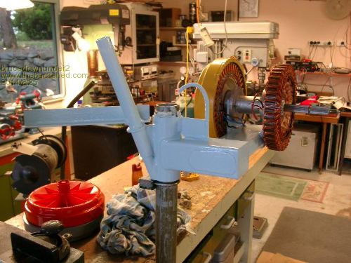

brucedownunder2
Joined: 14/09/2005
Posts: 1548
Posted: 11:21am 25 Aug 2014
This was my set-up for a dual some years back . The yellow rotor was fitted with Neo's. I think the red one was also , but during fitting I dropped it on the concrete driveway and swore a lot --that ended that project.,lol.
But the neo's sure did give more power.
That hub was an aluminium casting from Trev . Very heavy duty, trev makes excellant stuff. That's aircraft grade Al,tough as.
Bruce

Joined: 10/02/2007
Posts: 730
Posted: 02:27pm 25 Aug 2014
Tinker,
Think about the fact that the blade is driving the the blade hub through the shaft that is held buy the clamps with ability to drive forward using power from the wind, it does have drag but is overpowered by lift and if this was not the case it would not move forward.( take the back stay of your yacht with the sails up and what will happen)
Then the blade hub is driving the alternator shaft which is opposing the forward movement with it Amp load.
If the 3 blades were able to be pivoting on the inner point and interconnected they would more likely want to be on the opposite side at balanced position between centrifugal force and pulling the opposing load. Take the blades of the tubes and replace the outer clamp with springs and you then have a flyweight governor arrangement. So one would think the easiest fix is to have the blades set in anticlockwise rotation, it may help in some small degree but centrifugal forces will always be the greater force to deal with and it will still be acting on the outer clamp with this configuration.
Posted: 03:11am 26 Aug 2014
  fillm said   Tinker,
Fillm, I will digest your reply (deleted here) for a while but one comment above needs clarification.
*you* are wrong with the removing the backstay example. My yacht does *not* have a backstay nor is the mast supported by any other stays.
Its called a 'free standing rig', cat ketch in my case and she sails well despite the absence of any stays holding the mast up.
I am familiar with the lift/drag effects of airfoils /sails and its not as simple as you put it.
For example, a VAWT is a drag powered device and yes, it does rotate forward albeit nowhere near as efficiently as a foil that also has lift powering its rotation.
This 'lifting force' BTW acts not exactly in the direction of rotation but is a vector between the angles of the drag and lift forces.
Its the windmill shaft that forces the blade to rotate forward just as the keel/ centerboard of a yacht allows the boat to progress at an apparent angle to the wind.
Sailing downwind is drag powered just like a VAWT unless somehow the water drag can be overcome (planing) and the increased speed causing the apparent wind to move forward so the sail is now experiencing lift.
Its a fascinating subject...
I think the radial/ off radial windmill blade mounting conundrum could only be resolved by fitting load cells on both sides of the inner and outer blade mounting.
With that data and the calculated centrifugal force at a given RPM this discussion could be settled scientifically once and for all.
A high speed camera (as I mentioned above) would, on second thought, not suffice as it is very likely the blades unbalance if not securely clamped in a fixed location with disastrous results.
