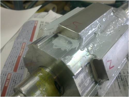

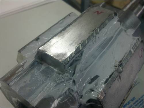

Finally i had a chance to epoxy, now i just have to wait a week for it to cure. The guys i bought it off said i only needed it under the magnet but i have played it safe and glued the edges of the magnets aswell.

Hi Cameron,
With my 1.5 kw conversion I full epoxied the magnets and rotor then machined the epoxy to size. This will ensure if any water ingress's into the motor the neo's are fully sealed and won't start to rust.

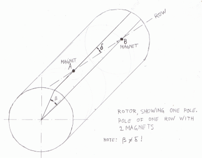

Looking at this picture, I notice that the magnets are much shorter than the stator length (if the length of the rotor is the same length as that of the stator, which I assume to be the case).
If so, a 10 degree skew will not be enough. The shorter the magnets are, the more skew is needed.
360 degrees/36 slots = 10 deg skew, *assuming* the magnets cover the entire length of the stator. In your case, I expect the angle would need to be 100/75=1.33 times larger, i.e. 13.3 degrees. (if the stator has a length of 100mm, and the magnets are 75mm long)
I think you will find your rotor will cog at least some. Hopefully not a lot, but will be interesting to see what the results are.

Ahh, I was wondering why my skew didn't look as much as others i have seen. The rotor is actually 120mm long which means i should have skewed them at least 15 degrees by the sounds of it. Oh well it will be intersting to see what my startup wind speed will be.

[quote]The rotor is actually 120mm long which means i should have skewed them at least 15 degrees by the sounds of it[/quote]
The stator is the determining factor, not the rotor. If the stator is 100 mm long, the skew angle should be correct for that. Length of the rotor does not influence the skew angle. The length of the magnets (relative to the stator length) does influence the angle.
[quote]Ahh, I was wondering why my skew didn't look as much as others i have seen.[/quote]
Which angle did you make 10 degrees, beta or delta?
Notice that beta should be 10 degrees (assuming the entire stator is covered with magnets, not just part of it, as in your case), and that, depending on the length and diameter of the rotor, delta may be smaller, larger or equal to 10 degrees.

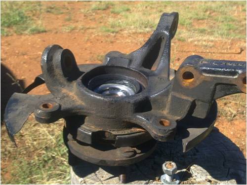

With a few modifications this will be the thrust bearing for motor. Wheel bearing of a car.

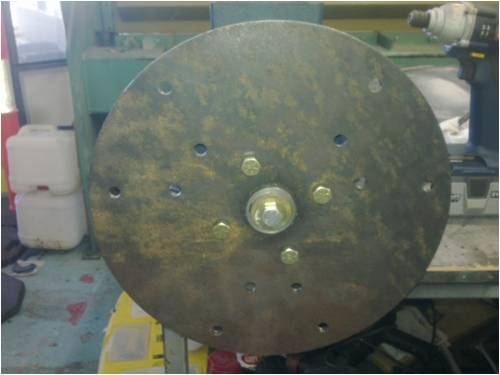

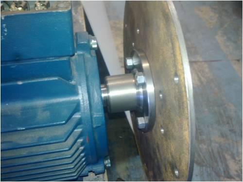

Posted: 01:39am 12 Jan 2010
I have finished the flange that will allow me to now attach the blades. I did a test spin by hand and the motor easily reached 30-40 volts (approx 180rpm), so i think i will hook it up as a 48v system to start with and see what i can get out of it. The cogging i would guess is similar to a smart drive motor that hasn't been filed. BETTER than i was expecting.
