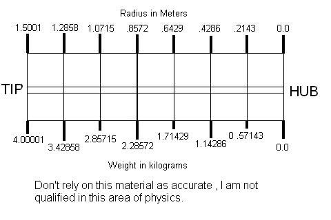

Greenbelt
Joined: 11/01/2009
Posts: 566
Posted: 09:17pm 22 Nov 2009
  oztules said   Greenbelt,
Would it be true that the workings you have used, actually only demonstrate the force of your final mass at maximum radius.... ie it is really saying that you get 5 tons for a weight of 3.5 kilos at 1.2 meter radius?
OZTULES, GLEN, KARL3
Yes, I had intended to note this on my post.
I use MS Notepad as a work sheet and I had parked the
note way down the page, when I copied and pasted to the
post Board,it was out of sight on notepad and didn't get
copied. I did a section annalisis< yesterday using seven
points along the radius and will post it a bit later;
As Glen suggested, should anyone wish to follow through
and design a turbine from this info. it will necessary
to slice up the turbine like a loaf of bread and weigh
the slices, then keep track of its location on the radius
calculate each slice then add the values for a true
picture.
I'm exploring here, so don't take it all to seriously. Thanks for the wakeup call.
EDIT: deleted note to install smiley Icon Edited by Greenbelt 2009-11-24
Greenbelt
Joined: 11/01/2009
Posts: 566
Posted: 10:24pm 22 Nov 2009
Your Right OZ; ('')
The Center of mass for an object rotating about a point which is not located within the Object. (orbiting) But ajacent to it.
The problem becomes a series of calculations for centrifugal force using radius values from 0.0 to maximum in equal steps. Then find the point on the radius where the Hub end series of Values equal the Tip end results,
This should give a reasonable value for the (apearant center of mass), Of course the shape of the object being studied will have a great effect on the physical location. Some mill blades have Beefy Hub sections but taper toward the tip while other's are a blunt affair with a uniform cross section.
Out of curiousity I will stick my neck out and do a 7 step operation on a 700 rpm, 1.5 m radius, 4 kg.mass. Keeping it simple, the cross section is assumed to be uniform thruout its length, and its true mass is distributed equally. No stiffener bars or tubes are considered.
I am using the same mass for each 8.5 inch (22 cm.) section, only the radius value changes,
It seems to have a linear progression averaging 148 pounds increase from one step to the next. Different blade speed would change the number Oz is correct about the location of the (apparent center) of mass as far as I can tell from the numbers. It is located near the one meter mark 39 inches from the Hub, 66% of blade length and is within section 5
(1) w= 6.28 X 700=4396/60 =73.27 X 73.27=5368.00 X r .2143 = 1150.36
X m .57143 = 657.35 newtons/4.44809 = 147 pounds;
(2) w= 6.28 X 700=4396/60 =73.27 X 73.27=5368.00 X r .4286 = 2300.72
X m .57143 = 1314.7/4.44809 = 295.56 Pounds
(3) w= 6.28 X 700=4396/60 =73.27 X 73.27=5368.00 X r .6429 = 3451.08
X m .57143 = 1972.05/4.44809 = 443.44 pounds.
(4) w= 6.28 X 700=4396/60 =73.27 X 73.27=5368.00 X r .8572 = 4601.44
X m .57143 = 2629.40/4.44809 = 591.13 #
(5) w= 6.28 X 700=4396/60 =73.27 X 73.27=5368.00 X r 1.0715 = 5751.81
X m .57143 = 3286.75/4.44809 = 738.91 #
(6) w= 6.28 X 700=4396/60 =73.27 X 73.27=5368.00 X r 1.2858 = 6902.17
X m .57143 = 3944.10/4.44809 = 886.69 #
(7) w= 6.28 X 700=4396/60 =73.27 X 73.27=5368.00 X r 1.5001 = 8052.53
X m ,57143 = 4601.46/4.44809 = 1034.48 # Total = 4136 pounds.
w= 6.28 X 700=4396/60 =73.27 X 73.27=5368.00 X r 1,5 = 8052 x m 4.0 = 32208/4.44809 = 7240 pounds.
(This result assumes all mass is at the Tip)and is not useful, If this were a 3 meter blade then this would be a section value at 1.5 m. radius

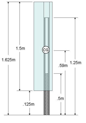

I have had a little time today to give this problem some thought. Since we are starting with the Centripetal forces first I made a model for the conditions Phill originally provided for us. I am troubled reading through some of the posts here because the math is generally correct but it's application has been off substantially. Not trying to sound snooty at all, I just think some things are being dropped in the translation. I'll take a shot at it and as always check it over, nobody's perfect.
When dealing with blade design and rotating loads in general is is critical to correctly determine the center of mass for the object and relating it to a reference point. As I said before, this is an easy problem to model because of this particular design. The only wrench in the works is because this is a compound system. I broke it down into three components. The stub, the tube, and the blade. Here is the info Phill gave us.
The point of reference is the center of the hub. It has to be regardless of where the blade lies. The rotational center. In the diagram the mounting stub and tube go all the way to the center which is a little different than real life but this is negligible.
1.) First step is to determine the moment of inertia for our system. This is just the balance point for all these components added together. I used standard values for the material Phill pointed out. Reference the diagram as well.
Mb - mass blade = 1.75kg
Rb - radius of blade center = .875m
Mt - mass of tube = .912 kg
Rt - radius of tube center = .625
Ms - mass of stub = 1.52kg
Rs - radius of stub center = .25m
The center of mass is given by the following equation;
So the math is;
R = (Mb*Rb + Mt*Rt + Ms*Rs) / (Mb+Mt+Ms)
R = (1.75kg*.875m + .912kg*.625m + 1.52kg*.25m) / (1.75kg+.912kg+1.52kg)
R = .596 m
This means the center of mass for this whole system is .59 meters from the center of the hub. We'll get into the sub components in a minute.
2.) Now we will calculate the centripetal force of the whole blade assembly on the hub. This is what most people are doing and calling it done. We won't be done but we will start there.
Turn 1000 rpm into rad/sec (w);
w = rpm*pi /30
w = 104.7 rad/sec
Determine Centripetal force the whole blade assembly exerts on hub (Fa)
Fa = M* R * w^2
Fa = (4.182kg)(.596m)(104.7)^2
Fa = 27322 Newtons = 6142 lbf.
So a blade constructed just as Phill has outlined in his posts will attempt to 'fly' away from the hub with a parting force of 6142 pounds. Not sure why others values vary so much but I am confident in these numbers.
3.) Calculate the forces that the spinning blade and tube will exert on the stub (Fs). This will tell us how much radial force the plug welds will be subjecting to while the blade is spinning. All we do is remove the stub from the previous equations and recalculate.
R = (.918kg * .625m + 1.75kg * .875m) / (.912kg + 1.75kg)
R = .789m
Notice how the center of mass of the system has moved outwards from the center of the hub. This is because the mass of the stub is no longer included.
Now we can calculate the force of the blade and tube only (Fbt).
Fbt = (2.662kg)*(.789m)*(104.7 rad/sec)^2
Fbt = 23023 Newtons = 5175 lbf
So the blade and tube try to leave the hub and stub with 5175 pounds of force. This might be a good thing to know when designing your plug welds, right?
4.) Calculate the centripetal force imparted by the blade extrusion only (Fb). This will tell us how much force is trying to pull the aluminum extrusion off the tube.
Fb = (1.75kg)*(.875m)*(104.7 rad/sec)^2
Fb = 16786 Newtons = 3775 lbf
So now we know that the aluminum blade extrusion will try to leave the turbine with a force of 3775 pounds. This is useful in determining how you need to mount the blade to the tube, rivets or adhesives. That's another discussion.
To summarize: I know it's been a long post. Maybe you had to go get a beer half way through. I know I did.
1. The blade will be pulled away from the tube with 3775 pounds of force
2. The blade and tube will try to pull away from the stub with 5175 pounds of force
3. The entire hub assembly will try to pull away from the hub with 6142 pounds of force.
This type of model can easily be adopted to rind the centripetal forces anywhere along this blade assembly. You can use this methodology to determine the tensile loads to suit your needs.
More to come and comments/corrections welcome.
Perry
P.S. Let me know if you are interested in determining the centripetal loads at any particular point.
Edited by Perry 2009-11-24

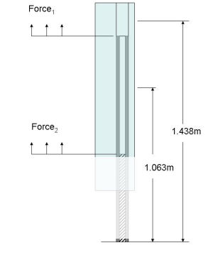

Here are two examples to better illustrate my point. Let's get some useful information from all these formulas! Finally.
Lets say you want to answer two questions of interest. what is the force on the aluminum extrusion that is totally unsupported at the tip and what is the force on the tube right where the solid bar ends. These are the highest stress positions in the design.
Here is a diagram once again of Phill's proposed design as he stated it.
I am leaving out some of the math regarding areas/densities/and mass calculations of the components, no need to type in all the basic stuff. It's all in there though.
1.) Calculate the forces on the unsupported tip. I call this F1 in the diagram
The outboard tip portion has a mass of .437kg. It's center point is 1.438m from the hub center.
F1 = M*R*w^2 = (.437kg)(1.438m)(104.7 rad/sec)^2
F1 = 6888 Newtons = 1548 lbf
So now we know that the unsupported tip will will be pulled with 1548 pounds of force right where the hollow tube ends. Hope it's tensile strength is good.
2.) Determine forces outboard of the solid rod.
This is a little different because you now have a compound system and the masses and radii for the different materials have to be accounted for. Using the methodology in the above post we find;
Mt = mass of tube outboard of solid rod = .552kg
Rt = radius of center of outboard tube section to the hub center
Mb = mass of blade outboard of solid rod = 1.313kg
Rb = radius of center of outboard blade section to the hub center
To determine the center of mass of the outboard section we have;
R = (.552kg*.875m + 1.313kg*1.063m) / (.552kg + 1.313kg)
R = 1.007m
Now calculate the force. I call it F2 in the diagram. (total mass of this system is 1.865kg)
F2 = (1.865kg)(1.007m)(104.7 rad/sec)^2
F2 = 20587 Newtons = 4626 lbf
This is interesting because after the stub, or solid rod, ends the blade from that point onward is supported only by the tube. It has a very small area and since we know that;
stress = force/area
we can calculate the tensile stress in the tube due to centripetal forces to be 223 Mpa. Over half way to it's yield point and we haven't even added in any of the more complex forces yet like gyro and bending.
So from these two posts I think we have learned the following. Pretty important information if you are designing this particular system
1.) The entire blade assembly will be pulled away from the hub with 6142 pounds of force - design hub appropriately
2.) The plug welds will have 5175 pound of shear force exerted on them - design your welds accordingly
3.) Forces will try to pull the blade off the tube with 3775 pounds of force - choose your epoxy or fastening means appropriately.
4.) The blade extrusion must be able to handle 1548 pounds of tensile pull or the unsupported tips will shed.
5.) The tubing will be subjected to 4626 pounds of tensile force at it's weakest point, just outboard of the rod - a good place to look for improvements in the design
