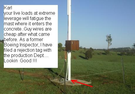

Posted: 11:50pm 18 Feb 2010
Good post Anthony.
Are there any guy wires on the tower?
KarlJ
Joined: 19/05/2008
Posts: 1178
Posted: 02:53am 19 Feb 2010
Nope, no guy wires whatsoever and shes pretty solid to boot.
Had to be cow proof and short of fencing off 1/2 an acre for the guy ropes this was the only way.
Cost is similar but we are a couple of metres shorter than a similarly priced guyed tower.
The 3m3 of concrete was almost $500 and the pole (which is crap BTW) is a total of 6.75m tall $840 made of 5" Bore casing 5.65m bottom section and top section about 3.5m with an overlap of ~900mm plus the mount ontop for the turbine to sit in.

Greenbelt
Joined: 11/01/2009
Posts: 566
Posted: 04:08am 19 Feb 2010
KarlJ
Joined: 19/05/2008
Posts: 1178
Posted: 04:36am 19 Feb 2010
Thats why I bought it from eastcoast green energy.
They reckon she's engineer certified with upto 2KW mill ontop.
With supporting engineering I must assume he's calculated for a decent life.
I do agree that the loads there would be decent, call it 60KG load at distance of 6.6m =3880nm of torque being applied here, that said, 5" bore casing is HEAVY stuff though being mild steel will deal with fatigue well.
To be honest I'm more worried about the welded joint half way up the top mast, it has the welded on triangles for support but the welding is woeful quality.
BTW now seen over 700W and we're only on day two!
12.5A at 57V
BTW Greenbelt are you taking the piss being a Boeing Inspector? I used to do that!Edited by KarlJ 2010-02-20

Karl,
My first tower was like that one pictured and it was installed right next to my shed which is only a 1/3rd of the way up the hill. One morning I looked up to the shed to see the top section of the tower bent about 45 degrees. It was 2" rural grade water pipe too. As other guys have said get some guys on there quickly just below the blades or be prepared to show the pic's of the bent tower....

Karl , The preceding post was Meant to be a heads up
that could possibly save your mill. 120 pounds jerking and thumping around with gyro forces many many times in the course of a year will harden the steel until it becomes brittle and then break like glass, should keep the flexing at minimum near the base. Stop by for a Beer and we'll talk about the rejection tag.
. EDIT; I had not read your latest post Good luck in Perth.Edited by Greenbelt 2010-02-20
