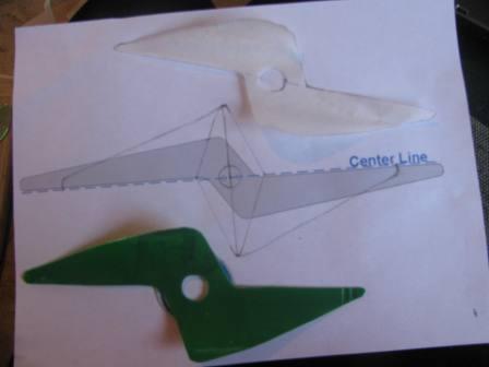

neil0mac
Joined: 26/12/2009
Posts: 210
Posted: 10:41am 27 Feb 2010
  Downwind said   Hi Gaby,
Because the air flow off a fan is very turbulent this effects startup greatly.
Also the position of the mill to the fan makes a big difference to.
Do you see here what i mean about the centre line needs to be flat with the disc as i am using 2 pegs to clamp the disc to the blade for gluing.(pegs right on the very edge)
Hmm. Here's me thinking (guessing?) that a piece of plastic with a steep(er) pitch right neaqr the centre hole would assist with the starting torque problem. Probably the height of it could be detriniental to the final RPM, though. Perhaps there is a happy middle solution?
A further thought about attaching the blades. in stead of used a 'bolt' drill holes on the blade(s) and CD and use Araldite (epoxy resin) like a 'rivet'?
Downwind
Joined: 09/09/2009
Posts: 2333
Posted: 10:56am 27 Feb 2010
neil0mac
Im all ears on your thoughts.
1. i dont know what you mean exactly.
2. remember a 14 year old student on the other side of the world needs to be able to build this with limited resources.
I found 4 dobs of hot glue was more than enough to hold it all together in even high winds.
All up this will need to run for no more than 15 minutes on the day compared to a life time in the wind.
Good to see you are happy to lend some thought to help the young lady out.
Pete.

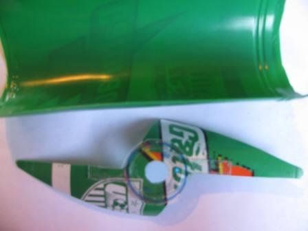

gabymuino
Joined: 25/02/2010
Posts: 26
Posted: 03:26pm 27 Feb 2010
Good morning guys…
You’re put me crazy with all these concepts and terminology.
But, “THANKS” I’m learning a lot!!!
I’m just waiting for my mom to take me to the store to buy the PVC pipe.
Meanwhile, I made a try with a plastic water bottle. The result was great I got in the high speed almost 0.7 Volts!!! that is more than on the Nationals last year score. But I still having trouble on the low speed, I don’t know what is going on, probably is my fan that is to old or the generator has to much movement.
I have couple of questions… probably you already told me. Which size is your blade? The one that I made is 20cm… Probably that is one of the reason that doesn’t work in low speed and the other is the material. Do I use the maximum size permitted that is 24cm?
What do you think?
Please comment my pictures.
Gaby Muino

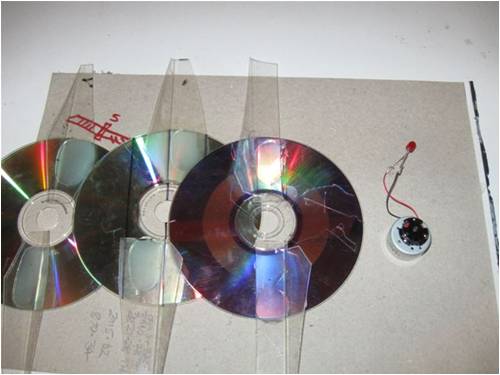

turnymf
Joined: 04/10/2008
Posts: 84
Posted: 03:45pm 27 Feb 2010
Ok
Had a old ps1( busted) and fitted the cd grabber thingy to a sled motor off a old cdrom
Found a scrap of laserlite, only had trimdeck profile
Cut it out with scissors and hot glued
I made 3 sets, each looking better and more balanced as I went
They all lite the led when put in front of a big fan They performed( according to led brightness) in this pix worse futher from the motor, which the order they were made
Probably a error on my part
Easy to see why the comp has a max diameter of 24cm with no metal
Good luck with it Gaby
Just make lots of models until you find resonance
cheers

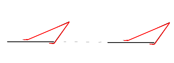

neil0mac
Joined: 26/12/2009
Posts: 210
Posted: 09:14pm 27 Feb 2010
  Downwind said   neil0mac
SOMETHING LIKE THIS ....
I found 4 dobs of hot glue was more than enough to hold it all together in even high winds. (If he has access to one!)
Pete.
Edited by neil0mac 2010-03-01

Ok. Now you have a pic!
I'll test you with this one!
I did consider suggesting that you could use two of those additions in each half of the blade - with a suitable hole (between them) through the blade and the CD. Could possibly give more torque without increasing the resistance at higher revs, meaning you could reduce the height of the add-ons a bit. (It is a reduced version of a PC fan.)
Certainly your wider (green) blade could probably be done this way.
(If I can mystify 'Downwind', I can mystify anyone?Edited by neil0mac 2010-03-01

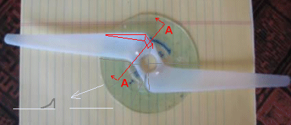

neil0mac
Joined: 26/12/2009
Posts: 210
Posted: 10:10pm 27 Feb 2010
Here is the idea improved a bit.
Instead of the wide flat section (uselss bulk that creates 'inertia' (the resistance to being moved) in the centre of your blade, use the same amount of plastic to give the 'aerofoil effect' and strengthen the blade at the same time = lighter, stronger, better.
How far you extend these from the centre will be a matter of trial and error. Also, the shape of the leading edge can be altered in any way you fancy. Probably a straight taper as per my inital diagram can be improved greatly!
Ok, so I attached them to the leading edge - not the trailing edge! Swap them around and make them the full width of the hub area.
(Aren't 'we Aussies' good at wasting other people's time (constructively, we hope!).)Edited by neil0mac 2010-03-01

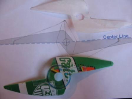

gabymuino
Joined: 25/02/2010
Posts: 26
Posted: 10:38pm 27 Feb 2010
You're not wasting my time!!!!
"Aussie" people are the most incredible people I never met for help
I never thought before that I could have help from far away...Can you imagine...from Australia!!!!.
I still don’t get it.
Are you saying that my first try can improve the starting of the blade.
Now the green one is pretty good but I’m having trouble with the low speed. The score is going to be based on the sum of the low speed and the high speed.
Gaby Muino
neil0mac
Joined: 26/12/2009
Posts: 210
Posted: 11:45pm 27 Feb 2010
What I am getting at, is increasing the torque (turning power) by using a greater pitch near the hub - the last suggestion was utilising the green one, but with an additional hole through each blade to allow:
a) increased air flow (less flat area to cause resistance which means that less (none?) of the energy from the fan is wasted in pushing air sideways (at right angles to the motor axle, if you like) without moving anything.
b) make the blades more rigid so that they can be effectively 'narrower' at the same time.
Is that any clearer?
