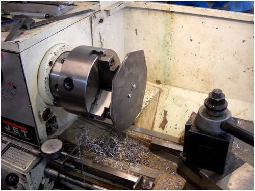

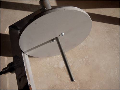

June 6, 2010 Update

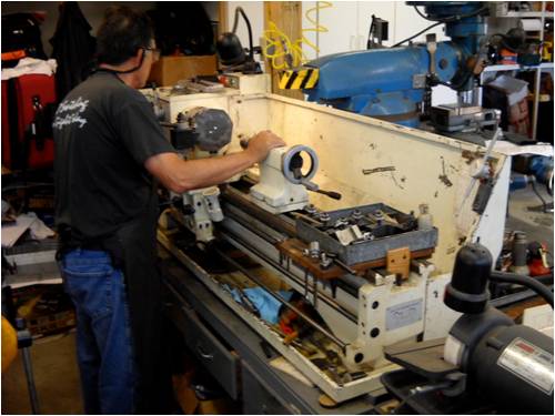

I've been at it again. This time, I had to walk up the street and around the corner to my friend Dan's garage shed. He has a way bigger lathe and he let me use it to cut the soft-iron magnet flux-backing plates for the ax-fx.
This is as far as I got yesterday. I used my high-speed grinder and cut
the 5/32 mild steel plate as round as I could get it.

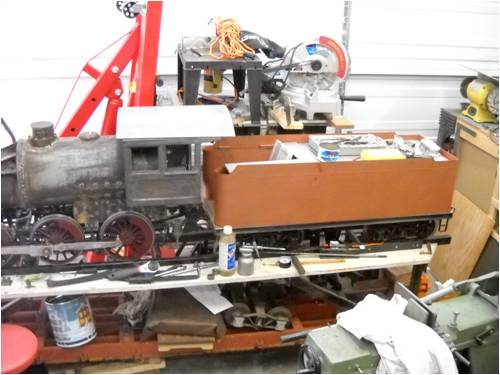

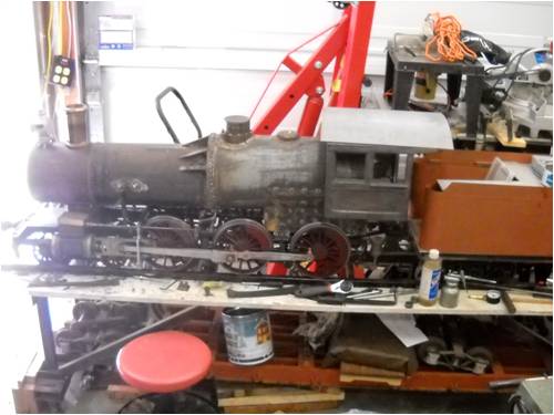

This is my friend, Dan Williams. He builds scale steam trains in his
garage shed. He's standing in front of his lathe.

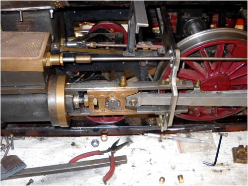

Here's what Dan builds. This is the steam locomotive and it weighs
600 pounds easily. This represents over 1,000 hours of work and it's
not finished yet.
Here's a shot of one double-acting steam engine. There's one on each
side of the locomotive. Note the exquisite detail of this build. Dan is
an excellent machinist; many hours of practice!
Here's the tender. It holds water and fuel oil (for the boiler) as well
as providing a place for Dan to sit and run the thing. When it's done,
it'll pull 20 or more cars with seats for people to ride around about a
1-mile scale track in a local park. Nice work Dan!

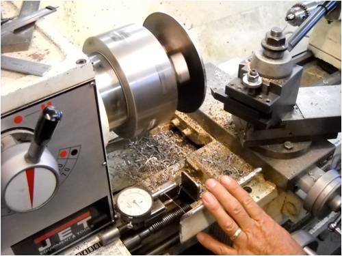

Here's a shot of the lathe. It's easily 5 times larger than my little toy.

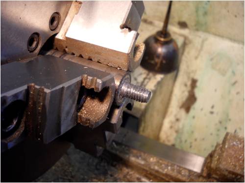

This is a shot of the "mandrel" Dan made to hold the iron pates. It is
made of cold-rolled steel round bar. A 5/16" shank was cut to fit my
pre-drilled plates. It was then threaded and a washer and nut hold the
plates to the lathe as it spins.
This is a shot of the bare plate chucked up in the lathe as we begin to
trim it down to size. At this point, we were using an aluminum mandrel
I made on my lathe, but as it turned out, it spun in his chuck, so a
new mandrel was fashioned to finish this job. That's the way it goes;
sometimes you spend your time fabricating tools. It's just the way it is.
Here's one plate done. Note the micrometer Dan attached to the lathe
bed ways. That lets him zero in on a cut; way cool!

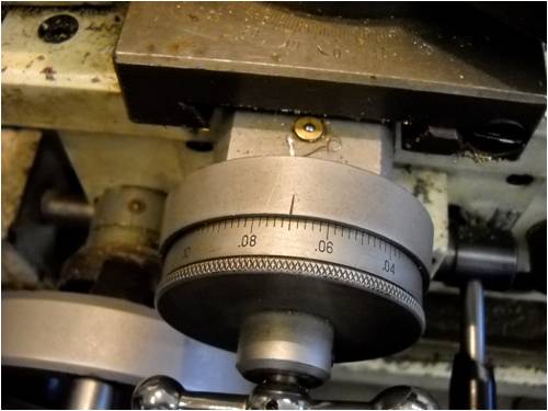

For those who don't own a lathe, this is the feed knob on the cross-slide.
The cross slide feeds the cutting bit across the face of the work. Each
little tick in the wheel = .002" and that's how we get things to fit so well.

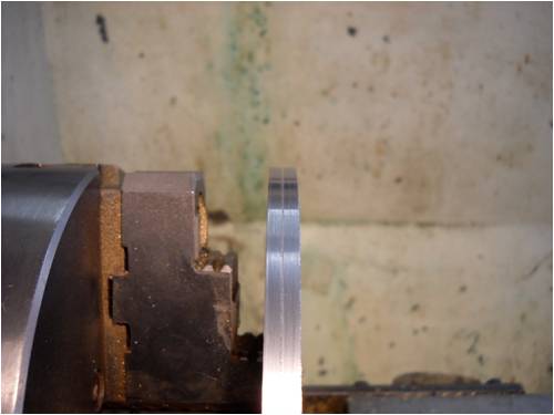

This shows the final cut. Both backing plates were mounted and cut
together. This holds the work "true" as well as assures each plate is
"exactly" the same size as the other. As the work spun, I trimmed the
outboard edge using a carbide cutter in the tool holder.

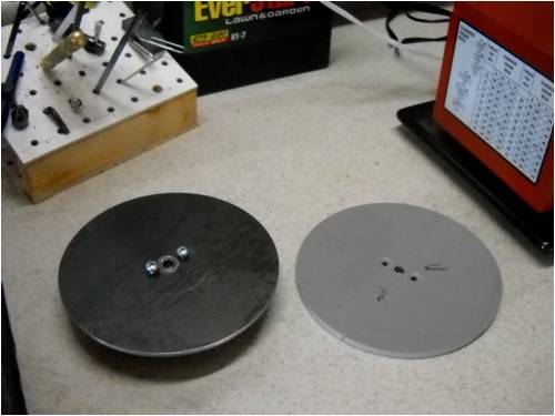

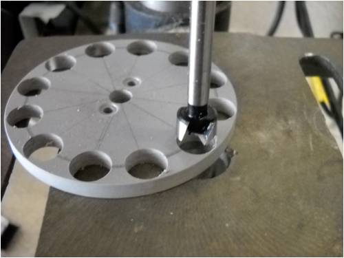

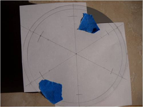

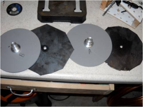

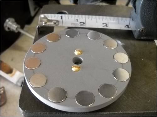

This part of the build concerns the magnet wheels, which are the key to the axial-flux design.

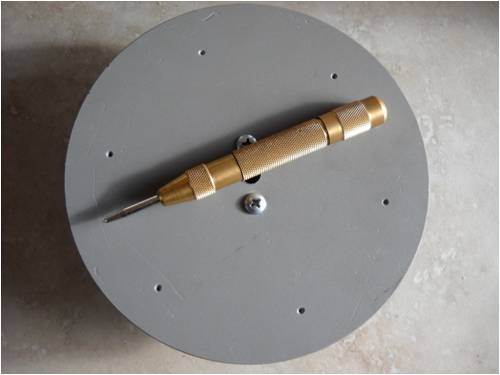

This shows how I laid out the plastic wheels, which will act as guards
keeping the magnets from flying off the iron wheel. With such a small
mill, this is unlikely, still, it never hurts to think ahead a bit. First, I used
my 2nd favorite tool (my compass) to lay out where the 6 magnet holes
should be placed. I taped my template to each wheel and marked the
centers with a punch. Easy Pete; my 1st favorite tool is my lathe!!
I should mention here that the way "I" am building this contraption does not conform with the standard build. For instance, these plastic wheels. Nobody else does this, but I was trying to get my head around how the magnets stay in their respective places, being attracted to their opposite face just across the air gap housing the stator as well as the iron plate they're attached to as a "flux-return" path, not to mention centripital force as they spin and just couldn't grasp the idea, so I came up with this little method of trapping them in a plastic "cage" the same thickness as the magnets themselves.
This method of mounting the magnets will also make it look less dangerous (to me at least) when things are whirring past the stator. The "regular" method makes it look like a saw blade to me, so I decided to be different, that's all.
Here's a virgin plastic wheel mounted to the iron plate and each mounted
to the shaft of the windmill using a set screw.
This shows the punch I used to mark the holes in their proper places,
each on one of the 6 lines I drew on using my compass.

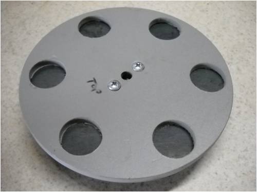

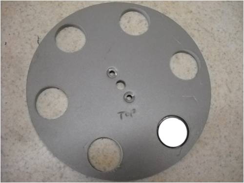

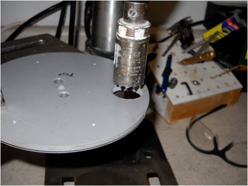

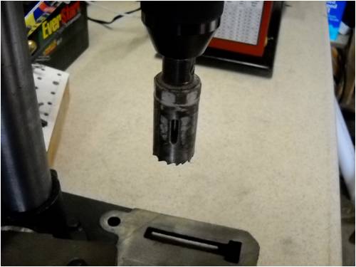

This 1" hole saw actually cut the holes too large, but it was the best I
could do. I used my drill press to carve out the holes.
This shows one hole cut; 11 more to go.
Here's all 6 holes cut in one plate with one 1" neo-magnet inserted
as things lie on my workbench.
This is one plastic plate mounted to its iron plate awaiting magnet
placement.

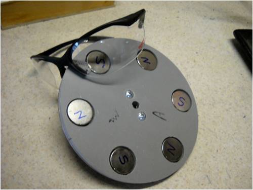

I threw in this shot to remind everyone that if you build stuff, then
take it apart to work on it, you must mark sides and positions, so
when it goes back together, everything is in the right spot.
I'm showing my shooting glasses (safety glasses) here to emphasize
that working with neo-magnets is DANGEROUS. If they snap together,
they can splinter and send shards clean through your eye! Wear
safety goggles for crying out loud!

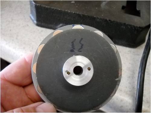

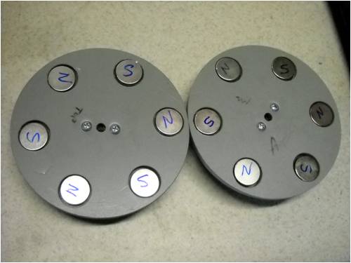

Here are both little wheels with magnets loaded. I have to remove
them tomorrow and put a drop of epoxy glue under each one, but I
stuck things together this evening for a "Kodak Moment". I hope I
can get things apart in the morning!

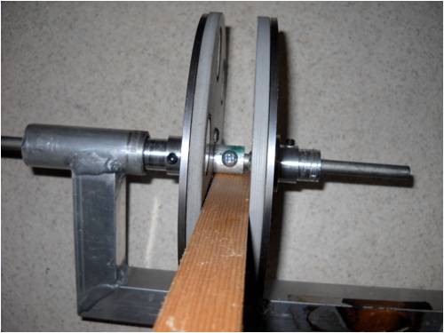

Morning After Pics

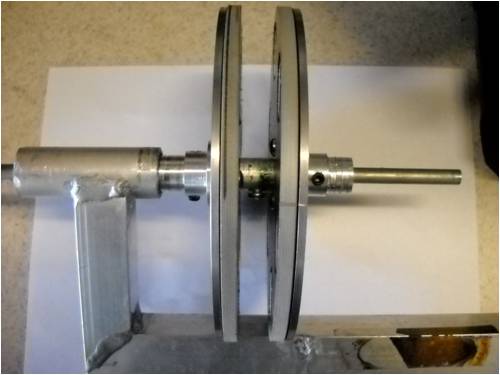

"Morning has bro .. .. .. ken; like the first mo .. .. .. o .. .. .. or .. .. .. ning". Remember that guy, Cat Stevens?
Anyway, it's Sunday morning here and I pushed the two magnet wheels together after first fashioning a small aluminum spacer thingy (with a set screw, but now I don't know what I was thinking nor why I took the time to do that set-screw part) so they wouldn't get permanently stuck together and here's what it looks like:
The cautious side of me said, "Put something stiff but kinda soft between
things before these two things get out of hand as they get closer and
closer to each other." I chose a 1 x 3 pine board. No Pete; don't add
any commentary!
Here they are side by side. Turns out they are so strongly attracted to
each other, the shaft set screws are likely over-kill.

....... 9 coils for 6 magnets....... did you do the geometry on this first?
If you go ahead with this, make sure you can remove the magnets. I suspect it will work with 6 per disk... In the N-S-N-S-N-S you have currently, you will have only 6 poles.
The output should be about half the normal axial, as you only have 1/2 the magnet mass I guess, and you don't have an opposing pole moving over the same coil, as you would in a normal 12:9 arrangement, so you miss out on half the voltage in each coil.
In the normal version, as the N cuts the left leg of a coil and generates an EMF, the S will cut the other leg of the same coil and induce an EMF of opposite sign, giving double the EMF that you will get per coil. Do you see it now?
Thats why we use 3:4 ratio for the 3 phase AXFX
..........oztules
EDIT: The magnets look lonely in the current configuration, but will look crowded if you add the other 6 per disk. The crowded one will still work pretty well, but ideally 1/2 magnet width is as close as we want to get from magnet to magnet if we want a decent airgap.
If you narrow the airgap a little, it will allow for closer magnet spacing with out too much inter magnet leakage.....but you start to suffer winding space loss.... it's a balancing act.
Try to get 12 per plate if you can.
Idle thought:
It should still work well if you make 1 plate all N-N-N-N-N-N and the other all S-S-S-S-S-S. This will give you 6 phantom poles for a 12 pole total using 6 magnets/disk as you currently have.
I have not tried this, but would be interested to see if there was any gain by doing this, rather than the N-S-N-S-N-S you have now.
Just a thought
Edited by oztules 2010-06-22

Aaargh!
Color me stupid, but I actually counted the (9) coils and what I thought were 6 pairs (12 each) of magnets in that little gif you sent along. So, given that much information, I went ahead and built it like I did in the pictures I've posted.
I also did some monkeying around with my compass and made a template with 9 places to mount the (little) coils, so, yes, I actually did do my homework on this (I thought!).
If it's wrong, it's wrong. It's too expensive to use as a fishing weight, so it'll just have to light half a light bulb or something, I guess.
Like I've said elsewhere here, if it don't work, it'll make a dandy story to tell. I'm one of those simpletons who sees the light at the end of the tunnel and smiles, thinking it's the other side and not even thinking for one moment that it might be a train coming!
Edit: Okay . . . . well, I've just been informed by PM that I blew it. If this thing works as all it'll be a miracle, so for those watching, maybe wait till it's all done before following my lead, eh?
Please excuse me for a moment while I go pound my head against the wall! Just kidding; I wouldn't do that for any reason I can think of, really.
. . . . . Mac Edited by MacGyver 2010-06-22

[Quote=oztules]Idle thought:
And who would like to volunteer to pry all those magnets off the thing?
Nah, I think I'll go with what I've built and if it doesn't do squat, then I'll rip it apart and do the all north opposite all south thing.
Suddenly, I'm really looking forward to building one of my "experimental" models. At least doing that I will be going into it virtually knowing it likely won't work and won't be disappointed having had the illusion it will work only to find out it doesn't.

oztules
Joined: 26/07/2007
Posts: 1686
Posted: 07:25am 21 Jun 2010
It will still be a good little alternator..... just the coils will need to be twice as many turns as they would have been if you had 12 mags/disk.
With your little blades, it may still be way to powerful for it even with 6 mags/disk, you may actually get a better match with the higher resistance stator at lower power levels.
If it is still to powerful for the blades, you can at least open the air gap up till you find the best match.
.............oztules

Posted: 07:59am 22 Jun 2010
Above I said:
[quote]In the normal version, as the N cuts the left leg of a coil and generates an EMF, the S will cut the other leg of the same coil and induce an EMF of opposite sign, giving double the EMF that you will get per coil. Do you see it now? [/quote]
A correction is in order.
This is not quite how it works, and should be clarified. The net result is the same, but it is not from generating an opposite sign, it is from having an EMF of the same sign in opposite legs adding...... sometimes it pays to read what you write..
Sorry for that.

Update July 1, 2010
There's been a slight change in plans. Because of my limited machining capabilities, I chose to use an "off-the-shelf" die-cut piece of iron plate as my magnet-backing plate. Unfortunately, in a "perfect world" it should have been about 1/8th inch larger in diameter, but I think it will work just the same.
I drilled 1/2" holes in the sheet of HDPE plastic using a "Forstner" bit.
These holes hold the individual magnets and the sheet is almost the
same size as the magnets' thickness. It makes placing the magnets
way easy. All you do is choose the correct face alignment and slide
each magnet across the plastic until it snaps into the hole in the
plastic sheet, which is mounted to the iron magnet-backing plate.
Next, I loaded each of 12 individual rare-earth magnets into the holes,
alternating the faces N-S-N etc. all the way around the circle.
Here's a shot from the back side of one magnet wheel. Note the edges
of the magnets stick over the side of the iron plate just a little. Oil well,
can't win 'em all, I guess. I'm sure it will work just the same.
As soon as my latest order of magnets arrives, I'll place the other 12 magnets into the other wheel and mount things into the running gear of the windmill. All that'll be left to do (more or less) is to manufacture the stator using 9 coils of wire, placed equally about the circumference of the wheels. The stator will be mounted between each of the magnet-holding wheels, bolted to the frame of the windmill so the magnet wheels can rotate freely about it on each side. As the concentrated flux areas between each N-S or S-N pair of magnets passes over the wires in the stator, a voltage as well as a current will be induced into each. The stator will have three sets of 3 coils (each wired in series to form one set), which will allow it to produce 3-phase a.c.
I'll be back with more when it happens. Until then, the stuff I posted using 6 magnets on each disk is all good, except for the fact that I botched up, misunderstanding there are actually 12 magnets instead of 6, but the basics are all good. Might be a good thing to review the entire thread, if you're new to all this. Heck, it might do me good to do the same!
. . . . . Mac
