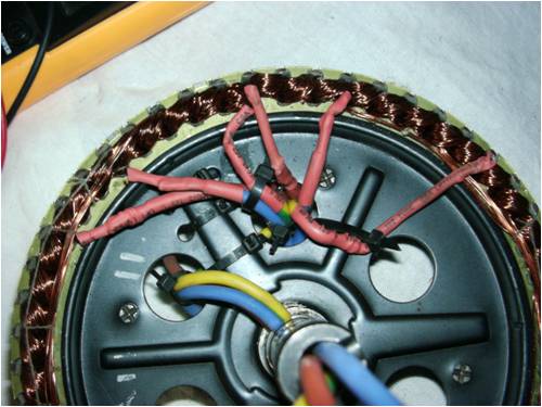

It looks to me like a shorting switch at high rpm damage, as it had caused power related damage to everything, its a bit of a chicken and egg situation, but if it was shorted at to high rpm it wouldn't stop due to wind energy and blade inertia.

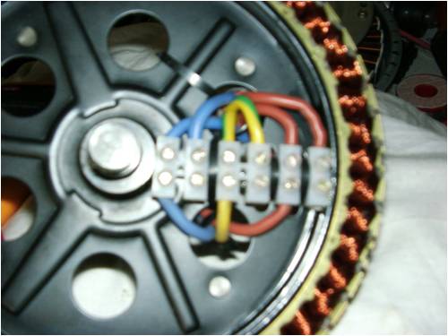

how many windings per phase?, is it connected star(wye) or delta?
VK4AYQ
Joined: 02/12/2009
Posts: 2539
Posted: 07:52am 28 Oct 2010
Hi VAWTWINDY
They are connected in STAR as original, here is a photo of mine reconfigured as Phill suggested so the terminals are under the front cover so all thats required is to remove the front to have access to the windings.
access
The termination of the windings is on the rear side of the stator, these wires are lengthened and fed through the holes in the stator to the front to the terminal block so they can configured as star or delta as required.
I think from memory there are sixty coils wound five wires in hand.

I have tried turning my mill with the windings shorted out and it has a lot more resistance than quoted in Altons blade stall to rotation requirement, so if it was stopped before the heavy wind event I can't see it winding up again. The totally stalled blades would generate very little torque.
If you look at the damage to the windings in the photo you will see that one or two windings suffered the highest current and overheated badly, it makes me wonder if that one phase somehow shorted out during the application of the shorting brake and the heat generated by this event was the main cause of the damage.
I have now modified mine to try to solve the problem and will post some photos once it is finished.

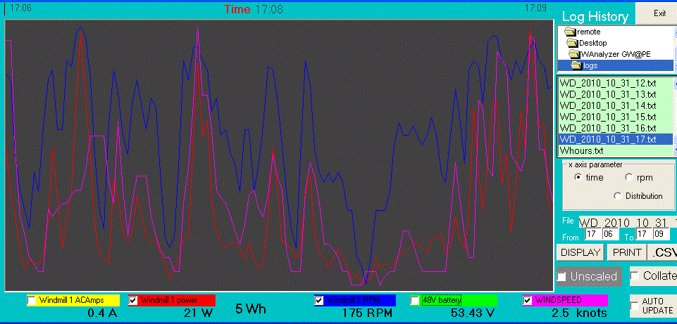

here is a graph of a few minutes logging of my mill at 2 sec intervals. I think an electronic controlled actuator for furling based on rpm will wear out quite quickly.
Dampening the system will negate the furling benefit.
Gordon.
become more energy aware
VK4AYQ
Joined: 02/12/2009
Posts: 2539
Posted: 07:53am 31 Oct 2010
Hi Gordon
I see what you mean, the rpm is all over the place, looks like I will have to go back to the high voltage fixed maximum amps Idea, as its the amps thats doing the damage on extended power intervals. If I set the maximum amps at 40 amps that should be sustainable within the design of the generator and let the volts climb then down switch to 27-6 volts for the total power.
The furling is also critical to prevent a full runaway.
