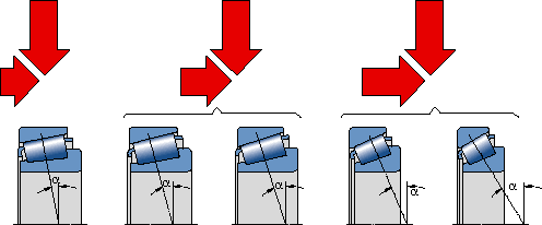

Sorry Ross, but I must disagree that taper rollers are a type of angular contact bearing, I have started a new post with some explanation and diagram of an angular contact if anyone is interested

Design features
Tapered roller bearings have tapered inner and outer ring raceways between which tapered rollers are arranged. The projection lines of all the tapered surfaces meet at a common point on the bearing axis. Their design makes tapered roller bearings particularly suitable for the accommodation of combined (radial and axial) loads. The axial load carrying capacity of the bearings is largely determined by the "CONTACT ANGLE" á (fig); the larger á, the higher the axial load carrying capacity (fig). An indication of the angle size is given by the calculation factor e; the larger the value of e, the larger the contact angle and the greater the suitability of the bearing for carrying axial loads.
Angular contact tapered roller bearings and it's Poss...

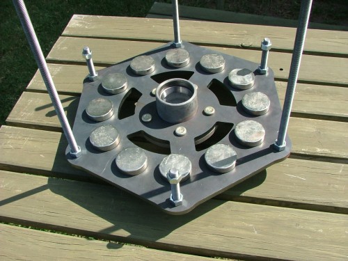

They are 50mm dia by 12m thick ( 2 inch by half inch ). I have to say, these things are dangerous to handle, you need to think about every move you make.

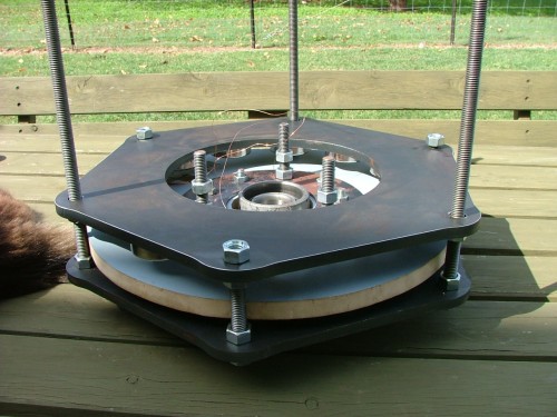

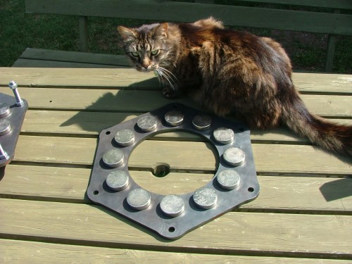

OK, some more progress today. I temporarily fitted the magnets to the front and rear magnet plate. Those magnets are a tough little buggers to handle, its a constant fight to get them onto the plate without loosing a finger, but once there, they can be easily slid into position.
This is the rear magnet plate, with Bogie in the background. Bogie likes to play in the rain and chase dogs, go figure.

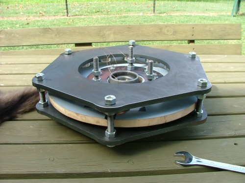

Next we see the front magnet plate, with jacking screws fitted. The jacking screws are about 300mm long, a bit overboard but better to play it safe.

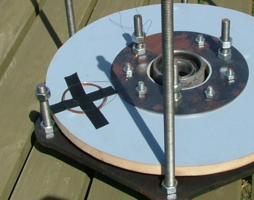

I wound a test coil, 10 turns, and taped it to the dummy stator. The stator is in position on top of the front magnet plate.

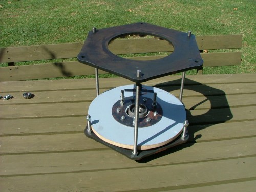

Here it the rear magnet plate in position ready to be lowered down. I found I could turn the nuts by hand till the rear plate was about 150mm from the front plate, when the magnet force was starting to really kick in.
The rear plate is almost home, enough to engage the 3 other spacer threads.
Once I could fit the nuts to the spacer threads, the alternator was safe and I replaced the jacking threads with the 3 remaining spacer threads. The alternator can now be fitted to the windmill for final adjustment.

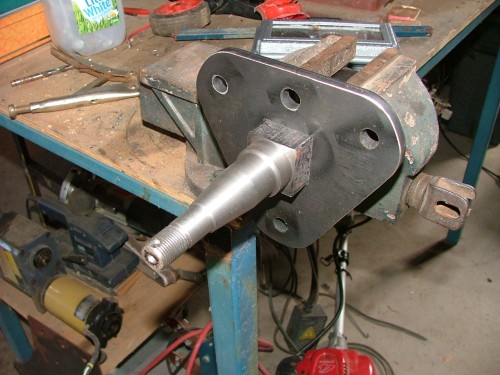

Here's the stub axle and stator positioning plate. Once the windmill is completed, this is what we have when the alternator is removed.
Ready for testing.

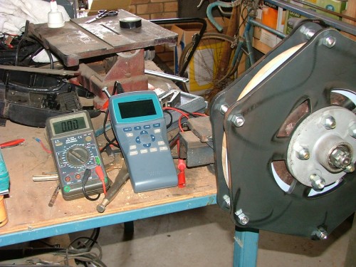

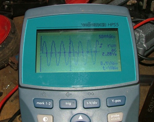

I have a small hand held CRO which can display the peak voltage and waveform as I spin the alternator. I used my camera to take photos of the screen as I spun the alternator. By taking photos I get time to read the scale and work out the sine wave duration, and with a bit of maths calculate the RPM.
This is what I ended up for my 10 turn test coil. Magnet spacing was 20mm.
Volts RPM
1.63 95
1.72 100
2.28 133
Now I start some research to find the best blade diameter, tsr, and coil count to suit this alternator.
