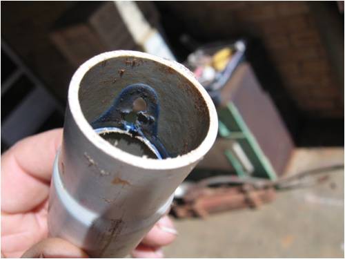

Just out of curiosity, why did you choose a method that involves many joins in the poly pipe? All these look to me potential leak sources.
Would it not be equally efficient to lay the pipe in a spiral fashion, like a very long coil spring, and weave that through the trenches? The trenches look deep enough to be then back filled with sand to cover the pipes before the coarse fill.

Hi Tinker,
The following is from a previous post about 5 back.

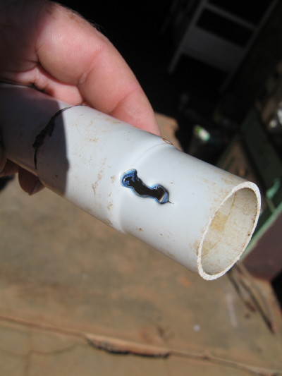

I had some ABS pipe laying around that was intended to be a part of my septic Tank system drain field (County Building Codes Require a pressure system for liquid distribution). I bought the ABS for this but County said Code specifies PVC. So now it becomes a part of my system, I realize the wall thickness will hinder the conduction of heat but it has the advantage of a large surface area. I figured the extra water (11 Gallons US.) more than the original system 91.3 pounds can store 1640 usable BTU. When the heat is turned down at night.
I guess the real answer is, It was cheap.
I see on the Internet lots of negative hype on PVC. and ABS pipe, I have hooked several
with the teeth on the Hoe and find that they are much tougher than one would expect.
You also would not expect a PVC pipe to actually bend,(Not Flex),but Bend before breaking, and when they do break it is usually at a join but it is not the cement bond that gives up, The fitting splits along its length and the pipe breaks at the point where it enters the fitting.
Leaky joints are caused by moisture or bonded at low ambient temp. and old jellied Cement. I;ll take a Photo tomorrow ( Dark Now) of a couple pipes I hooked with the Hoe
to show the torture they can take. I appreciate your interest. Cheers....Roe

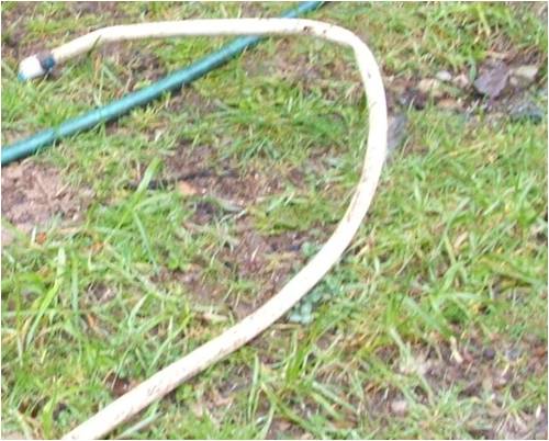

Bent by force,not heat. PVC Pipe ripped from the ground on the teeth of a backhoe.
Edited by Greenbelt 2011-04-06

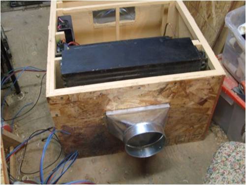

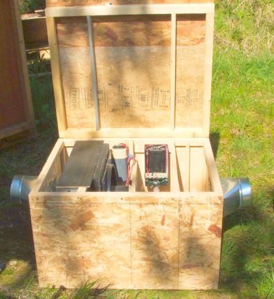

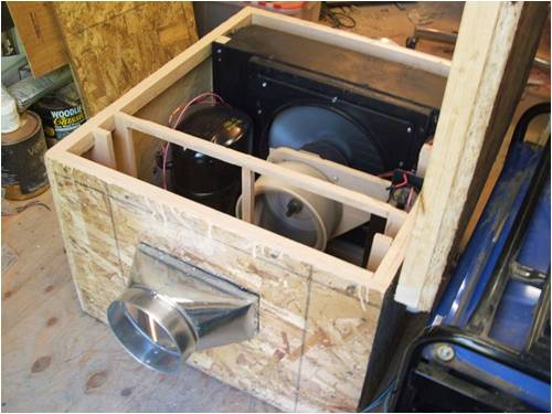

Greenbelt
Joined: 11/01/2009
Posts: 566
Posted: 05:08am 23 Apr 2011

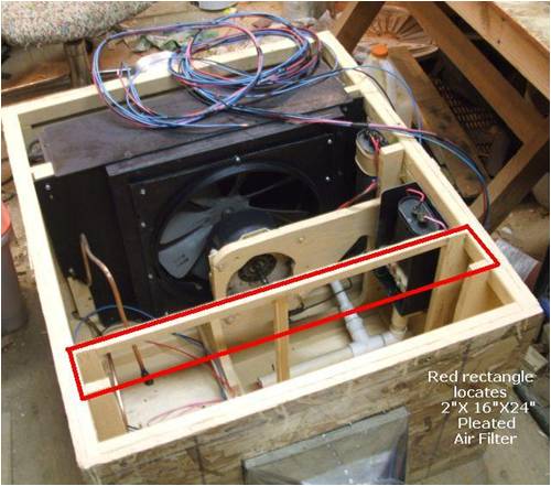

Some more Show and Tell,

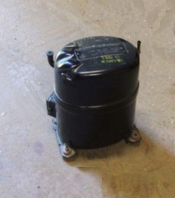

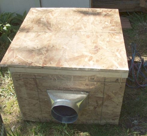

I have built the container box for the Condenser and Compressor, this is also the air handler and filter.
A couple of Pic's now and more shortly.
This is it, No Top yet, Top must be built, Bug and Spider Tight, Wife goes into orbit when a spider shows up.
The 220 volt fan motor requires a running cap. so I used the double unit that came with
the air conditioner. My new compressor needs a higher value than the double unit provides so I installed another salvaged from a different unit.
I mentioned this new compressor in an earlier post, It is only 14 years old, I've been moving it from place to place with the thought that I would build something, Only When was Unknown. It is not installed yet. The refrigerant is not in the Budget at this time.
Cheers---Roe

Whole-heartedly agree with you on the quality of PVC as a material, but glueing a joint requires both skill and practice to get it perfect. Always best to get someone to teach us the basics and have a practice with some offcuts and joiners, before tackling the first big job.
HOT TIPS
Don't be a tightarse use plenty of primer.
Don't buy and/or use old glue (it will be too thick to spread thin and evenly).
Chamfer any cut ends(I use the back of a hacksaw blade or my thumbnail).
Hold the joint together until the glue grips and holds.
Don't flex the join to much while it is still soft.
This is the big rookie mistake, over-glueing the inside surface, you can't wipe it off inside the pipe. The glue melts the single thickness of PVC, causing a band of low strength next to the join.Although this one still lasted for 25 years at 170 PSI.

" This is the big rookie mistake, over-glueing the inside surface, you can't wipe it off inside the pipe. The glue melts the single thickness of PVC, causing a band of low strength next to the join.Although this one still lasted for 25 years at 170 PSI."
yahoo2,
Good advice, The swab on the cap of the cement can, is always 3 times larger than the
Inside diameter of the pipe, that puts the squeeze on which causes excessive cement to
be placed inside. a messy wasteful way of selling more glue.

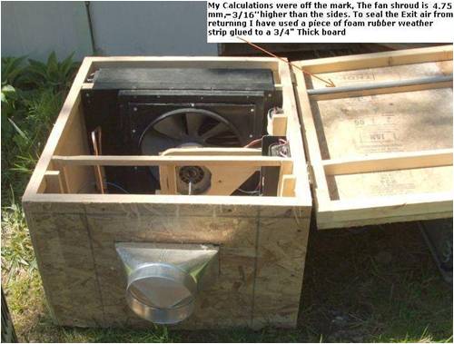

Greenbelt
Joined: 11/01/2009
Posts: 566
Posted: 06:01am 25 Apr 2011
Another update;
It now Has a Top, Minus the Spider Gasket.
I've been thinking about using a thin foam for this very important detail.
When I Bolted the timber to the concrete Footing of my house I used a condensation
barrier to isolate the 2X6 wall plate I will use it to keep the bugs out.
I placed the compressor where it belongs, NOT Connected, Checked the Fan for Vibration and discovered that the rotor was bouncing against the thrust Washers Axially about Twice a second. I thought perhaps the balance adjustment may be in the Squirrel cage Wheel So I installed it for effects. It did the job, I don't know if it was more load, Flywheel effect, OR?.
Moving Machinery is more Photogenic than words in a Paragraph.
With the top closed the noise level is near a whisper, when I get it all covered with Insulation I doubt we Could hear it at all in the House, Just hope the Compressor is a quiet one , it does have Rubber Motor Mounts.
Cheers---

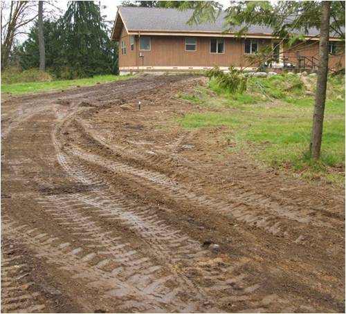

Greenbelt
Joined: 11/01/2009
Posts: 566
Posted: 06:52am 25 Apr 2011

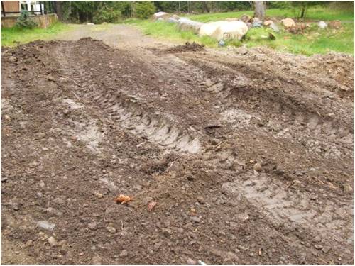

I filled the Trench, bedded the pipe in Local Clay and very carefully covered the pipe with a foot of fine texture Gravel and Clay. The stony stuff was put in last. Fingers
Crossed, we Had 2 Days of sun so yesterday I went to work on it. Still to wet to clean up and back drag. buts looks Better.
Couple of soft spots Remain.
And its Raining again.
Cheers---

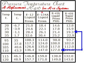

Posted: 05:12am 05 May 2011
To all
I have a correction to make here;
The post dtd; March 6, 2011 has an error.
The statement in Italics is not correct.
Note, " Blind to the Obvious" I discovered that some of the numbers in this Press-Temp chart for R-12 (Yellow Box) seem to have been put in the wrong box , (reversed) the vapor pressure should be lower than liquid pressure, makes one wonder if the any of the numbers are correct. Of the many errors in this post, this one came AS IS.
The data I thought was intended for R-12 Vapor pressure was actually the condensing pressure data for R-134A as shown below.
I apologize for my insensitive remark toward the company that markets this product.
-----Roe
