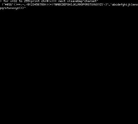

Interesting discovery:
While on the subject of screen codes, I typed the following line into the Maximite using its attached PS/2 keyboard:
FOR X=32 to 255: PRINT CHR$(X);:NEXT X
On the VGA monitor, I get one line starting with the space, and ending with the ~ character. On the PC screen (using TeraTerm) I get two lines, the second has the extended codes such as line drawing, accents and the like.
Strange behaviour. Why the discrepancy, I wonder?

Bob,
I think you will find the VGA does 2 lines but all of the chrs from 127 to 255 are BLANK and not defined... Tera Term presumably has standard IBM codes for those Chars.
Mik

Mik,
No, the VGA monitor only prints one line, no blanks, just no output at all.
here's a screen shot:

Yeah thats normal. The Maximite doesn't know how to draw the characters after 126 (~), so you see blanks. They are there, you just dont see them, cause they are blank.

Sorry to tell you you're wrong, Glen.
If I add the command PRINT"hello" directly after the for next loop, the word "hello" is printed directly after the tilde (~) character. No evidence of any blanks.

In that basis I would suggest that they just print "NULL" which would not print anything or take up any space....so they print 128 NULLS .

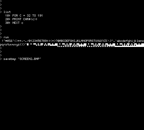

In the interest of TRS-80 / System 80 basic compatability, I implemented the TRS-80 graphics character set. This extended graphics set divided each character into six, giving 2^6 or 64 graphics characters ranging from blank chr$(128) to full white block chr$(191). (See the screen shot attached) These chunky graphics can set the video memory faster than pixel, by pixel, but can be mixed with the pixel/pset/preset commands. Just like in the good old TRS-80/System-80 days.
Just as a side not, in extending the character set, I found that the source code for the stock firmware doesn't output characters greater than ~ ASCI(126) to the VGA buffer at all. Since they have no font defined for them it skips them.
Hope this helps
