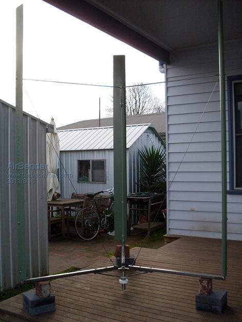

Hi all
At last the construction has finished and the next thing to do is to get it mounted on the tower which should be tomorow, if it stops raining long enough.
The bracing has gone on, for the bracing across the top of the wings I used 8mm stainles steel rod and for the angled bracing I used 3mm SS rod.
All the best Dean.

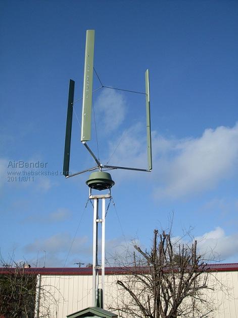

Hi All
This morning I got up to a clear sky with no drizly rain for a change, so the new wind mill was mounted.
But as you would expect we have hardly any wind. We have had a few puffs come through and it has self started a few times and spun for a while. But nothing realy to get exited about.
Hopfully soon my son will bring the anometer he built home from the science room at school, or i will have to build my own, and we can get it mounted up as well and I can give you some indication of what it does in different wind speeds.
The wind mill is not up in the best location but we do get some very good winds come through at times, lately most of our winds have been coming from the north and east when our predominant winds usualy come from the south west. So hopfully we will start geting some good winds come through soon.
All the best Dean.

Air Bender
This is just a hunch, but you might want to make the top structural support between the blades out of a solid piece of sheet.
The reason is, as this thing spins up, the blades are going to want to pull outboard and as they beat into the up-wind position, they'll also want to bend back against the direction of rotation. This may start it wiggling and it may get out of control.
With a solid (could be bolted together) top strut tying all three blades together, the chance of a devistating harmonic may be lessened. Like I said; just a hunch.

Posted: 08:55am 11 Aug 2011
Hi Mac
The top bracing may look a bit flimsy, but it is actualy quite stiff. For the wings to bend inwards it will need to bend the wing or the plate at the bottom that is inserted 500mm up into the wing. Before i put in bracing I slightly sprung these plates outward so that the bracing pulls the wings in straight. The top bracing is 8mm stainless steel rod which is quite hard to bend and in the centre of the three peices of rod I have a nut that has holes drilled through the flats that the rod is inserted into and then wilded on the inside of the nut making the centre conections quite stiff as well.
When I fitted the mill onto the tilted tower we had to lay the mill over on its side to slide it onto the shaft I had someone holding it up by lifting it on the bracing and there was no movement in any of it at all.
Any force from the wind on the wing inwards will be reduced or overtaken by the centrifical force pushing the wings outward so i am hoping that the bracing at the top will OK. I think that by adding more weight into the top of the mill by building something very solid up there will more likely add to the wiggling affect and harminic inbalence at the top.
All the best Dean.

Posted: 11:45am 11 Aug 2011
Only 1 sure way to find out.... let it blow....
Smithy
"The answer my friend is blowing in the wind, the answer is blowing in the wind" Bob Dylan
Posted: 12:09pm 11 Aug 2011
I can see where Mac is coming from regarding drag. Although you have struts and wires to stop the blade bending out wards, there is nothing to stop the blades bending back from drag, that is the force pushing at the blades leading edge. At speed the tops of the blades will be twisted back, with respect to the turbine axis.
But hang on, just rethinking how a lift type VAWT works, the twist is actually going to be forward! Looking at your last picture, the blade closest to the camera. The top of the blade will be driven to the left, because its lift is driving the blade to the left, and the bottom is anchored to the axis, but the top isn't, so its going to want to lean over in that direction. A fix would be an extra wire from the top mount point on that blade to the bottom mount point on the next blade, to the right in that photo.
That way each blade is triangulated and cant get out of shape.

Posted: 04:08am 12 Aug 2011
Hi all
The back and forward movment at the top of the wings may be a problem. When the mill was on the ground I put a bit of force on the wings and they moved back or forward a couple of inches at the top before the mill starts to tip over. the movment comes from a slight twisting in the bottom rotor arm. The old mill was set up basicly the same and the wings never tended to tilt back or forward even in very strong winds. But this mill is a different beast having the wings twice as high. The bottom rotor arm on the old mill had square tube with 1mm walls and this mill i have the same size tube but with 3mm wall thickness and they are not much longer than the old ones.
If this turnes out to be a problem i will have to strenthen it up somehow or add wire bracing in.
At the moment I dont have any movment coming from the mill at all, I hoped the wind would kick in a bit yesterday afternoon but it droped out completly and its a dead calm again today.
Yesterday morning it self started a few times rocking back and forward on the cogging and broke loose with only a light puffy breeze which wasnt even strong enough to spin the mill up to cut in speed it spun very slowly for an hour or so untill the wind droped right out. So i dont think there will be any problem with starting, I must have got my angles right, you can get lucky some times.
by looking at the forcast i dont think we will be getting any wind untill after the weekend which dosnt realy matter as i am at work for the next 4 days were I leave in the dark and return home in the dark, but then i have 4 days off and hopfully the wind will be back by then.

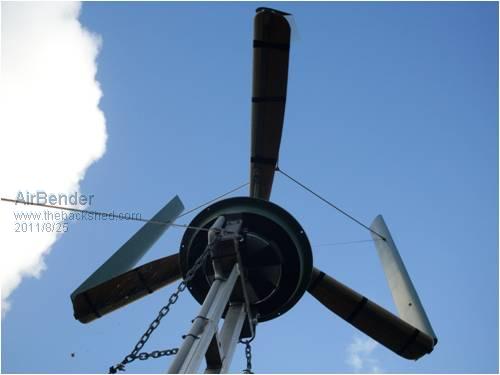

Posted: 07:09am 25 Aug 2011
Hi all
I done a bit of streamlining on the bottom rotor arms, still not finished but I put the foils on for a trial run.
We had a bit of wind today and I think I have gained a few more rpms, and it is spinning up a lot quicker in the gusts.
All the best dean.

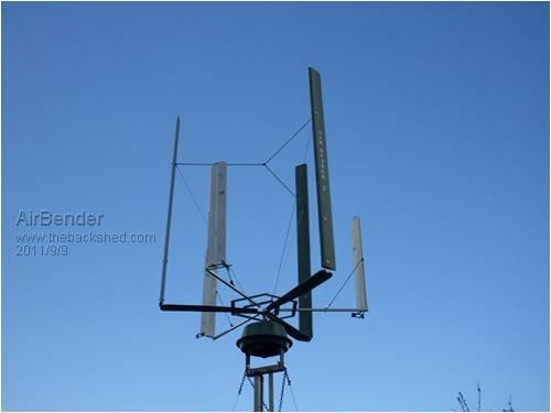

Posted: 11:07am 08 Sep 2011
Hi all
I have brought the old wings out of there short retirement and have fitted one in between each of the bigger ones, so now I am trialing 6 wings on 6 rotor arms and I have had very good results with the mill reaching cut in which is around 80 rpm in 3 m/s winds instead of 5 m/s which both wing sets were doing on there own.
The small wings being piviting two element wings have heaps of torque, help push the rpms up so the big wings reach lift speed and take over which seems to be a good combination.
With all the light winds we are having this is more than a 100% increase in the output of the mill with it know puting a small charge into the battery most of the time.
Over the next few days they are predicting some good winds from the south west which we havnt had for months. This will be a good change from the north and north west winds we have had for so long know. I am very keen to see how it goes in a good fresh southwestly.
All the best Dean.

Joined: 25/01/2011
Posts: 206
Posted: 01:56am 09 Sep 2011
A picture of the latest wing set up.
All the best Dean

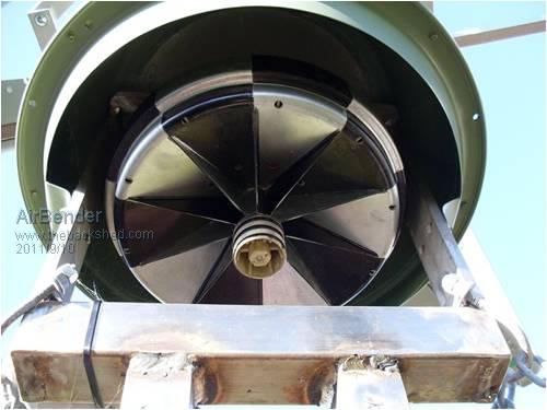

Posted: 01:16pm 09 Sep 2011
Dean, the mast head mounting of your interesting wing wind generator has me intrigued. Do you have a close up pic of the part below the generator?

Posts: 206
Posted: 11:29pm 09 Sep 2011
Hi Klaus
I built the mast head so I could take the rotor off easy and change the stators. It is basicly just a square with 50mm thick walled S/S square tube across the bottom and the uprights on each side are solid 50mm x10mm S/S, welded to these across the top are two peices of angle that have the bearing housing atached.
There is a bit of flex and movement in the tower but not in this top part it is very solid.
As you can see I have a good supply of scrap stainless steel.
All the best Dean.
Posted: 01:43pm 10 Sep 2011
Thanks Dean and, yes, it does look very strong in a close up shot. What do you use to weld the SS steel?

Joined: 25/01/2011
Posts: 206
Posted: 11:02pm 10 Sep 2011
Hi Klaus
I do all my welding with a stick welder.
