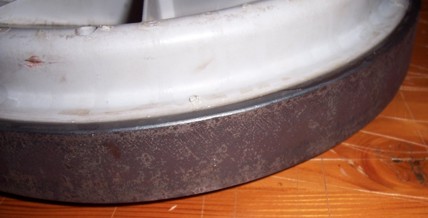

I had a old time blacksmith bend me the metal ring, I'll buy glue and fit on Sat,(and let dry) maybe results by Sun. Then I'll ask more about wiring but lets see how cogg goes first.

Hey John I haven't forgotten, I glued the ring on a rotor,let it dry and picked out the ferrites but found the laminations inside were all rusty. Rust only grows and will effect gap spacing and eventually cause the magnets to hit the stator. I tried three rotors and finally found one that wasn't too rusty. I have to grind and rebind the join, so a couple more days yet.

I guess you can allways reposition the magnets if the 44 magnet format turns to custard? With that ring on you will not have any fear of over-revving it!

BTW here's the 3mm ring
I wonder if this effected the results?

Posted: 05:03pm 18 Dec 2006
Scheesh, I never expected starting cog to be that bad! Another idea to go in the bin I suppose.
The ring might have strengthened the magnetic field a little but I dont see how it could have increased starting cogg without also increasing running cog.
