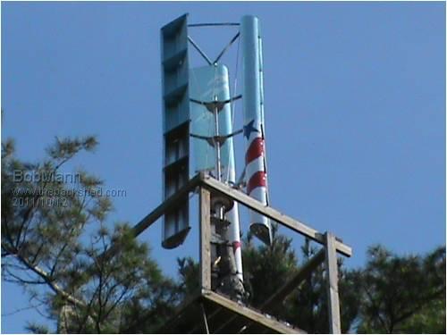

  BobMann said  I just assembled the 8 ft lenx setup on my tree for testing
[/quote]
Looks like it " WOULD LAST A LIFETIME "

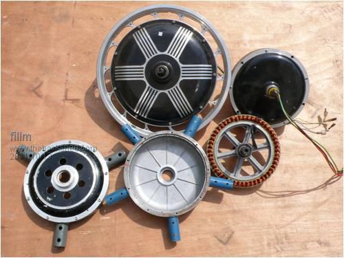

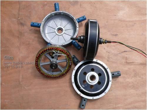

As you have asked previously " To show pictures of other PMA motors or wind generators that can outperform the MANN SMART DRIVE , the pictures below are of the 500W kits I have a few off , these are basicly E-Bike motors that have blades fitted to them and are easily available of ebay and can be s easily converted .
They have NEO magnets , and can punch out the power to destruction if overpowered and also have very little cogging .
The standard Ebike motor is the black one and the others have been modified to wind gens . These are rated at 500W but easily blow through the 1000W with the one I have flying here peaking @ 1850W the other day in 20m/s . But in saying that those levels are very short lived if sustained . But with the ALU blades they are a very good low wind producer , not as good as an AXFX but for $650 that includes the 6m tower , blades base , rectifier etc its not to bad .
Below is a picture showing a bigger Ebike motor that I havn't got around to doing any thing with ,but the company that does the mods in China Rated them at 2kW.
These can be found on ebay and Alibaba.

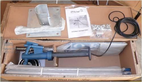

Heres a Pic of the 500W Kit.$650 Inc heavy walled flanged 6m Tower & Base ,ALU blades, slip rings , rectifier , etc
But the catch is , to get good performance out of it, mods are required, so I inform the buyer of that and provide all the info I have at that time on what you have to do.
But if you want to buy what I would call a better quality mill from China then you would be looking at EXMORK , heres a link to their 1.5kW
