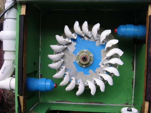

Hydro John
Hi
Looking at some of your older posts, I see a detail that could possibly improve on the torque of your Pelton ( unique use of Elbows) !, DETAIL, The picture of your box and wheel with modified Nozzle, The Jet stream from the Nozzle may need to be a bit lower down ( nearer to a tangent to the turbine cups) maybe down 3/8", I say this because I have read various documents about the design of Pelton wheels and the principal of energy transfer from water to wheel,
The Idea being to totally reverse the direction of the water, when the jet hits the cup, the rebound is smooth and quick. the concave surface of the spoon or cup reverses the water direction completely. I notice that on your Wheel the jet is cut off by the Cup following, before the tangent cup has reached its position to fully reverse the Jet,. The Cups are exhausting water vertically at only 45 Deg.
Moving it down may mean that the nozzle would need a longer taper to position it close, don'no.
You are the man with the Machine and I just an onlooker, It could be that the Elbows have a different reaction than a standard Pelton Spoon. I thought it worth a mention.
Great work here, would like to see you get the rest of your available head.- ----------------Cheers, Roe Edited by Greenbelt 2011-12-14

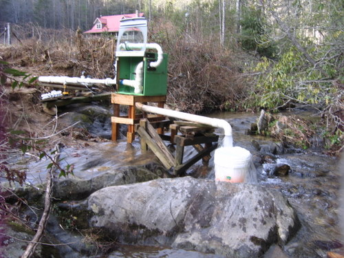

Hello Friends,
[quote=Greenbelt]The Jet stream from the Nozzle may need to be a bit lower down ( nearer to a tangent to the turbine cups) maybe down 3/8", I say this because I have read various documents about the design of Pelton wheels and the principal of energy transfer from water to wheel, [/quote]
I have tried many different positions and the one pictured below seems to give the best results.
I have come up with a way to measure the flow through the nozzles. This should give me more accurate information. I can now measure the real flow rate using different size nozzles.

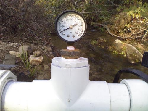

[quote=Warpspeed]One interesting test would be to measure the static water pressure just ahead of the nozzle with the flow blocked, and with the turbine flowing. [/quote]
I have a simple water pressure gauge installed,although I don't think that it is very accurate. The picture below shows about 9 psi static pressure, which is very close to the calculated pressure at 21' head.
From all the testing I have done so far, it is beginning to look like the F&P generater I have is not going to be able to effeciently use much more than 50 GPM at the 21' head I presently have. I think I have enough water to run at least one more generator and I am thinking about building another one. My question is, can I connect both 3 phase generators to the same line going to my house?

I'm still searching for new ways to improve my pelton wheel and nozzles. The buckets on the original wheel cannot take the continuous pounding of the jet stream, and some of them are beginning to get loose. I have some ideas on how to strengthen them and will let you know how they turn out.
