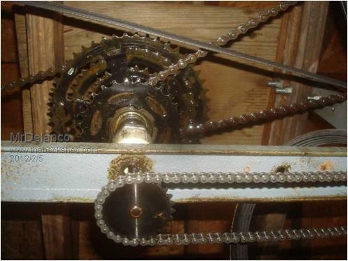

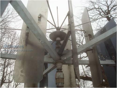

I have viewed several of your short video's and generally like what I see with your giromill. However I can not figure out or see how the Tail is mechanically attached to the blades. All I see is a "tail" off to the side of the main vawt. I'd love a general blueprint or diagram of this. The 14 to 1 ratio sounds and looks impressive on the video's.

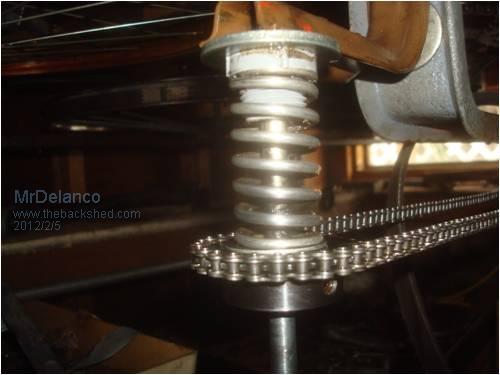

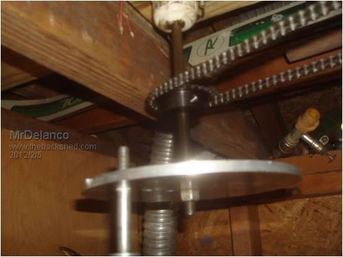

Hello Mark;
The top of the mill has an off-set cam plate that is attached too a 3/8" rod run down inside the 3/4" drive-shaft that runs inside the 2" support pole. The inside end has a sprocket and chain run to another spring loaded sprocket on a 3/8" shaft with another sprocket and chain run across the ceiling around two more sprockets too adjust the chain tension then to another sprocket attached to a 1/2" shaft running up inside the 1" tail support pole.

Hello Mark;
Here are some photos
