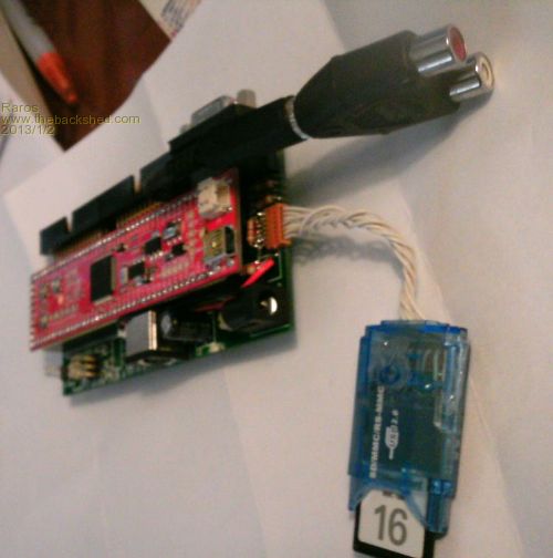

Raros
Joined: 06/02/2012
Location: Italy
Posts: 55
Posted: 02:23am 02 Jan 2013
Hi
I mounted the MCC-PCB for UBW32 and it works great.
Thanks to:
Bigmik for the design of the PCB;
Donmck for UBW32-MCC-PCB-Letter;
Geoff for the wonderful Maximite.
I just changed the connector for the SD-Card:
Happy New Year.
Raros.
Posts: 2981
Posted: 12:24pm 02 Jan 2013
Hi Raros,
Happy New year yourself, and to all `TBS'ers of course.
Glad you got it all working.. I like your picture it actually makes the UBW32-MCC assembly look smaller than it actually is.
I am curious though, why did you solder the standard SD connector on instead of using the uSD connector? ... If you could solder all those wires for the large connector onto the PCB you would have had no problems soldering the uSD socket.

Joined: 06/02/2012
Location: Italy
Posts: 55
Posted: 12:06pm 03 Jan 2013
Hello Bigmik
I used a standard SD simply because:
The uSD connector is hard to find here in Benevento area (my hometown).
I had a standard SD reader broken. I removed the old pcb and I soldered the connector on a 1000 pcb holes. And then I used a pair of micro plug 7-pin.
I like to recycle things.....
How TassyJim says I can mount the card reader at different distances.
Raros
