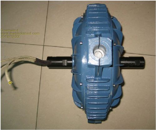

  Quote  think its a bit different there is a piece of pipe coming from the rotor where u attach to the tower with a few bolts as inn u tube video
I will bet you a half eaten christmas pudding its a 500 watt mill, if that is the case. (one of the versions that may produce 2kw in a cyclone if it didnt self destruct before hand)
First indication, do it have the cooling fins on the rotor casting? (like in the photo i posted)
If it do, then the measurements of the rotor, including axle dia.
Just to warn you, it might be a case of you think you have a total of 6-9Kw mills and only have a total of 1.5 Kw mills.
Until we know, its just pissing away your cash, for example if you build a tower for 2-3kw mill and only fly a 500w mill then its a huge overkill in cost, same for inverter and batteries, wiring, controllers, etc.
Workout what hardware you have and the rest will fall into place.

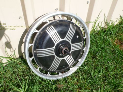

Posted: 11:52am 22 Dec 2012
Im thinking it will be the later version with the bigger generator motor than the 500W but exactly the same type of down wind design as the very first , with welded blade mount spigots , the black bike wheel end plates as in the pic will give it away and the stupid looking tail out the back.
Heres a pic of the parent 1000w wheel motor that they turned into a 2000W generator.
Hopefully you can work out how to upload photos to help this along.
