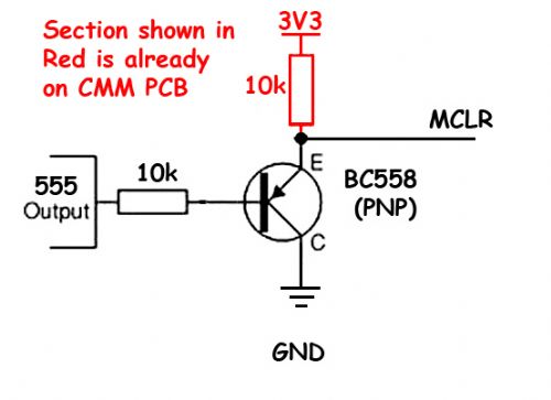

Of course you could route through a transistor switch, I can provide a cct for that if you need it, that switches between 0V and 3.V.
EDIT ** Or maybe just 2 standard diodes in series on the output might work as well, they will drop 0.6V each and turn 4.5V into 3.3V

Not sure the series diodes would work, as while they would drop the voltage to the reset line, they will block the 555's attempt to pull the reset line low, would they not, as they would be reverse biased?
I would be running the 555 circuit from 5v.
I am guessing that your transistor idea would be the best option.
PNP type, emitter to PIC32 reset, collector to deck(ground), 1k base-loading resistor to 555 output. That way, when 555 output is high, PNP would be off, allowing PIC32 to run. When 555 output goes low, PNP will pull reset line low via C-E path, resetting the PIC32.
Edited by Grogster 2013-06-13

Here is a possible cct for the output of the 555

If you can use the discharge as the output you can connect it directly to the MCLR.
If you look on page four of the datasheet you can see that the output is a pull-push type and the threshold an open-drain.
Not needing a transistor saves pcb space and is cheaper.

@ TZA, yeah, I see that too, but I was looking at the full schematic at the top of page 5...
I will build the standard 555 circuit again, and see what happens with the extra cap suggested by Mick, just using LED's as the original circuit shows, and not connected to the PIC32 yet.
If I can get the 5v version working OK, then I will plop in a 7555 and lower the voltage to 3v3, and also still on LED's, see what happens. In that circuit, they have connected discharge to the E of the PNP input transistor among other things, and I am guessing that I can't just disconnect discharge from where it is, or the circuit will most likely stop working. At the lower voltage, I am also guessing that the time interval will be longer - I will keep the thread posted on what happens.

Kudos to TZA now!
If I remove the LED on the 555 output(and it's resistor), and move these to the discharge pin(LED's load resistor still to 5v, LED cathode to the discharge pin), then the LED still comes on after the time-out period - perfect.
I have settled on a 470n cap on the input transistor a-la Mick's idea.
I removed the link between discharge and threshold - the rest of the circuit is still the same.
I will post the circuit soon, so everyone can compare notes.
The only issue left now, is that once tripped, the 7555 will hold the PIC32 reset low, and the chip will never restart. This is not a new problem, it was always there, but I am having a think on how we can fix that along the lines of another transistor on the supply to the 7555 circuit, so that when the output trips, the transistor switches off the 7555 - which promptly restarts, because the transistor holding it off, has lost it's base voltage, which was coming from the 7555, if you see what I mean... Adding a cap on the base of the switching transistor would control the length of the pulse. This should give a singular reset pulse at the end of the time-out, but then the LED should go out again until the next time-out. All very much in theory at the moment, so we'll see what the breadboard makes of my idea.
...still a bit more tinkering to do...Edited by Grogster 2013-06-14
