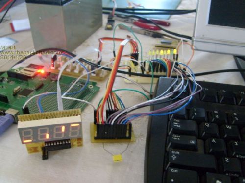

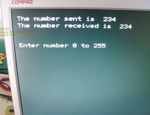

Thanks for the inspiration. I think all my problems were noise related.I've swept the floor and collected all the hair. Now who is that hair transplant mob?
I commented out the weak pullups as they shouldn't be needed as port b is output with resistor and led external pull ups and port a is tied to logic levels from port b.
IOCON only needs initial set up at &H0a as the registers concerned are shared.
The numbers on the 7seg display are just 1 2 4 8 and nothing to do with the expander, just an indicator that the i2c bus was working so I left it in.
The expander is in that block of connectors in the foreground.

Input "Enter number 0 to 255 ",number
Cls
I2CSEND expander,0,2,gpiob,number
I2CRCV expander,0,1,inpina,1,gpioa
Print "The number sent is " number 'send byte to port b
Print "The number received is " inpina 'receive echo byte from port a
GoTo start

The expander also works in bank 0 mode just by substituting the corresponding bank0 register addresses.
Moral of the story, NEVER leave pins floating. I got lazy and tried to use just the one pull up resistor and LED on the expander port pins one at a time. I guess in the past I just got lucky.
The same thing applies to decoupling capacitors ALWAYS fit one to the vdd vss pins. I have been caught with that one even though mostly I've got away with it.
The long and the short of it - all works on the expander just as it looked like it should have. Just call me baldy now.

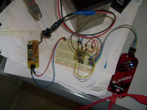

Now that has put the data expander to bed, we can start on turning the PIC16F1503 into an I2C slave and see if we can get it to act as an I2C LCD display.
I cleaned up (syntax wise) a F88 programme I had and successfully dumped it via MPLABX IDE to the 1503. Of course, it doesn't do anything yet. First I'll flash a led to let me know it is working and then I'll fix up the I2C slave mode and flash another led. Different registers, different location and names. Let you know how I go along the way.
Picture is a bit fuzzy but that's hardly surprising.

Pic Slave.
Ok, so I didn't flash a LED but a square wave on the cro is as good as a nod to a blind horse. The internal clock tripped me up a bit, needing a register and config words both set up right. Now for the I2C bit.
David M.

I had another little hiccup over the last 24hours - in translating the F88 pic source to F1503 as an I2C slave. I foolishly chose an I2C address for the chip of 255 (hex FF) and wondered why the MM wouldn't talk to it. Forgot MM does range checking. Changed the address to &b00111111 and voilla! it works.
Now to see if I can make the code into a LCD slave. Haven't checked if I have enough pins as the pic is only 14 pin.
