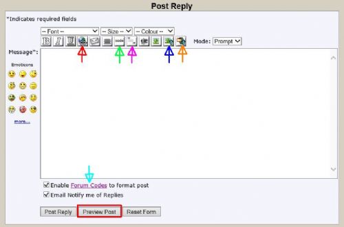

  viscomjim said
Sorry I don't know how to do the white box around other peoples quotes yet, but I swear I will learn...
Jim, it's not hard. Here is a small tutorial. For a start, if you want to quote someone's post just use the quote button outlined in red in the next image. If you don't want to quote the whole post just delete text to suit.
The image doesn't look so great because it gets a bit shrunk in the upload etc. but I hope you get the idea. If you want a great looking image with text etc. then ZIP or PDF it and upload that.
The next image has a number of coloured arrows pointing to some of the functions you may like to use when creating your post.
See the red box around the Preview Post button. This button allows you to see your handiwork before going public. Use it as needed.
The cyan coloured arrow points to help for all of the forum codes. It opens in a popup. I can't write any of these codes here because they won't show.
The lime green arrow points to the CODE button. It puts down two CODE words into your text and you put your code snippets between them.
The pink arrow points to the QUOTE button.
The blue and orange arrows point to image and file upload buttons.
And the best for last. URLs, URIs, links, hyperlinks or whatever you wish to call them, are not automatically made active in your post if you paste them in as text. Even worse the forum software inserts strategic blanks into any text that looks like a link so that your link doesn't work. This makes other people unhappy as they try to figure out what you meant and you may get broken link comments. The solution is to use the Add Hyperlink button shown by the red arrow. Click it and follow the prompts.
If you hover over the toolbar buttons you will get a small popup to help you with the use of the particular button. Don't restrict your usage to the buttons I have mentioned. They are all useful.
