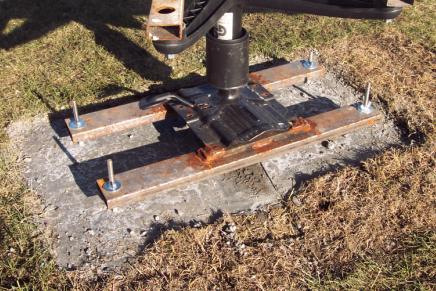

Finally, after a lot of days full of rain, the sun in shining in Belgium. So,I've made a concrete plate for my Savonius. It's still wet, so I can mount the windmill next weekend. There was a lot of wind the last few weeks in my parents garden and without the concrete plate the Savonius always went down on his side. Wait and see next week, so the experiment can finally start.
Greatings from the sunny side of Europe. It's 16°C, the highest temperature ever measured in February. It feels like spring at this moment.
Bart.

Your test case shows exactly what I want to test with my design. It's already turning well in the wind without those flaps (just plain plastics now). The concrete of last weekend is hard now, so this weekend I'll anchor the windmill on it. If you're intrested I'll make a little video of it when it's turning. The thing I want to know is that the windmill with the flaps has a better performance than without it... I'm only afraid of the noise it's going to make. At this moment it's turning, even very hard sometimes. When I saw your video on YouTube, I saw exactly the behaviour that I had in mind !
Greatings.

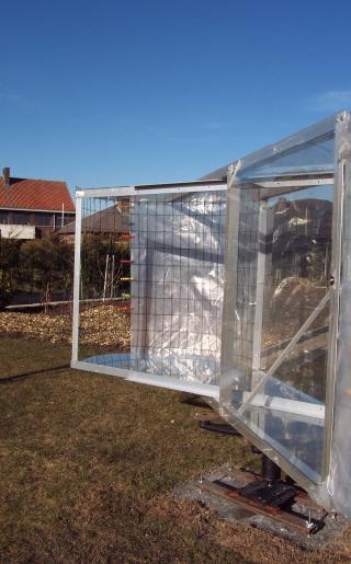

After being sick for a whole week and two weekends, I've mounted the windturbine on the concrete plate. At this moment I've used plain plastic to cover the wings.
Even in very slow winds, the wind mill is already turning. When there's a lot of wind, the speed of the rotations are changing a lot.
About the 'flaps': I've mounted one paper flap to see whats happing. When there's a lot of wind, the flap remains closed and only opens a little time. The flap is pressed against the wire because of the wind circulation in the wind mill. But before to continue these tests, I'll have to make a measuring system.
Greatings.
Edited by BartHermans 2008-02-25

Anthony (Jarbar), this weekend a lot of wind blow out one plastic plate that I've mounted on the front of the wind mill. In fact, I was not surprised that this would happen one day. The plastic was only 0.4mm thick. It's blown out from the inside (incoming wind through the wind mill). I'm thinking of some other material to use now.
This kind of windy weather is not to be called 'normal' in Belgium, but it was a good test.
By the way, the Duivel factory is only 10 Km from where I'm living , but I'm living most of the time on coffee .
I have no experience with "rubber matting made for fish pond linnings", but some kind of rubber seams to be the way to go. I'm gonna check this out.
Plain plastic is noisy in windy situations.

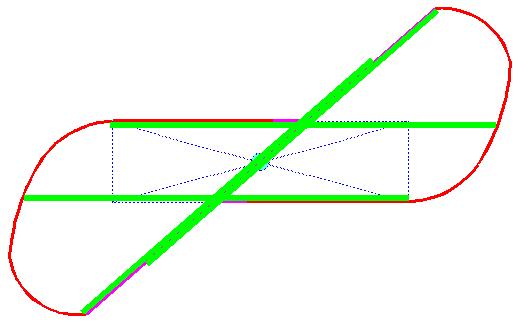

How was the live test of your new turbine ? I didn't had the time to get to a store for the rubber matting. I hope I'll get it next weekend. Where's your turbine design based on ? Mine's based on the drawing :
http://www.picoturbine.com/projectlist.htm
You can find the "PicoTurbine Deluxe Educational Windmill Kit Beta Plans" and on the last page a template is drawn. That's the one I've used, but I've scaled it to 3 meters.
Greatings. Edited by BartHermans 2008-03-11

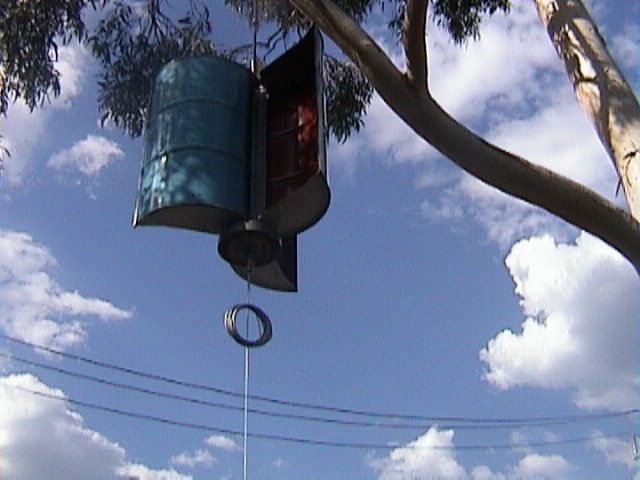

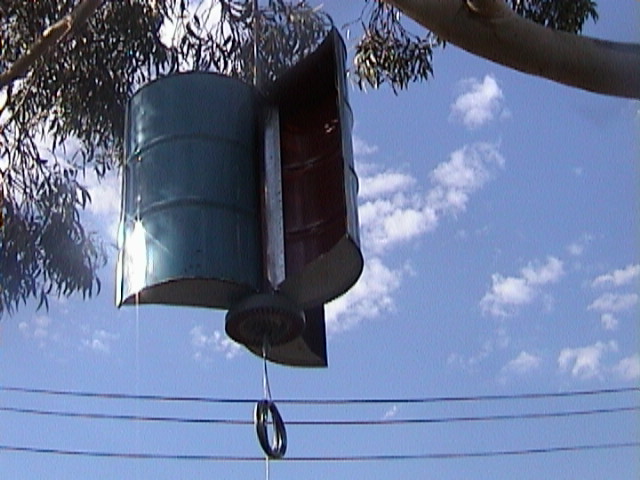

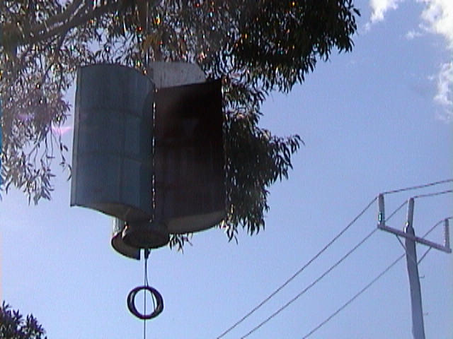

Posted: 10:49am 10 Mar 2008
Hello Bart,yes today was THE day.Out of bed at 6am and in the garage for one more final modification(I wish)6 hours later and hurray the eagle has landed.Up up and away my beautifull windmill.Looks like a UFO in drag(pun intended).Not a lot of wind but glorious to watch.I am contemplating another on top. But before it drops out of the tree and becomes my disarster I need to fit a fall arrestor.So off to the auto wreckers for a seat belt tensioner.As for the design it's a combination of 5 years of model testing and everything I could glean off the net.And then adding it all together.Is it efficent only time will tell.Yours is massive at 3 meters mine is only 1 meter dia.But it's all good fun.I hope to try the counter rotating at some stage also.From the sounds of silence VAWT if I can figure out how to upload a video I'll post that soon.Got to get back to my forbidden fruit(Belgian beer) and pat myself on the back yet again.What a day.And it even looks like it's grid connected.
Anthony
Edited by Jarbar 2008-03-13
Jarbar
Joined: 03/02/2008
Posts: 225
Posted: 10:52am 10 Mar 2008
Opps forgot to hit the enter button on the last image,sorry.
Anthony
