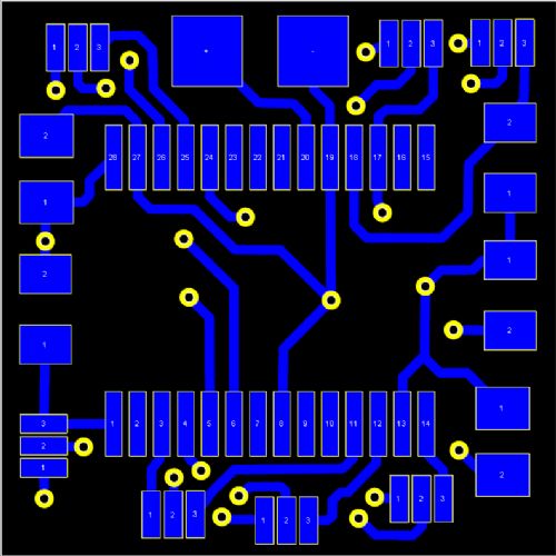

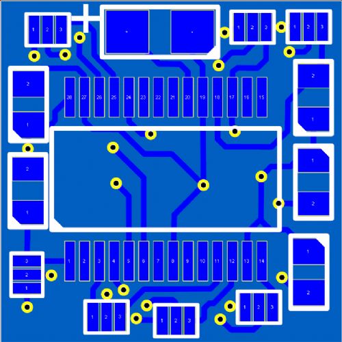

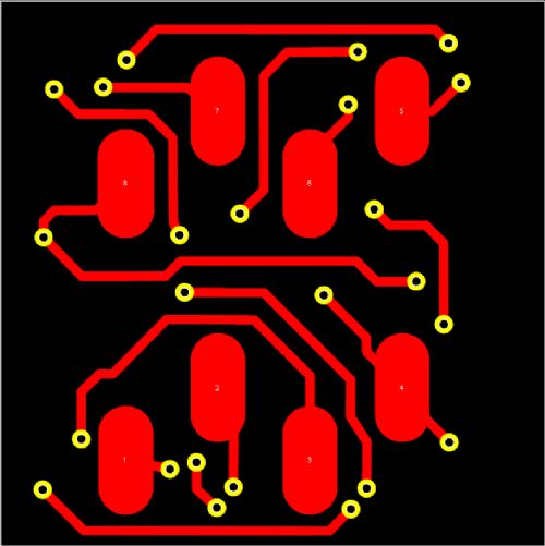

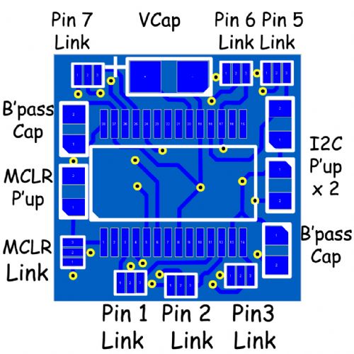

We can do this.. it is a SSOP '170 on a 15mm x 15mm PCB (and it is TIGHT) some clearances are pushed to the limits.. There seems to be some bug in DEX that even though I tell it to use thinner tracks it wont allow me to make them less than 0.01" (.254mm)
Anyway up for critique'
TOP
BOTTOM
OVERLAY (No text yet)

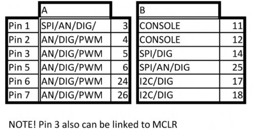

TABLE of link options
NOTE!! There are two link options for each pin (6 in total) plus Pin 3 can be sub linked to MCLR for programming so pins 2,3 & 4 are a pseudo ICSP header.

I have also used those SMT header pins on the bottom layer for connectivity to a standard 0.3" 8 Pin DIP IC socket
EDIT as I said this board is TINY, you can get 9 on a 50mm x50mm PCB. but some track clearances are down to about 0.007"

Wow, Mick - you the man!
...but weren't you supposed to be enjoying your birthday?(rhetorical)
That is fantastic layout-ing. I have just not had the doube-sided experience yet, to think quite along those lines. But I will in time.
With the clearances being that tight, do you think PCB houses like iTead will still accept a board that is so tight?

I think it should be OK with PCB fabs.. I think most/all clearances are at least 0.2mm.
I have sent off a preliminary artwork to SITOPWAY (my usual FAB house) for a quotation as 100 individual boards and also as a block of 3x3 Vee-Grooved to see if they can actually do them and what sort of price per unit they would be..
A moot point in a way as I dont know what sort of market there would be but I am pretty keen to play with a few.. it could open the door to some interesting projects with `multi-CPUs' for dedicated tasks.
I am pretty happy with the size as it would plug into an 8 pin socket with 0.1" (2.5mm) overhang all 4 sides.

Also thanks for your suggestions as to which pins to add.. I think I have come up with a pretty comprehensive `option-able' board (check the table I posted for more details) I can post a schematic but its pretty rough.

I did see that in my earlier look, but I couldnt find it again when I designed the part for DEX.. I think I made the chip outline 10mm so I best check that there is sufficient space to fit the parts left and right of the PIC if it is 0.5mm longer than 10 then there `could' be 0.25mm extra length left and right.

I just checked the artwork..
At the maximum length of 10.5mm the left hand side of the PIC would just butt the right hand side of the bypass and MCLR resistor so If we go ahead I would have to move these about 0.2mm to the left (should be sufficient). We could get away with it but there is a bit of room to move in that direction.
Thanks for that.
EDIT ***
There is room now for any `FAT' chips that we might run across.
Edited by bigmik 2014-09-23

I am not sure about using smt type connectors.
There is not much copper left that is bonded to the substrate to withstand the forces.
Maybe increase the size (as big as possible) of the solder islands.
You can also put in a small via in the island to get some extra strength.
Edited by TZAdvantage 2014-09-23
Posts: 2991
Posted: 10:26pm 21 Sep 2014
Agree with TZA; and to add to that, I would also go for the thickest copper pour option.
