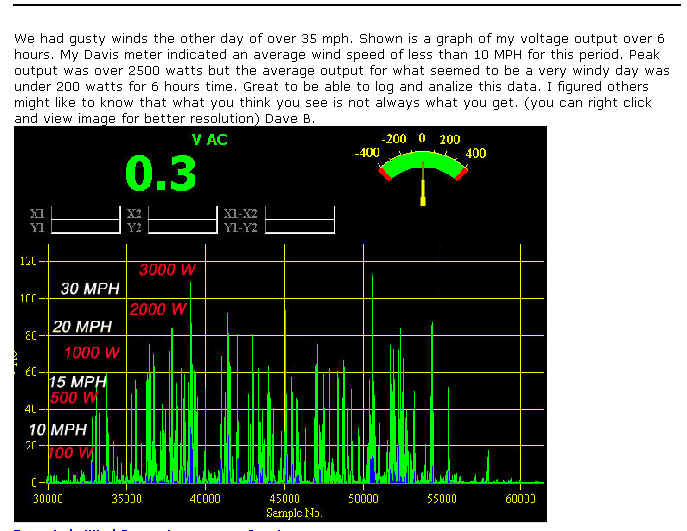

The graph I posted shows that complete wind gust transients can occur within a 20 second period, from close to 0 power output, to max and down again. Mini gusts can be less than 1 second duration.
The response time of the control has to be 100 times faster than the minimum system response time constant to prevent oscillations.
It would be possible to use a cup anemometer to measure wind speed and then use a direct control system to control the modulator. The actual power of the mill at all windspeeds expected has to be known. There should be compensation for air temperature as well. We have all seen that power output falls on hot dry days.
Gill, what sample rate is the data collected at, and what colours mean what?
Maybe you could post a zoomed in portion over say a couple of minutes.
I assume the green spilkes are wind gusts and the blue the mill power?

I guess that a picture can tell a thousand words, but we still need an interpreter.
If we post graphs etc, of measured data, a legend with some explanation should be provided, so comparisons could be made.
we have to be careful comparing measured data and predicted values.
an example of mill output v windspeed is only useful if the blade area is given as well.
30mph wind on an Air-X would not be comparable to a F&P with 3M dia rotor in same wind.
