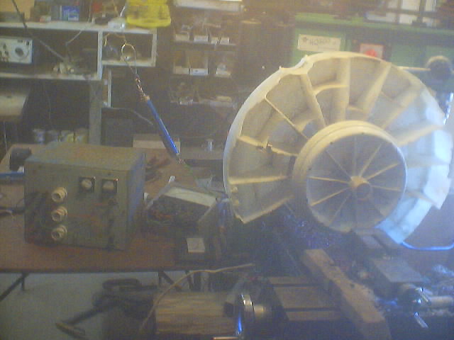

Hi I have struck a snag testing at higher revs 500 rpm reguired to much power from the drill i use to drive the lathe to get variable speed. Have another 1kw dc motor but at the moment we are becomming short power hydro's drying up windmill crapped out solar good. I did get readings for 500 rpm without caps
input power = 323 watts (2.1 kgf )
outpot power = 229 (27v 8.5a )
eff =71%
Putting the caps in was like hitting a brick wall I will need a lot more drive power on the lathe.
I have included a photo of my setup its very simple I was wondering if someone with a grid connection could setup > This area needs a lot of investigation. I did transfer the caps to my small hydro unit with very interesting results I will document under a separate topic soon.
Has anyone that is using caps on windmills struck any unusal mechanical breakages ?
Herb

This is very curious Herb, are you saying the genny was so much harder to turn just with caps on and no load?
However, if you are saying the genny was so much harder to turn with the same resistance load then that is to be expected as you would be producing so much more output.

With load batteries connected all testing yeah expected but i never had enough in put power Increase is quite large tho

Hi Herb,
Some definite experimental data to validate my conclusion on another post. If the mill is closely matched to the load, then adding caps will probably require a change to the blades to drive the mill. The caps lower the rpm at which the mill generates enough volts to start charging the batterey. Remember though that if the battery is down in volts, then it will present a biggeer load to the mill as well. The caps work best on a mill that usually puts out late, and would be considered to be underloaded, or [overdriven].
The theory suggests that without changing the blades or the load, that a mill output current can only be increased when the caps increase the efficiency of the energy transfer from the wind to the battery. To double the power output would suggest that the blade and generator combination work better with the caps added for a mill that is under loaded prior to adding caps. The caps do not double the efficiency of the generator by itself.
As you have measured, a mill that is well matched to the load suffers a decrease in performance when caps are added as the blade will tend to become stalled by the apparent extra load.
Adding caps to a poorly matched system can increase the system current output, where there is basically an excess of generating capacity that was not previously able to be utilized.
As Dennis has stated, if the caps cost next to nothing and you measure increased current then it is worthwhile. If you don't get an increase then it shows your system was pretty well matched.
This will probably add to the confusion.
cheers, Gordon.

A lot testing is needed yet to determine the loss or gain in eff of this method.
I have posted my hydro experiance on other stuff . so this forum stays on windmills although hydro is where i learn most about FP.
Glen with your ability it would I think be no problem to setup a frame with a motor driving a FP that is mounted to have limited movement in its mountings. I will try and sketch something up it is my intention now to do this with my larger drive motor so i can leave set up
HerbEdited by herbnz 2007-11-26

Herb You have connected your phases incorrectly or got your rewind wrong . We have also done this.

Hi What makes you think I have made incorrect connections ? Maybe you could make you test results available so we can see where we differ. The stator is off my Ecoinnovation windmill that has until recently been up and running.Personally on the hydro units I manufacture I dont reconnect stators I find it easier, faster and more flexible to rewind (ie this stator's equivalent is 16 turns/coil). I realised to obtain results that were comparable I needed to use what is in common use. Having also worked with three phase motors, generators etc for 35 years it is a matter of habit to fully test outputs to ensure correct connections and phase balance.

We have done dozens of rewinds and are probably nearing a hundred or so.In doing rewinds we sometimes get it wrong especially when a new player is involved or a more complicated rewire is attempted. On our test bench our 240 Volt motor refuses to start at times and this could be said to be our BRICK WALL .It appears that in hydro situations higher speeds with less torque are sometimes involved
Windmills are such that in most if not all cases 500 RPM is very fast. Therefore 150rpm to 400rpm could be considered as the best operating speed. In a past reply we stated that a 100SP Modified was the best but it isnt. I will open up a new post 80 SP in Star with these results. It is asked that only people who have towers up with F and Ps or test benches similarly set up reply. It gets very confusing with the THEORY GENIUSES WAITING TO JUMP IN Regards Dennis L
