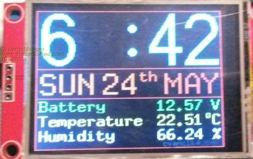

Here is the code I am using and I am trying to shift the single digit hour across one space or specified character before the digit.
If Val(Left$(Time$,2)) < 12 Then
Text 5,1,Left$(Time$,2),LT,2,2,RGB(Cyan),RGB(Black)
Else
Hrs=Val(Left$(Time$,2))-12
Text 5,1,Str$(Hrs,2,0,"-"),LT,2,2,RGB(Cyan),RGB(Black)
EndIf

Hi Graeme and Geoff,
I've just tried it and there does seem to be a problem with the STR$ function. STR$(hrs,2) only returns one character if its <10 hrs.
When I was using it with the Micromite 1, V4.5 and with the LCD command it was working correctly.

Posts: 3368
Posted: 01:47pm 24 May 2015
The answer has just dawned on me!!!!!
Font 2 does not have a space or a minus (-) character. So, when you specified either of these as the leading character MMBasic just skipped it as a non printable character.
If you had tried:
Text 5,1,Str$(Hrs,2,0,":"),LT,2,2,RGB(Cyan),RGB(Black)
it would have done what you expected because the colon (:) is in the character set.
It seems to me that the space and the minus (-) characters are more important in a numeric character set than the colon so that is something that needs to be changed.

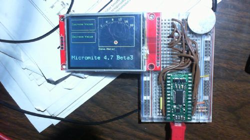

Zonker
Joined: 18/08/2012
Posts: 772
Posted: 09:02pm 24 May 2015
Morning Gents...
I finally got a chance to play with the new firmware... Nice..!
I went back to the TFT MM demo programs and converted a meter object to the 2.4 inch touch panel to play around with... Still working on it...
2015-05-25_070042_2-4_inch_meter_test.zip
Posts: 11903
Posted: 09:53pm 24 May 2015
Zonker
Very nice demo - congrats

paceman
Joined: 07/10/2011
Posts: 1329
Posted: 01:35am 25 May 2015
Yes, nice job Zonker. I've got it running on a 2.8" with exactly the same code and connections and it looks great. It's amazing how much extra display area there is with the 2.8" screen - it's 7.8 sq" Vs 5.7 sq" and not much different current draw, about 50mA directly off the 3.3v supply.
Greg

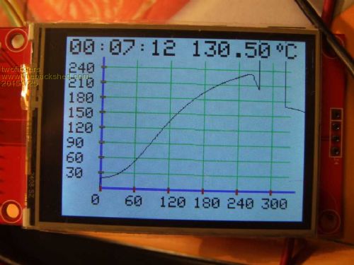

twofingers
Joined: 02/06/2014
Posts: 1773
Posted: 07:10am 25 May 2015
  Geoffg said   There has been a lot of comment on the loss of the SPI channel to the display/touch controller.
Geoff
hmm, seems the MM lost his SPI ability? (if you don't disable the LCDPANEL)
... I wanted to use the new LCD capability with a SPI thermocouple circuit (MAX31855). I got it already working with Peters Graphic library.
A display for my Reflow-(Pizza)-oven (3x SPI: LCD, Touch and MAX31855 thermocouple amplifier).
  Geoffg said
  Graeme Meager said  We need the colon as the delimiter for Time$
I have figured out a way to get the space, +, -, = and : in the font. So all is good.
They will be in the next beta.
Geoff
Some countries (ie Germany) use the comma "," for numbers as decimal mark (1/4 = 0,25). Can we have it in the future, please?
Michael
Demo code on 28 pinner (Micks Backpack 170).
OPTION LCDPANEL ILI9341,L,4,5,6
OPTION TOUCH 7,2

Hi Twofingers, are you saying that if you disable the lcd then you can do your spi temperature measurement and then re-enable the lcd and this will work?
Also, are you using a pid profile with your pizza oven? Just curious.
Thanks for all your help!
twofingers
Joined: 02/06/2014
Posts: 1773
Posted: 09:56am 26 May 2015
  viscomjim said   Hi Twofingers, are you saying that if you disable the lcd then you can do your spi temperature measurement and then re-enable the lcd and this will work?
Hi Jim,
with Micromite V4.7 Beta 3 I can only use SPI with PeterMs Graphic library
(OPTION LCDPANEL disable, OPTION TOUCH disable).
  viscomjim said  Also, are you using a pid profile with your pizza oven? Just curious.
No, I don't use a pid profile. The oven runs at full power with manual power off. I think that's good enough. I use the Micromite only to observe the temperature.
But I'm prepared to control the SSR by MM. For that I have to isolate (fiberglass mat) the oven better.
To build up a oven control is a challenge, I think.
Today I encountered some issue with GUI CALIBRATE. I get always a calibration error regardless how exact I execute the calibration process. I can't use the Touch function. With PeterM's Graphic library there are never problems. Perhaps can someone help?

jman
Joined: 12/06/2011
Posts: 711
Posted: 11:32am 26 May 2015
Hi
Graeme Meager was kind enough to share his code with me.
I added my NTP routine and the result is here.
Graphic Clock
I could not resist the boot screen :)
