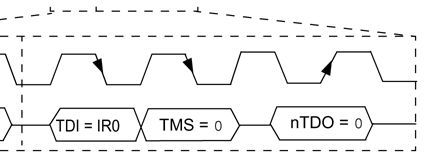

regarding the times the PGD line is being driven by the PIC32, this diagram is what i have been working from:
i believe that the rising edge of the 3rd clock pulse turns around PGD (making it an output), and that the TDO data becomes valid on the falling edge of that 3rd clock pulse. the TDO data should be read out during the interval between the falling edge of the 3rd clock pulse and the rising edge of the 4th clock pulse. my feeling is that it would be unwise to leave reading the TDO data any leter. by the falling edge of the 4th clock pulse PGD is guaranteed to have been reconfigured as an input.
i recall there being some quite heated discussion over this timing on the original ICSP thread.
