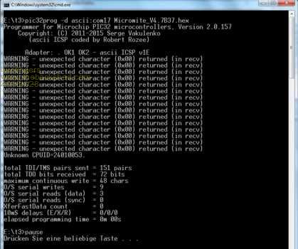

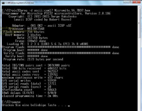

the programmer is also working (pic32prog.exe v.2.0.186).
Previously I've tried a older pic32prog.exe v.2.0.157, which did not work.

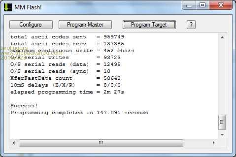

I think maybe your programmer will also work with Jims MMfFlash ?
Tested: works! Takes 147sec (Arduino mode).
Thanks again for your great job!

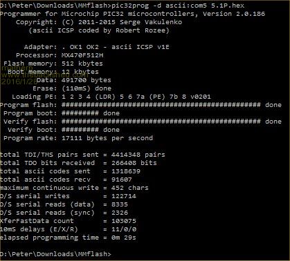

Posts: 11902
Posted: 07:40am 28 Jan 2016
Loading 5.1 to MM+, W10, I5-3470 Desktop, with Microblocks PIC16F1455 code

  MicroBlocks said   Great to hear. I am a bit puzzled by the programming time though. on my machine (surface pro 3 with Intel i5/4GB, windows 10) i got this
Hmm, this machine should be much slower (Windows Experience Index 6.5 Win7), but I would not expect such a influence.
Can you use please the pic32prog.exe v.2.0.186 (the latest, I guess)? Or send me a link for Version 2.0.174?.
EDIT:
As Peter has shown it's probably the higher PC speed.
No need to test the 2.0.174!

Posts: 11902
Posted: 08:02am 28 Jan 2016
  Quote  How does it compare to a pickit3?
Faster
Pickit3: 40 seconds for MM+ 5.1
PS my times are with a standard USB 2.0 portEdited by matherp 2016-01-29

  MicroBlocks said   I think the biggest difference is the PC's USB port. The newer ones (3.0) are much faster.
Hmm, I can not confirm that. I got the same results on USB 3.0.
If I use Jims MMFlash (MicroMite Mode) I get slightly slower results (147/120) compared with command line mode.

Hi Jim,
I'm not criticizing your program. I made a observation (see screenshots). But I have no idea why this delay is happen.
I like your wrapper program!

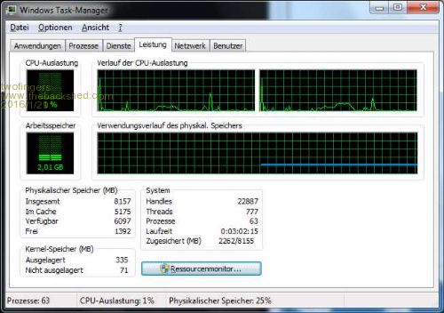

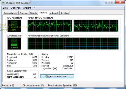

Hmm,
seems the MMFlash generates higher CPU load.
This is the pic32prog (command line/batch file):
and this Jims MMFlash:
Maybe under certain circumstances (background programs) the CPU uses 100% on my system. This may explain the differences.

No! Sorry, I'm using a dual core system (for this). A single core system with XP did it in the same time = 120sec (CPU load ~10% for PIC32prog.exe).
@Robert
  robert.rozee said   you could have a look under the 'processes' tab, click on 'CPU' to sort the list based on %CPU usage, and check to see what process (pic32prog or mmflash) is sucking up all the computrons.
CPU LOAD
PIC32prog.exe = 0%
MMFash.exe = 50% (avg. 47.5%) 50% means 100% for one core!

Success!
Programming completed in 147.634 seconds
Michael
