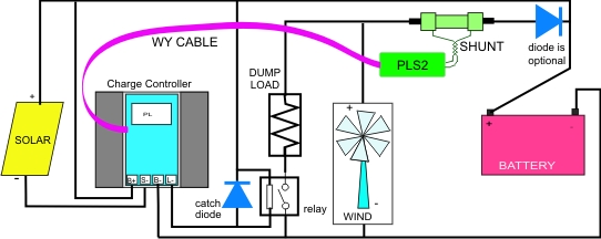

I took this from the pl website
Just to confirm my understanding of it, the L- is an adjustable set voltage on the unit. Which triggers the relay and thus the dump load. Is that right?
If so is the pls2 required if no logging is needed?

L- voltage is set as part of the regulator system voltage setting. Yes you are right, the L- is used to trigger the relay for dump load.
Used this way the regulator function settings are also changed so the L- switches on only when the batteries are fully charged and is no longer available as a load outlet.
You are correct, if you are not wanting to record wind data, then no PLS2, shunt or WY cable is needed.

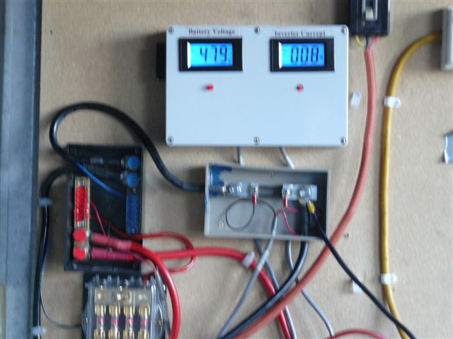

While browsing through various posts I saw how someone made up a current shunt out of a piece of threaded rod, very ingenious, as you can then fine tune the resistance real easy to calibrate the meter. The same person also used digital meters and a small DC-DC isolated converter from a computer network card. I used a couple of digital LCD meters (A$ 4.99 + A$ 10.oo postge) and DC-DC converters from "Asia Engineer" that I found on E-Bay quite cheap, they have various voltages and current capacities if you ask them.
Sorry there are no further pictures of the installation but the outside of the monitor box has not changed. just some internal tidying up of the wiring.

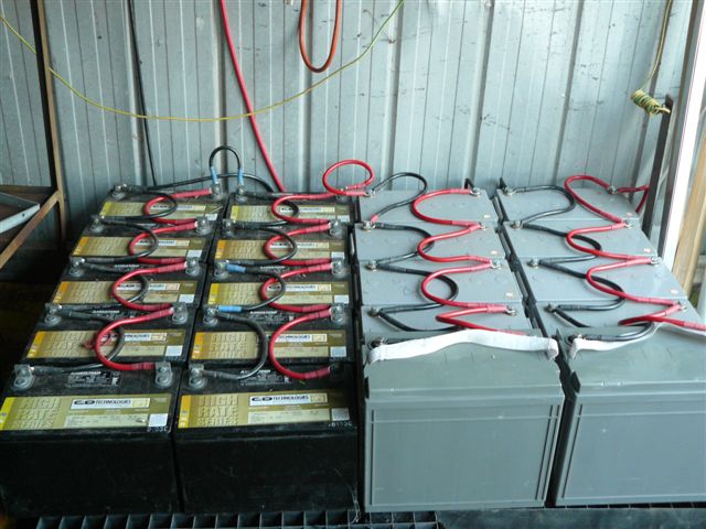

Well finally I got up to the "Farm".

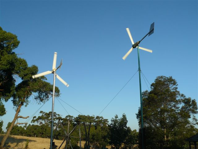

it was a couple of very warm days (30 degrees plus)in Dereel, Victoria near Ballarat where the farm is.

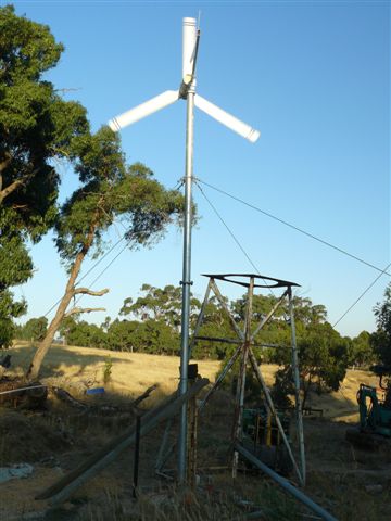

We finally got the Windmill up and going after I put the blades on back to Front and it did not want to turn, so we turned the blades around and it worked. but it still needs a fair amount of wind to make the wind generator charge the batteries.
We still have to change the tail around as my brother in law put them on upside down. ( No assembly instructions on how to put the whole lot together).
The only instruction was for the balancing of the prop, (only making the blades equidistant).
All went well the blades were balanced to within the 5 mm as recommended by the manufacturer and we raised the generator again, we used an old tank stand to assist with the raising and lowering of the contraption, we used a 1.5 ton excavator to raise and lower the mast, worked well with some strapping to hold things in place during the operation.
Here are some photo's of the installation
Here are the 1 KW and 500 watt wind generators, 1 KW is on the left.
This is the 1 KW wind generator with the tank stand.
Here is the battery bank all batteries are 88 Ampere hours making a total of 480 Amp/hours at 48 volt.
Some serious current capacity. Connecting cables are 7x7x34x0.12 mm or 4 gauge.

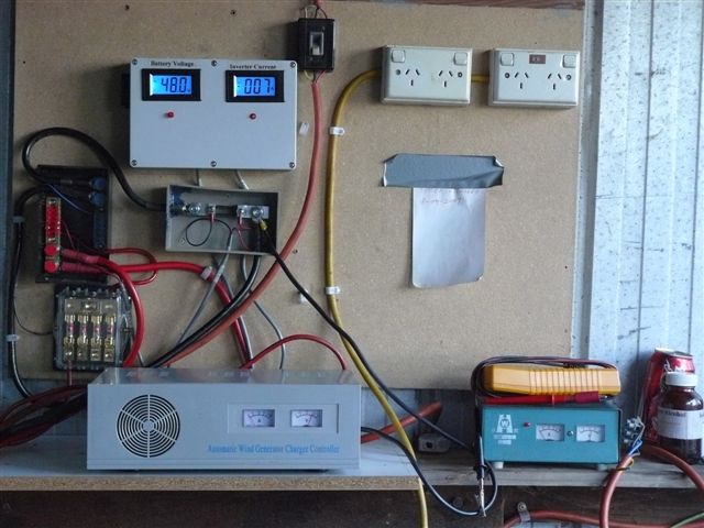

This is the controller and the battery monitor box which shows net amps in or out.
This is another shot of the controllers.
Here is a shot of the (now redundant the green box is the 24 volt one) 24 volt rectifier box with the controller for the 48 volt system, I checked the 24 volt box and found that there is no control at all from the 24 volt box.

I probably wouldn't worry about the tail being the wrong way up, unless it looks unstable. It's only there to point it to the wind.
Your brother will hate to hear this but those trees will badly effect the performance of the mills.
As you know in Vic we mainly get winds from the s/w and north/sw combination in summer, so you may have to trim the trees accordingly.

yes we have hooked up the inverter and it is working fine. My brother in law is up there at the moment, and yes I noticed that the trees affect the performance but he had the hole dug and filled in with concrete before I got there otherwise I would have suggesed a diffetent location. But that will have to wait until a later date. The inverter runs the fridge TV and the lights without any problems, were not sure about the fridge but when I checked the power consumption it was only abot 200 to 220 watts when the compressor was running. so he is very happy, but I do not know how long the batteries will last, so we are going to supplement the wind generator with a set of 200 watt 24 volt solar panels later on as they are much more expensive than the wind generator, which he got from A+ Imports in Wendouree (near Ballarat) he also has a 5 KVA diesel generator as a back up and the inverter is basically a UPS so that when the generator is running it will charge the batteries, and then when you turn of the genset the UPS takes over.
but it takes about one second for the cahnge over to take effect and the UPS to come on line so it is not a no-break system.but that does not matter in this situation. still looking for a three or four sided tower 10 to 15 meters high.
Thanks for your positve comments
