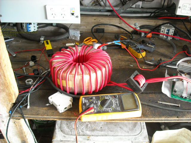

I reckon probably 110 turns for 240v secondary .... double core of your 190, 100, 70. cores@2.25v/turn.
Primary of 26v so 12 turns of 35mm or better wire depending on how much your after.
50mm will give you a serious unit indeed.
You will like the 100mm hole compared to 90mm... every mm counts, as I think Glen alluded to.
I suspect it is with some relief you don't have to face another core right now, they take it out of me I know that.
That photo of near 5kw was done with a single core. Interesting that the voltage did not sag even at those levels.
It does however, boggle the mind to even consider 15x2mm wires going through that core at the same time..... just can't see it.

Oz - for a core with 90mm inside diameter, 190mm outside diameter and 120mm in height, how many turns would I need of two in hand 2mm wire for a 240v secondary, assuming at least a 48v primary and up to 6kW load?
I can get a toroid core from a transformer factory in NZ to those specs for only $200 or so, then just wind it myself as per your articles etc, but that would still be much cheaper then freighting from Australia(cos these things are HEAVY).

112 turns, can you get the core made with a 100 mm hole?Edited by Madness 2016-06-16
Posts: 10072
Posted: 01:23am 15 Jun 2016
Probably - they roll-up the toroid however you want the core.
So I would say yes.
100mm would give more room to move in the winding, but how does that affect the outside diameter? Does that go up to 200mm for example, and keep the same 112 turns?
Madness
Joined: 08/10/2011
Posts: 2498
Posted: 01:33am 15 Jun 2016
As Oz was saying you need the big hole to get all the wires in and also it is easier to work with. If they are rolling it then they should be able to go as far as you want on the outside. The cross section area of the core is what effects the number of turns, 1 volt for every 2800 mm2. The core size you gave would be 50 (difference between inner and outer radius) * 120 = 6000 6000/2800 = 2.142 240/2.142 = 112
100 id and 200 od would give exactly the same cross sectional area so still 112 turns.

Grog, Mad is all over this now, his figures are correct... poor soul has got the bug. ... aim for 26v primary for 48v... these things have limited dynamics. The PJ can be 30v... bit less primary current.
That (2800/v/t) is a conservative number I came up with from experience with these things. It is for 50hz. There is room for movement, but I have found that that formula seems to make transformers with decent magnetising current ( 20-40 watts ) and head room..... like everything I do, it is probably not technically correct, but works well in the real world.

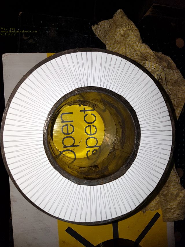

After a few days sorting out problems with ants in pumps etc due to wet weather I have made some progress with the Torroid.
When unwinding the larger of the 2 I am working with the ribbon was not one continuous length. There was a piece just about right that came out and I added to the other to get the same OD. Took some out of the centre of the other, now they match. Now they are glued together, will round of the corners and fibreglass them in the morning and start winding when that is set.
I used Rhino Cad (free trial available) to make the paper guide for winding. It has 98 points that is the number of turns I need. It will go under the last layer of Mylar before I start putting the wire on.
Edited by Madness 2016-06-18

Posted: 01:04am 17 Jun 2016
brilliant idea.... you know exactly what you will end up with... Im liking this

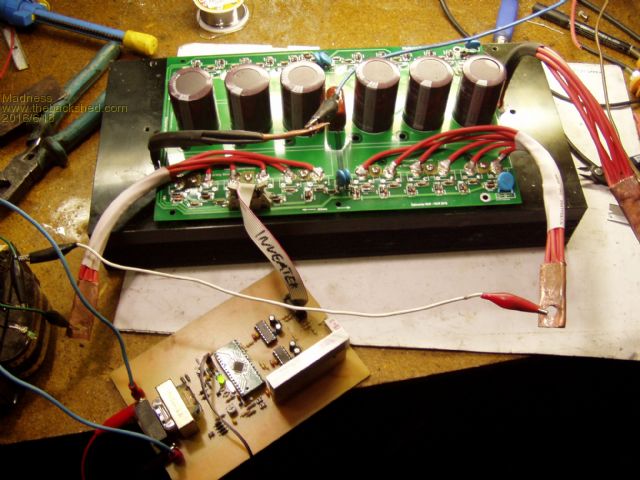

Posted: 02:22am 18 Jun 2016
Hi Oz,
I see what you have done with Clockmans Power PCB. I was thinking how to use the heat sink off the Aero Sharp, had been looking what Antman had done. But when I saw your bodge (hats off to you for finding a way to just make it work) of that board to use the heat sink light bulbs came on.
From http://www.anotherpower.com/board/index.php/topic,1116.345.html
Just started slimming down Clockmans design, I reckon I can get it down to 100 mm wide. That would allow cutting a 100*300 mm hole in the top of the Aero Sharp case between the existing heat sink screw holes. Then the heat sink and PCB would fit straight in easily.
Also looking at mounting the Torroid in the same case, if I wind the primary with flat enamelled copper strip it could mount on what is currently the bottom with about 20mm clearance to the caps on the power PCB. Possibly also turn the lot on it's side so the heat sink is vertical and let natural convection cool the heat sink, or do you think it would handle the heat load in the normal horizontal position?
Doing all this then still leaves plenty of real estate for breakers and the Sine Wave PCB etc.

Posted: 12:14pm 18 Jun 2016
Yes, if you condense that board down to 100mm or less, and use the multi wire approach, you cold use normal copper, as the wiring goes direct to the current points.
I used 4mmsq wire, but 2mmsq would be ok for the transformer points if you used 12 wires... as you would be actually point to point wiring, the copper would only be used to connect the caps.
The fets are only clamped to the heat sink. with three screws/bank... very quick to on/off if necessary.
I may try to tidy this up a bit more.
It is currently mounted on an inspire heat sink, as is is wider than the aero, but the aero on it's side would make a very good unit. It would allow 120mm fans much easier as well, and a decent vertical heat path inside for the torroid.
For a 4kw unit, with a single core would do fine, and leave plenty of room for playing.
Clockmans board is very solid, but a slimmer one would suit the aero sinks, and normal thickness copper.
You will see where I was going to use three points for the transformer points, but went for using 6 of the solder points Clock provided...and used the copper on the board for the opposite fets, but direct wire would work every bit as well I think.
Will fiddle a bit with the next one, and watch you closely too.
