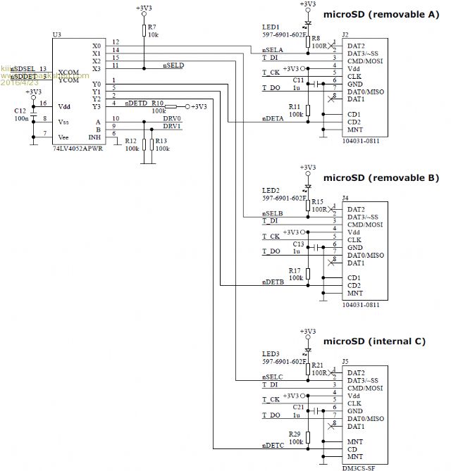

Posted: 09:02pm 22 Apr 2016
Hi Mick, this is somewhat similar concept to what I am using. It is possible for me to modify the MMbasic so it can support more devices. I am reluctant to do that though, because once out of the mainstream development, I would need to do that with every next revision which Geoff releases, and speaking in more general terms, I would much rather stay on the hardware side.
http://rittle.org

Posted: 09:37pm 22 Apr 2016
That looks like a pretty good solution Kon. Where is the problem? Do you want to support more than four SD cards?

kiiid
Joined: 11/05/2013
Posts: 671
Posted: 09:55pm 22 Apr 2016
Hi Geoff,
I don't think anyone ever would need more than four devices. In another device which is also built around the MM, I am using two cards, each one of them selected by its own CS. Obviously one of them is currently not usable because OPTION SDCARD can specify one pin and from that point it is driven automatically.
This part here with the multiplexer is an extract from the schematic of my ELLO 2M computer (which I am planning to release public pretty soon, once I announce it officially). Of course I can drive 'manually' the DRVx pins to select the needed device, but the reasons why I am still not doing that I explained in my previous post.
PS. There is another little function which I think MM is currently missing and I only discovered that yesterday when I actually needed it - the equivalent of ~ in C. Maybe something like NEG()?Edited by kiiid 2016-04-24

Posted: 10:14pm 22 Apr 2016
  kiiid said  Of course I can drive 'manually' the DRVx pins to select the needed device, but the reasons why I am still not doing that I explained in my previous post.
Ah, that would be the perfect application for a small BASIC sub placed in the library.
Something like this:
Sub SDCARDn as Integer
Port(pin, 2) = n
End Sub
You would then have your own command (SDCARD) without hacking the source.
Geoff

Posts: 11889
Posted: 12:06am 23 Apr 2016
Konstantin, Geoff
I may be missing something but I don't understand how multiple SDcards can work sensibly. The cards need initialising into SPI mode on insertion but the MM firmware controls this and makes assumptions about the initialisation status and AFAIK doesn't ever initialise when a file is already open. What it does at other times depends on whether card-detect is implemented in the OPTION command.
I have made a tentative start at replacing the Microchip SDcard routines with FatFS which has proper Multiple volumes (physical drives and partitions) and long file names. I've got the FILES command working and therefore most of the underlying basics but it probably needs a couple of weeks on concentrated effort to do a complete replacement (well worth while IMHO). The biggest issue is integrating in with the SDcard error handling in the MM firmware which seems to be spread amongst a number of modules - Geoff: you know this part of the code so much better than me it would take you a fraction of the time.
Thoughts?
