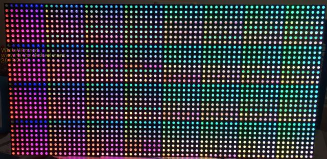

A better picture showing 4 blocks of all 512 colours.
Still not full justice to what I am seeing on the actual panel. There is much more distinction between the colours than you see in the above photo; especially the Blues and Greens towards the top right corner.
For anyone wanting to try this out, here is the code:

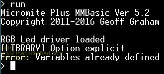

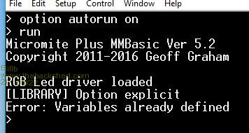

Hi Peter
Just loaded your RGB Driver into my explorer 64 and connected to a 32 * 64 display.
All worked OK.
My problem is I wand the program to auto run at power up.
inserted option autorun ON in the program, This does not work.
Removed and typed option autorun on at the command prompt then ran program,
repowered and the program did not auto run.
typed run at the command prompt - worked OK.
The following is the error message received on both occasion.
hope you or any one can help.
Regards Bill

The driver should be loaded into the library as-is with nothing else (or with additional subroutines that only use local variables). The main program should be in normal memory. Include autorun on at the top of the main program. Restart, should be no errors. Then run the main program by hand once. After that it should autorun on restart. If this doesn't work you are going to need to provide program listings of the main program and whatever you have in the library in order to help further.

Posted: 11:13am 22 Aug 2016
Hi Peter
Thanks for the reply.
The only program in library is the RGB driver.
to ensure, I reloaded ver 5.2 and saved the rgb driver to the library.
The program I used to test is your demo with the autorun added.
The results are the same as before.

Posts: 12206
Posted: 09:33pm 22 Aug 2016
Bill
I can replicate the issue exactly as you report. I've reported this to Geoff as I can't make any sense of the problem. I don't think you are doing anything wrong or abnormal in any way.
UPDATE
If you change mm.startup from
sub MM.startup
const OE=21
const CLK=51
const LAT=52
RGBled64(LAT, CLK, OE)
font 8
end sub
to
sub MM.startup
RGBled64(52, 51, 21)
font 8
end sub
I think the problem goes away. Please substitute your pin numbers and let me know
Definitely one for Geoff!!!!!

Posted: 11:41pm 22 Aug 2016
Hi Peter
Applied the change you suggested.
Now it is working OK.
Thank you

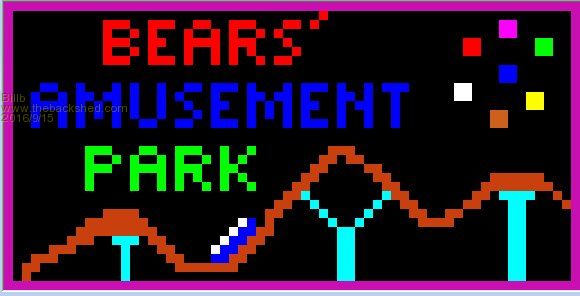

This is the sign I will be using on my Christmas
display
[https://www.youtube.com/watch?v=R7Cnje00-UI
BillEdited by Bill.b 2016-09-15
Posts: 2998
Posted: 09:08pm 14 Sep 2016
Thats really great
I love the flag!
This is NOT a criticism, but an idea for a slight improvement. On the page that says 'Pls Support....', would it not look better with a bit of scrolling text with the words spelt out in full?
Sometimes scrolling text can be difficult to read, but with the right size font, and the correct scroll speed it can look good.
You MUST post a video when you have all this set up (assuming it is all part of your previous fairground 'display')! If you were in the UK then that would be very 'soon' as people start 'early' here. When do you intend having the 'display' finished?
Once again - great stuff Bill

Posts: 249
Posted: 02:03am 15 Sep 2016
Update on Christmas Display
https://www.youtube.com/watch?v=N3lKY25FIpA
Edit: Just noticed the error on the display with the Ferris Wheel
on one section losing the S
  Quote  You MUST post a video when you have all this set up (assuming it is all part of your previous fairground 'display')! If you were in the UK then that would be very 'soon' as people start 'early' here. When do you intend having the 'display' finished?
I start at the beginning of November for a 1st of December light up.
Yes, this will be above the entry gate to the amusement park section of my display.
