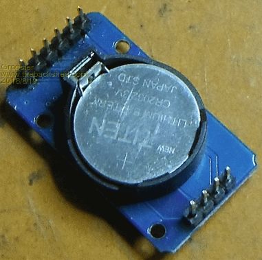

a word of caution - thre are at least two different type of rechargable lithium button cells out there:
1. a 3v lithium cell similar to a CR2032, but designed to be trickle charged continuously at an extremely low current, in the region of a few hundred microamps. one such example is this one:
http://www.produktinfo.conrad.com/datenblaetter/250000-274999/252238-da-01-en-KNOPFZELLENAKKU_3V_CR2032.pdf
in fact, a normal CR2032 cell can be trickle charged very slowly, i recall currents around 10uA are considered safe.
2. a 3.6v lithium ion cell, supporting relatively high charge currents but requiring the same sort of charge regulation as any other lithium ion cell. constant-cirrent, constant-voltage, with a charging timeout and possibly temperature monitoring.
i've just had a look at one of the RTC modules i have here, and it has a 200 ohm resistor in series with a diode. assuming a Vcc of 5v, that would produce a charging current of (5.0 - 3.6 - 0.6)/200 = 4mA or thereabouts, delivered continuously.
this would be ill-advised for either of the above cell technologies. there will be no fire, unlikely to be a pop, but nonetheless not a long cell life. given the miniscule current draw of an RTC, i would advise (after removing the resistor and diode) to stick with a normal CR2032 cell that you replace every 10-15 years.
rob :-)

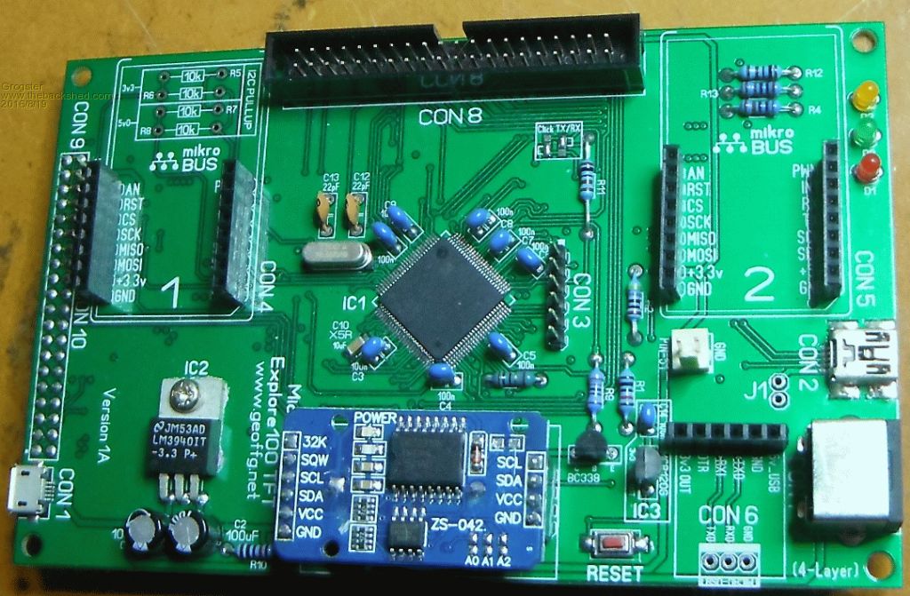

@Grogs
Don't sweat it. I've been married for 32 years It got me out of the house.
I scraped between each pin as far as I could behind the pins (past the pin lands). I couldn't see any bridge either. I like fault finding anyway.
Nice little design. I thought $ 75-00 dollars was good value regardless.
To save some 'legwork' do you have any 'Option' strings we can 'copy and paste', at the command prompt, when setting up the screen and touchpanel ? Also, I believe the
'Read Pin' is connected to pin 6 of the PIC32. Correct ?
Thanks very much for your efforts. I'm sure we all appreciate it.
@robert.rozee
I'm with you. Can't see the point of having a rechargeable battery considering a standard lithium cell will last its 'shelf life'.Edited by mikeb 2016-08-18
Posts: 10043
Posted: 09:38pm 16 Aug 2016
Hi - thanks for your understanding. I was SURE I did not send any out with bridges, Hopefully yours is the only one.....
No "Option strings" to paste at the command prompt, but if others thought this would be useful, I could certainly make a post along those lines - or start another thread with it in it, so you could save. Generally speaking, it is left up to the user to decide what they want to configure and how.
As to pin6, RD - yes - correct:
The pink line is the highlighter tool for testing connections. RD is also pulled-up to 3v3 via R10.

Phil23
Joined: 27/03/2016
Posts: 1667
Posted: 12:00am 18 Aug 2016
  mikeb said
@robert.rozee
100%.
Even Eneloops, which are the better of the NiMh rechargeable, are less likely to perform in long term low current applications.
Great when you want them to have their long shelf charge & good performance in service.
But for low drain situations like say a TV remote, just normal Alkaline perform much better.
Think I put LIR2032's Vs CR2032's in the same basket.
3 times the cost & probably bound to fail prematurely if not correctly maintained.
Cheers.

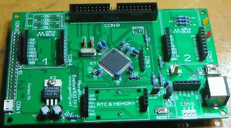

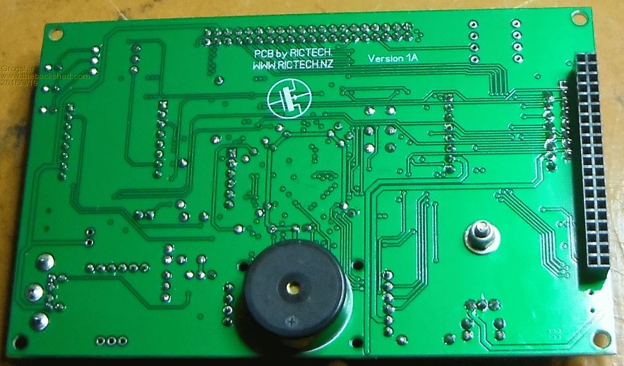

Posted: 10:39pm 18 Aug 2016
Well it Boots up!
Con9; LCD.
Wondering what most are doing with it?
On the top or the bottom of the board.
Blindly put my first on top (5pm after the 3am start).
Then realised if it was on the bottom it could be more of a backpack configuration when used with a 5" screen.
Curious what others think.
Other thing I wondered is; Anything unique about pin 51, the way it's on it's own with a ground.
(Has that Area 51 intrigue).
Cheers.
Phil.
PS.
Compliments to all involved in it's design.
Nice board.
Edited by Phil23 2016-08-20
Posts: 10043
Posted: 10:44pm 18 Aug 2016
LOL! - I love your Area-51 reference, Mulder.
Pin-51 is input-only, and was spare, so it was routed out to that header along with a ground pin, just so you can use Pin-51 if you want to. Better to route it out then leave it buried in the 0.5mm pin-pitch, then people can at least use it if they want to.
CON9 - Female header is meant to mount on the same side as the Piezo, so that you can plug an LCD directly on to the back of it. That is how it was designed to stack anyway. You COULD put a box-header on the top side, and use a ribbon-cable to link to the LCD if you prefer.
Phil23
Joined: 27/03/2016
Posts: 1667
Posted: 10:53pm 18 Aug 2016
Hmmmm,
Wondered the when I finished welding....
Con 9;
Don't fancy my chances of removing it.
Should work though if I hang the LCD off the left side though.
Did look twice & figured the box was drawn on top,
but the 3am start was setting in pretty well by then.
The 3am start is for I'm for sure what?
Brain overload I think; "What is it I need to do today"?
Phil.

Posts: 10043
Posted: 11:20pm 18 Aug 2016
You're right - the box around CON9 on the top is a little confusing. I will remove that in any future version of the board, and make sure that is on the other side.

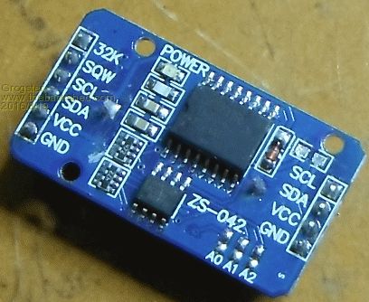

Female headers on the RTC, and you remove the right-angled pin-strips on the eBay-type RTC module, and replace them with straight pins, and then the RTC can plug directly into the board.

for the misplaced connector, use a pair of snipe-nosed pliers to grab the pins one at a time, heat pin and pull out. the connector will be somewhat destroyed, but the PCB will be unharmed. then use solderwick to empty out the holes, or just heat and tap GENTLY on the edge of your bench (my preferred method).
edit: i was looking at the connector on the top edge of the board. i would still favour destroying the RHS connector (though this will be a bit harder) so that the pins can be removed one-by-one.
unless the piezo is active (ie, a fixed frequency device containing a transistor oscillator and driven by DC), it will be unpolarized. the housings often have a polarity mark simply because it is cheaper for the manufacturer to make just the one type of housing and use it for both active and passive devices.
the 4 pins on one end of the RTC module are passthroughs from the 4 similarly marked pins at the 6-pin end. grogster: might i suggest removing the text markings from the 4-pin end on the next revision of the board, as these pins are just being used for mechanical support?
