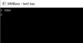

I found this, >new command don't erase the last filename in consol-window?
Peter
Posts: 3368
Posted: 02:07pm 19 Aug 2017
If I understand correctly, is this the same as flip's comment 8 posts back?

1. Peter hasn't responded but I think he means the title-bar of the Console Window...maybe if it could either remove the filename or display something like MMBasic - Untitled
