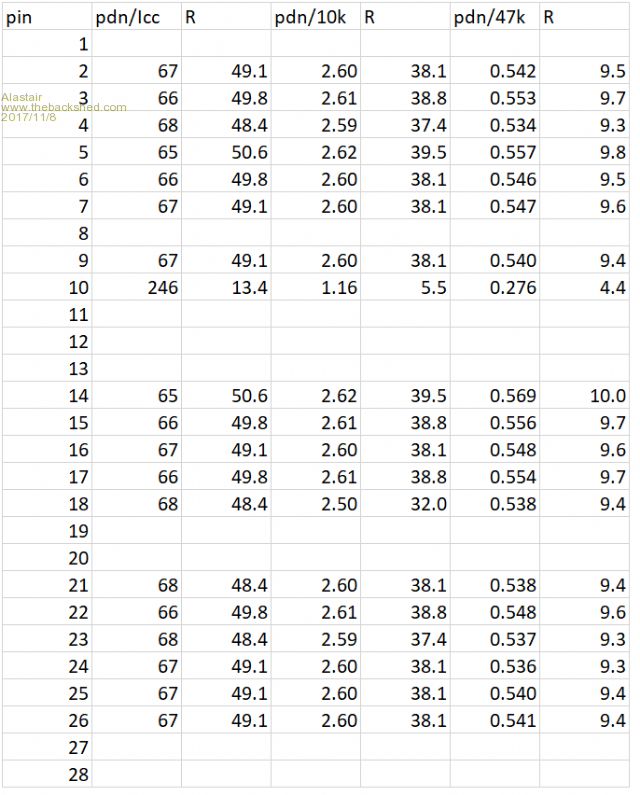

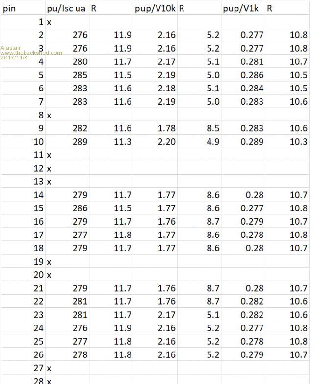

Alastair
Joined: 03/04/2017
Posts: 161
Posted: 06:09pm 07 Nov 2017
Redrok,
Your wish is my command.
Once I started I decided that since I was doing it I might as well do it properly because I thought exactly what you said. I used one of Grogster's E28 boards.
Voltages measured with a 10M input voltmeter. Resistance values in K
So the following table is Column C is Isc the short circuit current in ua for each pin with the pins set as DIN, PULLUP. The OC voltage was 3.27 so col D is the calculate pull resistance. Col E is the voltage across a 10K resistor, pin to Gnd and col F is the calculated resistance. Col G and H is the same thing for a 1K resistor.
C D E F G H
The table shows a fairly constant Pup res on the basis of the SC current of about 12K. The variation I would assume to be due to the location on the die. Pin 9 is an outlier probably due to the chip structure.The results using the the voltage divider results shows similar variation but quite different values which are almost certainly due to the mosfet load.
The following table is Column K is Isc the short circuit current in ua for each pin to Vcc with the pins set as DIN, PULLDOWN. The OC voltage was 3.29 so col L is the calculate pull resistance. Col M is the voltage across a 10K resistor, pin to Vcc and col N is the calculated resistance. Col O and P is the same thing for a 47K resistor.
K L M N O P
The results for the Pdn case show a similar pattern but this time the resistance determined by the current approach is much higher. The voltage divider approach shows how the effective resistance changes greatly due to load. This time the outlier is pin 10. I did think of testing another E28 to see if things were different but have better things to do.
To me it says don't use the internal resistors but use external ones if it really matters.
I now have to edit a pcb layout and have the boards remade. Grrrrrrrr
PS
sorry the column headers got squashed by the white space cruncher.
Edited by Alastair 2017-11-09
Cheers, Alastair

Alastair
Joined: 03/04/2017
Posts: 161
Posted: 10:52am 08 Nov 2017
@Redrok,
Your numbers are consistent with mine.
Lot of fiddling but it was worth it as a one off. I won't use the internal resistors except for just stopping floating DIN pins when connected to other logic pins. I have used them in the past like this and not had problems. I was under the impression from the wording of the specs that the resistors were of a more stable value and just varied chip to chip.
@Grogster
The last table shows what you had - a pull down resistance of about 50K, not enough whetting current for the ball switch I presume.

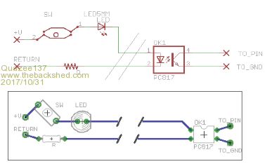

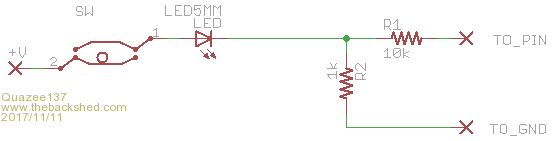

Quazee137
Joined: 07/08/2016
Posts: 603
Posted: 04:40pm 10 Nov 2017
Just give this a try. led is optional.
No real current flows till switch is active.
