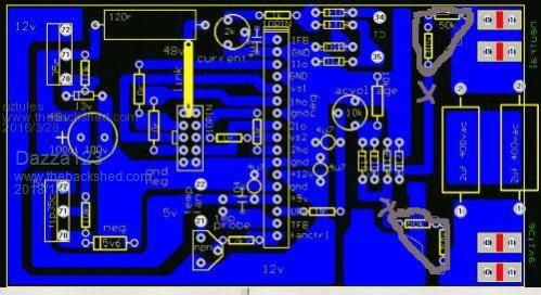

Dazza, remember that this unit is for isolated off grid. If you hook it to the house, and there is any chance of even high impedance battery to ground somewhere, it will drop from 240v to about 120v.
To get around this you need an isolated supply to show the VFB a feedback voltage.... even a 12v tranny may work direct into the diode bridge.... you may have to twiddle it a bit then.
It will work just fine then.
It will work as is for an isolated installation ( only active and neutral output... no connecting neutral to ground until you put in a tranny to isolate.
.........oztules

Dazza, read this link http://www.anotherpower.com/board/index.php?topic=1116.300
It will explain what I am talking about re isolation transformer.
Ask if still not sure.

Posted: 09:16am 09 Jan 2018
Thanks for the help guys.
Thanks for the board Madness.
Oztules looking at that link you gave that is for the next version of your board and from what I worked out
the resistors circled are what needs to be removed?
The cross is where the transformer low voltage winding now connect and the 240v wingdings go where the large cap is?
Is there any way to fire this board up without a H bridge?
assuming I only want to run between 1.5kw and 2kw with peaks upto 3kw when inductive motors start such as a evap aircon what FETs and how many would be suitable?
in you orignal tests you used a single fet in each leg with a smallish load. I dont remember seeing a circuit for this?
sorry for all the questions that you have most likely responded to multiple times already, The info is spread out in so many threads and piecing it together is not easy.

I did not realize you were wanting to build a full inverter.
I have boards that take 12 HY4008's but you could reduce that to 8. Your mods above are correct and the 12 fet board will work with the control board however why not just use the latest version of the control board?
